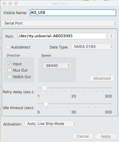

I have been using a USB connection to an AIS receiver for the application POLARVIEW NS for many years under MacOS. Below is a screen shot of the port configuration:
In order to make a connection to an AIS USB port, you first have to discover the device name. To find the device name of your AIS USB port, use a terminal window. Enter the command
ls /dev/cu*
--or--
ls /dev/tty*
This will list all devices. To see the data from a serial connection to the AIS device, enter the command
screen /dev/cu.yourDeviceNameHere 38400
