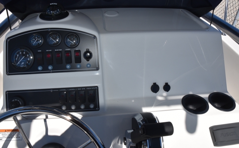

Don't let the present location of the USB and Aux connectors affect your layout. To keep the motif consistent, consider putting a black aluminum panel in place on the empty dashboard area. This will cover the holes from the removal of the USB and AUX connectors. Then you are free to layout everything as you want.
About the only items set in stone are those drink holders. Consider how you would operate the controls of any device mounted behind the drink holders when there are tall drinks in them. Their presence in front of the helm dashboard tends to make that lower right area not very useful for any device that you might want to reach for the controls.
Also, I would make a wooden fid and install it on the dashboard from the center area near the electrical panel to starboard to the drink holders, creating a little space on the dashboard where you can lay down stuff, like sunglasses, your cellular telephone, a little camera, and so on. Or make it from black KING StarBoard if you want to keep the motif consistent

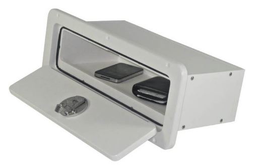

As you noted about creating an area for small items, one thing I also plan to do is to install a glove box into the console equal in size and centered above the fire extinguisher. Teak Island fabricates custom, very high quality, marine glove boxes out of King Starboard that should complement the Montauk.

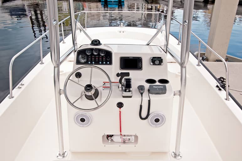

As you can see in this BW stock console picture the separate safety lanyard and the Mercury ignition key (above the steering wheel). The area under the Mercury safety lanyard and above the fire extinguisher is where I will install the glove box.

Comparing the stock photo of the helm to RIDGE's photo, I notice that RIDGE's boat has an extra electrical switch panel on the dash behind the steering wheel. Where did all that extra electrical power distribution and control come from?
The location of the VHF Marine Band radio in the stock photo is good. It is away from the compass, which might be affected by the loudspeaker magnet. The microphone is handy. The speaker in the radio is oriented upwards which should give good projection of sound to the helmsman.
The loudspeakers for the entertainment device are not in a good position. I think music reproduction in stereo would be better if the speakers were mounted on the outboard faces of the console, aimed at the boat hull's bulwarks, so the sound would reflect off the walls and return to the helmsman. With that path there would be a chance you'd hear some high frequencies from the speakers. As shown, the speakers are aimed at the helmsman's knees, and the helmsman's ears would be far off-axis of the high frequency driver in the speaker. I bet they sound rather tubby.

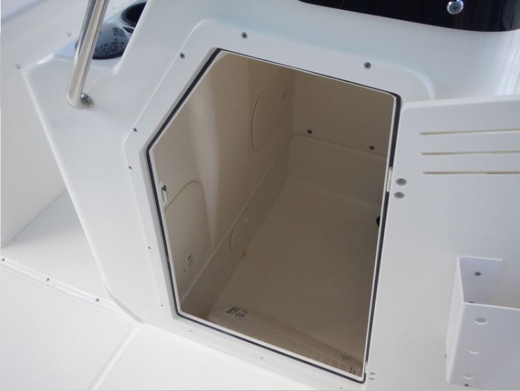

I have not had a chance to do a detailed look at the power distribution on this boat yet - just a quick look around (the dealer I purchased the boat from is about 90 minutes from my house). This boat is set-up with two batteries, one under each stern seat and on the port side is the battery selector switch also under the seat with a power distribution block. I was contemplating moving the batteries into the center console but the factory wiring is very neat and tight I fear that a lot of work would be involved in rewiring the boat to accomplish that task.
An interesting note - if you order this boat with the factory trolling motor wiring you can get four batteries, two in the stern as mine is designed and two more in the center console for the trolling motors.
Also of interest the center console is completely finished inside - it does not have an open back - the interior of console is completely clean. BW provides access hatches to perform the wiring and rear access to the electronics and gauges. I believe this is why the speakers are mounted they way the are, if they were mounted on the outside console faces the backside of the speakers would be open air:
Console Inside.JPG (34.65 KiB) Viewed 19838 times

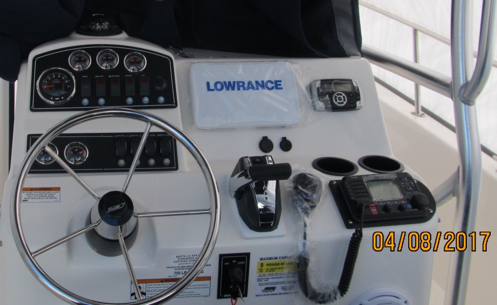

Postby Ridge Runner » Sun Apr 09, 2017 6:15 pm
I would have preferred the dealer use black starboard under the new Evinrude controls, so I might change that out at a later date. Notice the six Evinrude gauges compared the original Mercury gauge lay-out in the picture I posted above.
Here is the finished console:

RIDGE'--very nice work on the helm dashboard. I am still looking for the seventh gauge. I only see six.
Re the mounting escutcheon plate under the Evinrude EST controls: I believe that Evinrude offers that component in two colors, white or off-white. I presume you have the white model. The off-while might be a better match to the Boston Whaler gelcoat. A black escutcheon would look good, too, but you may have to make your own.

Thank you - Jim, my mistake there are only six gauges. A tachometer, water pressure, water temperature, voltage, oil level and fuel level gauge. The escutcheon plate under the Evinrude EST controls was only available white at the time of rigging. At some point in the future I will probably manufacture a black one similar to the mounting plate under the ICOM VHF radio. Having a digital control binnacle it should be fairly easy to disconnect and un-mount the binnacle.

RIDGE--Ah, now I see the black escutcheon plate by the radio. Another one under the EST controls will look good and provide more consistency.
And, yes, the beauty of digital-based electronic shift and throttle controls is they can be easily removed by a few electrical connectors being un-mated.
