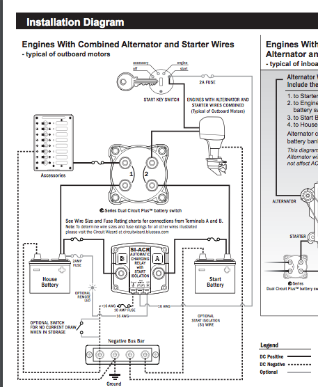

Adding a House Battery:
I would like to move my current dual purpose battery to the console and add a deep cycle AGM battery. Perhaps I should replace the current dual purpose battery with an AGM starting battery, but I will look into that at a later date.
I currently have a BLUE SEA SYSTEMS ST Blade Fuse Box with Negative Bus. Electrical power is provided to this box via the dual purpose battery.
To add a battery, battery switch, and automatic charging relay (ACR) I would like to use the BLUE SEAS Add-a-battery kit 120A.
I observed in this recent thread that Divin'Ivan installed this kit. Perhaps he has some insights and/or tips to share about the installation.
The instructions that BLUE SEA SYSTEMS provides (placed inline below) shows the negative connection to a negative bus bar. Am I correct in assuming that I should use this negative bus bar in addition to the negative bus bar located in the BLUE SEA SYSTEMS ST Blade Fuse Box? If so, could someone provide a short explanation as to why?
The instructions also show a positive lead from the starting battery to the battery switch, and then from the battery switch to the engine. There is an additional positive lead that is shown running from the engine to the key start switch. May I assume that my boat's current setup has a positive lead going from the engine to the key start switch via the bundle of wires and cables that currently connect the engine to the remote control box? If so, would there be a reason to modify this specific connection?
The instructions also indicate that one could add an optional switch from the negative bus bar to the ACR to prevent current draw when in storage. If one were to want to install a switch for this purpose, what type of switch should one use?
The instructions indicate that one should connect the ACR directly to the battery positive terminals using appropriately sized fuses. The chart on the instructions correlates fuse size to charging amps. I am unsure where I can find the charging amps for the batteries that I will use. I do see the maximum charging voltage for the AGM battery that I want to purchase, but I do not see maximum charging amps. Where can I find this information?

Re: Adding a House Battery
I will reply to the many questions with individual posts. Please note the vendor's name is not BLUE SEAS but rather is BLUE SEA SYSTEMS.
Yes. You should NOT use the fuse panel negative as the main negative bus. It is not sufficiently sized. I explain further below
In the power distribution system you propose, there will be two tiers of electrical power, the PRIMARY and SECONDARY electrical power distribution systems.
The PRIMARY power system involves the power at the source of the power, in this case from the battery or two batteries, the switch, and the primary load (the engine). The NEGATIVE BUS of the primary power must be capable of handling the total negative current, which will be a very high current because the engine starter motor will be drawing over 100-Amperes of current during engine starting. This primary negative bus should be large enough to handle that sort of current.
In small boats, however, it is often seen that the primary negative bus is omitted, and, in its place, the terminal post of the battery or batteries is used. (In fact, that is how my boat is wired.) Although as a general practice it is BEST if there is only one ring terminal connector on a terminal post, even the American Boat and Yacht Council (ABYC) seems to permit more than one ring terminal on a post. In that manner, the terminal post or posts of the battery or batteries can serve as the primary power negative bus, so long as you don't stack more than three or four (at the very most) ring terminals on those posts. Below is a sketch of my boat's primary power distribution, and you can see that the HOUSE battery has three connections at the negative post and the ENGINE CRANKING battery has four at its negative post:
One of the connections to the battery negative is a 8-AWG conductor that feeds the battery negative circuit to the negative bus of the SECONDARY power distribution panel, which is also a product of Blue Sea Systems and has its own negative bus to which all the loads being powered by that panel have their negative circuits connected.
In my sketch the bus marked "Aft negative bus" is for connection of secondary loads that are nearby in the transom area, such as the negative circuits of:
--one of the navigation lamps,
--a sump pump
--a panel lamp associated with the control of that sump pump
--an isolated negative circuit associated with the engine trim gauge
--the negative circuit fed from the primary bus
--the negative circuit fed to the secondary panel
--and something I cannot remember right now :-)
Yes, that circuit is part of your engine wiring harness.
There is no need to modify that circuit. It is just shown in the schematic for clarity because of the involvement of the ignition key switch in the STARTING ISOLATION circuit.
That is an interesting comment about the quiescent current draw of the ACR device. I don't recall that being noted in prior versions of this drawing.
It will be a VERY GOOD idea to install a switch or some means of shutting off the quiescent current drain of the ACR when the boat is not in use, as otherwise there will be a drain on the battery or batteries. The switch can be any sort of switch, perhaps a toggle switch being the easiest to find. I would be guided by where the switch can most easily be mounted. I would avoid mounting it on the helm panel, and would prefer it close to the battery end of the circuit. I have two ideas:
--mount the toggle switch on the cover of the battery box, or
--don't use a switch at all, just pull out the fuse; use a fuse holder that accepts blade fuses and can be easily located.
The charging current Amperes will be determined by the outboard engine's charging circuit. Typically about 30-Ampere will be the maximum. If you have some really hefty AGM battery and an outboard that can supply 50-Amperes, perhaps use 50-Amperes.

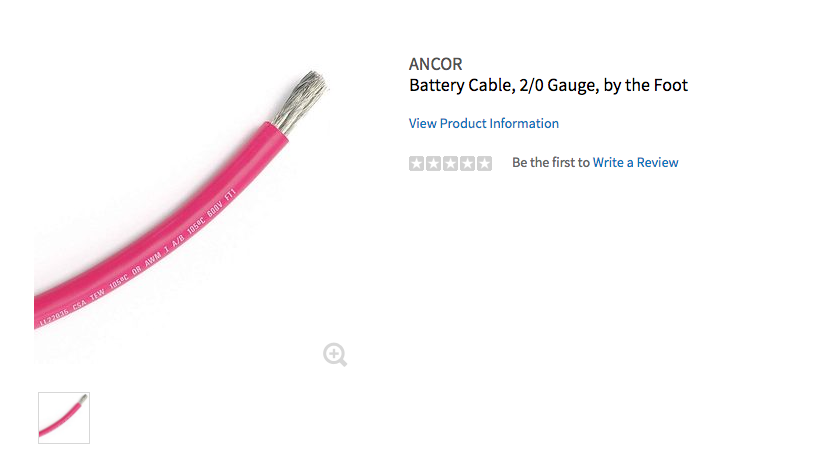

I will need to replace the wires running from the starting battery to the battery switch, and from the battery switch to the engine. I have read enough on this site to know that I need to select and use a wire gauge large enough to provide the necessary amps to start the engine and that resistance increases with the length of a wire. I am nearly 7,000 miles from my boat, so I am not able to measure the run of wire that will be required for this application. I can, however, complete this measurement when I return home in 62 days (who's counting!) My SUZUKI DF70 requires 512 cold crank amps. If my run of wire is 12' or less, can I use 4-AWG for this connection? Do I need to provide additional information for this calculation to be completed? Would any classic Montauk 17 owners know the length of wire that is required to complete this connection?
I think you are confusing the recommendation of Suzuki for the Marine Cranking Ampere (MCA) or perhaps the Cold Cranking Amperes (CCA) rating for the BATTERY that should be used to start the DF70. It is unlikely that the DF70 will draw 512-Amperes of sustained current during engine starting. It may draw about 500-Amperes for a very small portion of a second when the starter motor is stalled at has not yet begun to turn, but not for long.
I suspect that on a MONTAUK 17 with the battery moved to the console, the distance between the battery switch and the engine is about 12-feet. Let's proceed on that basis. I will refer to my own article on power distribution at
http://continuouswave.com/whaler/reference/powerConductorSize.html#UsefulTable
in which I introduce the concept of pre-computed values of "Ampere-feet" (a term I have also invented) for power distribution at 12-Volts and three-percent voltage drop. From the table for 12-Volts (the most conservative approach) I find values for 4-AWG as follows:
4-AWG = 724.3 Ampere-feet
To apply this to our situation in the Montauk, we divide Ampere-feet by feet to get Amperes:
734.3-Ampere-feet / 12-feet = 60-Amperes
By the way, to be clear, the "12" feet is for the end to end length of a two way circuit, not the total wire length. So in this case there will be 24-feet of wire to make an end-to-end two-conductor circuit of 12-foot length.
Well, 60-Amperes does not seem like very much. But that is for only a three-percent voltage drop. We can be more generous and allow ten-percent voltage drop. This means we can scale-up the Ampere-feet by a factor of 10/3 or 3.3. Now we would have
4-AWG = 734.3 x 3.3 = 2,390-Ampere-feet
2,390-Ampere-feet / 12-feet = 200-Amperes
This tells us that if the starter motor is drawing 200-Amperes and is wired with 4-AWG for 12-feet end-to-end between battery positive and starter motor, we will deliver the 12-Volts with a ten-percent voltage drop, or 10.8-Volts at the starter motor.
Will that be good enough to start the engine? Yes, if the battery was close to full charge, its terminal voltage would be about 12.8-Volts, so you'd have about 11.6-Volts at the starter motor.
The real decision is with regard to how much margin you want to have to start the engine when the battery is somewhat discharged. If the battery is already down to 12.00-Volts and you lose ten-percent in the wiring, you may be approaching the limits. Also, we don't know how much the battery itself will sag in voltage under a 200-Ampere load. It is not going to stay perfectly at its open circuit terminal voltage. The nice feature of two batteries aboard is you can parallel them for engine start if needed, and that will give you more margin.
Another good basis for choosing wire for engine primary cables is to consult the engine maker. For example, Evinrude recommends using these wire sizes and these distances:
FEET 15–30 HP 40–300 HP
1 to 10 6-AWG 4-AWG
11 to 15 4-AWG 2-AWG
16 to 20 2-AWG 1-AWG
Going by their recommendation, you probably would use 2-AWG in preference to 4-AWG.
Also note that if you try to EXTEND the existing cables, you will have to use a very large wire size for the extension because the total resistance of the wire is what makes the voltage drop. The added section must be very much lower than the existing section in order that the total resistance is not excessive. There is not a quick way to calculate this; you have to look up the resistance per foot for each wire size and length of that wire in the total combined cable.
jimh wrote:Although I don't think you asked about STARTING ISOLATION, I recommend you install that feature. It will keep your boat electronics from rebooting during engine start if the engine start battery voltage sags. If I had an ACR with that feature, I would make use of it.
I did not ask about start isolation, but I will do so. The wiring schematic provided by BLUE SEA SYSTEMS indicates that one needs to install a run of 18-AWG from the ACR to the start key switch and install a 2-Ampere fuse in-line.
[Nota Bene: I recommend using 16-AWG for the conductor. In general wiring on a boat, 16-AWG is about as small as you want to go for mechanical reasons.--jimh]

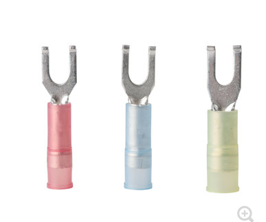

I did buy ring terminal connectors. See: "4 pkg - 8-AWG Terminals, Red, 3/8" Hole Dia., 3 Qty/Pk"
The spade connectors are listed below for your reference. I purchased them to connect the toggle switch to the ACR.
- Screen Shot 2017-05-02 at 8.08.24 PM.png (59.36 KiB) Viewed 21745 times
The terminals you show are called fork terminals. Generally they are not recommended for wiring on boats. I believe the concern is for vibration, which might cause the retaining screw to become loose, and the fork terminal could fall off. At least with a ring terminal the connection is captivated by the retaining screw, even when a bit loose. Fork terminals might be used with some terminal strips where the screw fasteners have their threads jammed at the end so the screw is very difficult to remove from the terminal (said to be captivated in the terminal). The American Boat and Yacht Council (ABYC) recommendations might have something to say about use of fork terminal versus ring terminals. If I find something, I will post it.
Also, ring terminal will stack up on a single terminal post much better than fork terminals.

jimh wrote:For the large battery cable, did you buy 2-AWG or 00-AWG (which is sometimes called "two aught")?
I purchased 2-AWG:
ANCOR
Battery Cable, 2/0 Gauge, by the Foot
Regarding your comment about the fork terminals, noted with thanks.
- Screen Shot 2017-05-02 at 8.17.18 PM.png (95.06 KiB) Viewed 21741 times
1989 MONTAUK 17
Beerspitnight wrote:I purchased 2-AWG:
ANCOR
You bought 00-AWG cable, which is significantly larger than 2-AWG. ANCOR uses an odd notation, "2/0" which is a representation of "two aught", for 00-AWG. Compare with their notation for 2-AWG battery cable at
http://www.ancorproducts.com/en/product ... tery-cable
Ok, well, I wonder if that cable will fit through the engine cowling?

Re terminals, the ABYC standard is for use of a ring terminal or a captive fork terminal. The "captive" part of a fork terminal means the ends of the forks are bent upward slightly to better retain the terminal on the screw fastener. The image you posted (above) shows fork terminals with the ends of the fork bent up, so they are captive fork terminals--all the better.
There are also fork terminals that snap over the terminal post, like the ones shown in this image:
