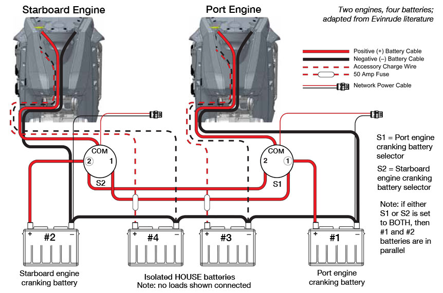

For larger boats with twin engines and substantial house loads, rigging with four batteries could be a reasonable approach to providing electrical power. A typical arrangement is shown in a pictorial diagram below:
Fig. 1: Suggested wiring for twin engines and four batteries
The drawing above is adapted from a drawing provided by Evinrude. The wiring is as shown in the original, but I have changed the nomenclature and callouts to reflect what I believe is better clarity. Each engine has its own dedicated cranking battery and battery selector switch. Switch S1 is associated with the Port engine; switch S2 is associated with the Starboard engine.
In normal operation, S1 is set to 1, and battery #1 cranks the Port engine. S2 is set to 2, and battery #2 cranks the Starboard engine. If either S1 or S2 is set to BOTH, then battery #1 and #2 are in parallel, and both engines will be cranking from the parallel combination of #1 and #2 batteries. If either S1 or S2 is set to BOTH, then both S1 and S2 should be set to BOTH to get the best configuration for parallel operation of battery #1 and #2.
In routine and normal operation there would be NO reason to set either S1 or S2 to the BOTH position. Each engine, Port or Starboard, should be easily started by its associated cranking batter alone (#1 for Port, and #2 for Starboard). The ONLY time that S1 and S2 would be set to BOTH might occur if the state of charge in battery #1 and #2 was so low that neither of them alone could crank over one engine. This situation should seldom or never occur, as the only load on battery #1 and battery #2 should be their associated engine, and both batteries should be easily maintained at full-charge by the charging current from their respective engines.
The two HOUSE batteries, #3 and #4, and not used in engine cranking and are isolated from the engine loads, but they are re-charged by the engines by the auxiliary charging outputs. As shown above, the Port engine will be charging #3 and the Starboard engine will be charging #4. The provision of the E-TEC engines to have auxiliary charging outputs greatly simplifies the charging of the house batteries. Without those auxiliary outputs, providing charging to the house batteries will become extremely complicated.
In the diagram above there are no loads shown attached to the HOUSE batteries. The house loads should be connected to the #3 battery and #4 battery, as desired. A typical arrangement will also provide a third battery switch (or perhaps even a fourth battery switch), which will handle the distribution of power from the two house batteries. Again, this is not shown in the diagram above. The arrangement for the house loads would typically provide a master switch or circuit breaker, which when set to OFF would completely disconnect all loads from the house battery.
All the battery negative terminals are wired in common. This is a 12-Volt DC system. In no case should batteries #3 and #4 be wired in series to get 24-Volts.

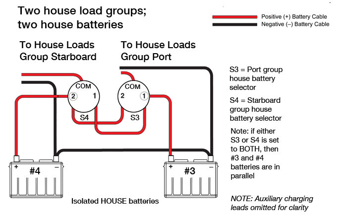

Here is a pictorial diagram showing how isolated house batteries #3 and #4 could be wired to two switches to control the primary power distribution from them:
Fig. 3: Two house batteries, two house load groups, two selector switches.
In this arrangement the house loads can be split into to groups, Port and Starboard. For example, sensitive electronics could be wired to one group, and heavier loads like pumps and motors wired to a second group.
Switch S3 selects which battery will supply power to the Port group; switch S4 selects which battery will supply power to the Starboard group.
In normal operation S3 is set to "1" and battery #3 supplies power to the Port load group. In normal operation, S4 is set to "2" and battery #4 supplies power to the Starboard load group. (To avoid confusion, the switch faces could be remarked with "3" and "4" instead of "1" and "2".
In unusual circumstances S3 and S4 could be set to "BOTH" to provide more power. For example, to run a heavy load like an anchor windlass.
If there is no desire to group the loads into to circuits, then just one switch can be used; its output will power all house loads.
Not shown is a ALWAYS-ON load like an automatic bilge pump, which should be wired directly to one of the two house batteries, bypassing the selector switch. This will permit the automatic pump to run even with the rest of the electrical system powered off.
