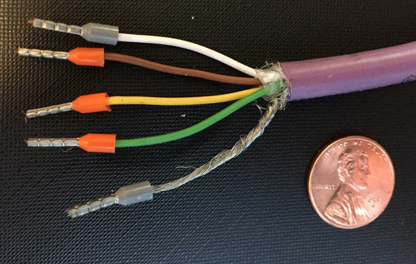

As mentioned in one of the other threads, long-time forum participant FNO sent me about a 12-foot length of (very nearly) appropriate cable that he uses in his professional work in industrial control networks. The cable is made by a German wire manufacturer. The sample I received was marked
    LAPP KABEL STUTTGART UNITRONIC® BUS LD 2 x 2 x 0.22 ROHS ART. 2170204
I interpret this as a cable made by a firm LAPP KABEL of Stuttgart, Germany, with the registered product name Unitronic, and having two pairs of two-conductors with wire cross section area 0.22 mm2, compliant with the Reduction of Hazardous Substances regulations, company part number or article number 2170204. And many thanks to Frank for sending this to me. I am very appreciative of his kindness.
On the manufacturer's website I found the cable specifications:
https://products.lappgroup.com/fileadmi ... 0203EN.pdf
The specifications do not mention the wire insulation colors explicitly, but instead refer to "Core identification code acc. to DIN 47100."
Searching for DIN 47100, I found that DIN 47100 (Deutsches Institut für Normung or in English “German Institute for Standardization” number 47100) is a wire insulation color code for identification of conductors in the telecommunications industry in use prior to November 1998, but afterward said to have been withdrawn without a replacement. (Cf. : https://en.wikipedia.org/wiki/DIN_47100 )
The standard identifies wire insulation colors to be used in sequence in multi-conductor cables. The first four conductors are to use these colors:
    First conductor = white
    Second conductor = brown
    Third conductor = green
    Fourth conductor = yellow
These are, indeed, the wire insulation colors specified by NMEA.
Regarding the size of the conductors, in this particular cable they are specified by their cross-section area in millimeters. A cross section of 0.22-mm2 is equivalent to AWG-24. The outer diameter of the cable including the outer insulating jacket is slightly greater than 7-mm or 0.28-inches.
Fig. 2. A cable made by LAPP KABEL in their Unitronic line of communication or data cables. This cable has the proper NMEA-0183 wire insulation colors. I included a penny to give a sense of the size of the cable.

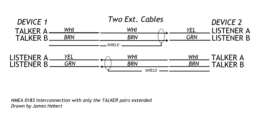

Inasmuch as there does not appear to be any convenient, quick, and inexpensive source for getting a two-pair cable with the NMEA wire insulation colors, I have turned to a simpler, faster, and less expensive solution.
A close reading of the NMEA-0183 standard—at least the portions of it that I can find published by NMEA that are not encumbered with non-disclosure—reveals advice on how to extend a cable between two devices if their integral cables are not long enough to reach from one device to the other. NMEA recommends that only the TALKER pair be extended, not the LISTENER pair. This suggests that if two devices were to be interconnected bi-directionally, then the TALKER pair from each device would be extended to the other device, and this would be done separately with two single-pair shielded cables. The wire insulation colors needed for a TALKER are WHITE/BROWN.
Fig. 3. NMEA-0183 interconnection with only the TALKER pairs extended. This requires only finding a single-pair cable with White and Brown conductors.
Unfortunately, cannot I find any shielded single-twisted-pair cable with WHITE/BROWN, I can find cables with WHITE/BLACK or WHITE/BLUE insulation colors. With such a cable the wiring could almost conform to the standard, and if the BLACK or BLUE conductor were re-marked at each end of the cable as BROWN (by using, for example, some brown heat shrink tubing), then the cable could be modified to conform with the recommended wire colors.
Finding a shielded twisted pair cable with wire insulation colors of BLACK and WHITE and available in small quantity is also not very simple. I found that MOUSER.COM sells a 24-AWG shielded twisted pair cable for about $0.44/foot in small lengths. More details at
https://www.mouser.com/ProductDetail/65 ... 21-24-0-99
The only drawback to using two separate cables to extend the NMEA-0183 interface TALKER signals is you need twice as much cable. If the two devices are ten feet apart, 20-feet of single-pair cable will be needed.
There are other manufacturers of similar cable, but generally those cables are only sold in a minimum of 100-foot spools. Several types have insulation rated for use in plenum space and are very expensive.
To mark the black insulation conductor to BROWN in a simple manner, brown nail polish can be used. Inexpensive brown nail polish is about $5, and one bottle could probably mark hundreds of conductors. Brown heat shrink tubing is another option, but it may be harder to acquire and more expensive.
This approach seems to be the easiest way to conform to the NMEA wire color insulation coding for NMEA-0183 wiring.
