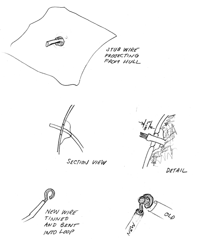

If circumstances require attempting to use wiring embedded in the hull, which now only projects clear of the hull a short distance, a method to attach new wiring to old wiring that is barely protruding from the hull is illustrated below:
Fig. 1. An illustration showing a method of making good electrical contact to wiring that is barely accessible.

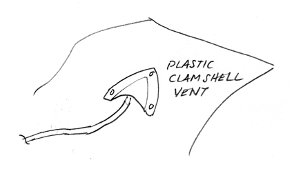

Fig. 2. Use of a clamshell vent to cover the exit of wiring from the hull.
I recommend trying the following:
  • carefully strip the insulation from the end of the wire stub emerging from the hull;
  • it is common that older wires will have the copper contaminated with oxidation and gunk from the vinyl or PVC wire insulation; this must be carefully cleaned and removed before trying to solder. Try using a cleaner that says it will remove oxidation from copper pans;
  • with the bare wire clean, tin the wire with solder;
  • connect to the bare wire with a new marine grade tinned multi-strand copper wire formed into a loop around the stub wire. Solder the two wires together;
  • in all soldering use just enough heat to get the solder melted and flowing; avoid melting the wire insulation;
  • when a good contact has been made, verify continuity in the circuit;
  • coat the connection with liquid vinyl electrical tape;
  • protect the connection with some sort of plastic clamshell vent or other similar fitting; this will hide the connection, and also dress up the wire exit

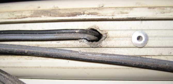

Fig. 3. Navigation lamp wiring typical in post-1972 Boston Whaler boats. One BLACK-GRAY pair enters into a hole; the other pair continues onward, under the rub rail.

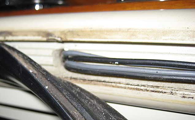

Fig. 4. Both BLACK-GRAY pairs enter a hole to reach the cockpit.
My understanding is in most modern Whalers the navigation light wiring runs in a conduit from the centre console under the port floor and up the port gunwale, and then forward in a channel under the rub rail.
Peter O.

PETER--thanks for the illustrations of navigation lamp wiring in a newer Boston Whaler. I see the paired BLACK-GRAY two conductor flat cable is still used.
I also note in Figure 3 that you can see abrasion on the gray insulation of the paired conductor going into the hole. The hole also looks like it was drilled in a big hurry, with rough edges remaining on the exit.

Re using sheathed two-conductor flat cable: you do not have to retain the sheath when the cable reaches the holes passing through the rub rail into the lamp. Strip back the sheath at that point, and run just the two conductors into the hole. Of course, leave plenty of length for the conductors so you can easily work with them making connection to the lamp.
Before installing new wiring, check any existing holes for roughness and residue around the hole exit. The holes seen in illustrations above show some rather roughly drilled holes that could use some refinement.
