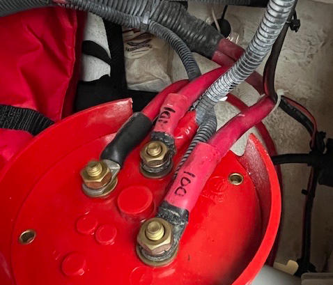

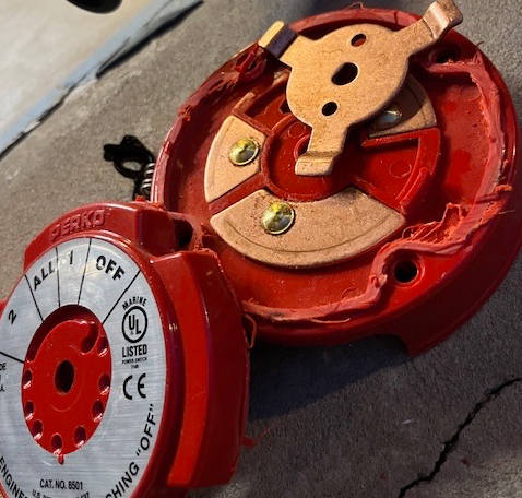

The bad news for me: the old switch felt, sounded, and measured all good when I turn it. I did take apart, I had to basically destroy it to open it, and its contacts look very clean.
The old switch measured 0.6 to 0.7 Ohms, which I believe is normal for continuity for a switch.
Fig. 1. The battery switch rear panel. [Presumably, this is old switch whose function was suspected to be the cause of the intermittent electrical system drop out.]
Fig. 2. The old battery switch after disassembly to reveal the condition of the contacts inside.
I wish I had measured the new switch. At this point I have [the new switch] screwed in place.

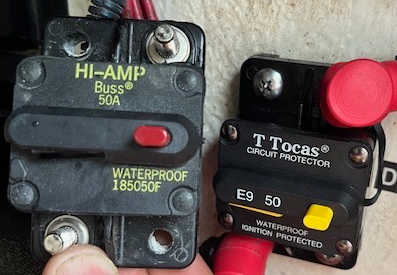

I bought the new 50-Ampere circuit breaker from Amazon so I could get it next day.
Fig. 3. The new and original circuit breakers.
I also ordered the OEM brand and might switch it when it arrives, or keep it as a spare.

islavov wrote:I measured the old breaker and the slightest tap on the small little test button increased the resistance and basically is opening the switch.
The "test" button is NOT a test button. The button is intended to open the circuit breaker when pressed.
You should duplicate the test with the new circuit breaker, and report if tapping on the button on that circuit breaker begins to affect the connection.

Received the OEM Bussmann breaker, and did the same test. The test showed the the old breaker was away too sensitive [to any contact with the button that opens the circuit breaker]/

A handful of owners have reported a failure of the OEM circuit breaker, similar to the one in the photograph, on Montauk 170 I's over the last few years.
Apparently they don't hold up very well.
There are many manufacturers of this style of breaker. Quality counts.
Posts: 12826
Re: Losing Electrical Power to Helm Console
Postby jimh » Wed Sep 25, 2024 12:49 pm
Phil T wrote:There are many manufacturers of this style of breaker. Quality counts.
PHIL T makes a good point. Buying the no-brand cheapest stuff may not pay off in the long run. A good vendor to use for marine surface mount circuit breakers is Blue Sea Systems and their 285-series, which sell for about $40 on Amazon. See the manufacturer's listing of circuit breakers for surface mounting at
https://www.bluesea.com/products/catego ... face_Mount
and see Amazon vendors of them at
https://www.amazon.com/Blue-Sea-Systems ... V7AA/?th=1
