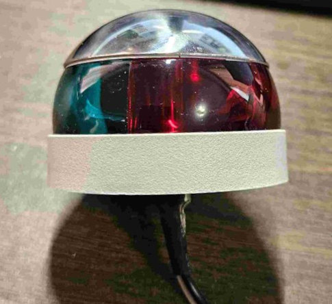

I found a source for a replacement [bi-color red-green lens for the combined sidelight lamp used on a 2014 170 MONTAUK and other Boston Whaler boats] that fits just like the OEM lens. [Moderator's note:in a second post in a different thread, the replacement lens was identified as a Aqua Signal Part Number 24121-1, but no source information was given. Information from the second post is joined with and is now part of this post.]
Fig. 1. A navigation lamp assembly.

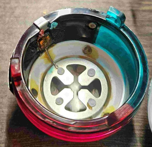

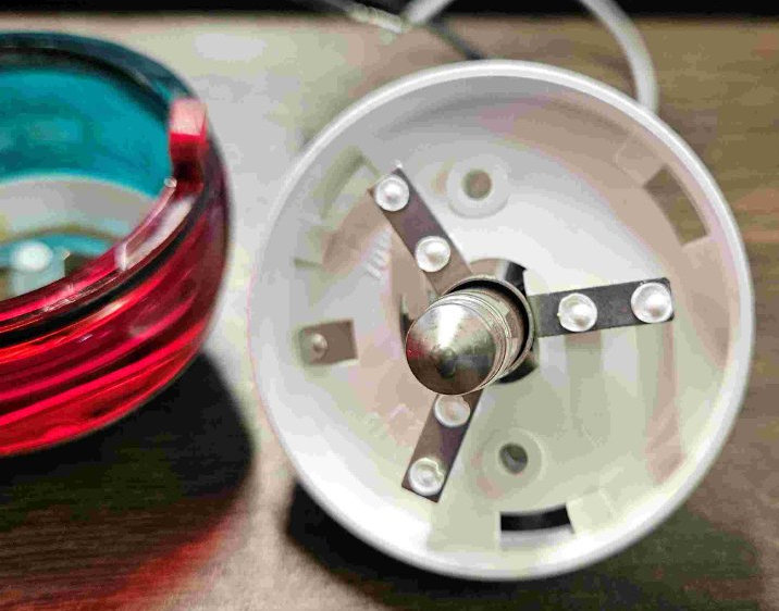

You need to remove the metal inside the [replacement lens.]
Moderator's note: I believe this refers to the hidden electrical contact, seen in Figure 3, as perhaps the only part of the lamp to be used will be the lens.]
Fig. 2. Interior of replacement lamp showing lower electrical contact for a Festoon-style lightbulb.
I also modified my lamp to use a two-wire No. 196 lightbulb socket and a sealed LED lightbulb, replacing the "wedge-looking" lightbulb. [The term "wedge-looking" lightbulb may refer to the Festoon-style and vertically-mounting miniature incandescent lightbulb used in the lamp assembly from which the replacement lens is taken.]
Fig. 3. Detail of the replacement lens assembly which contains part of the electrical connection for the Festoon-style lightbulb used in this lamp.

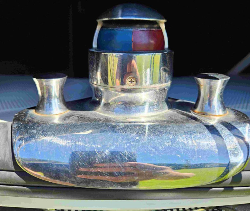

Fig. 4. The well-known Boston Whaler combined chock and navigation lamp, now with a replacement red-green lens.
