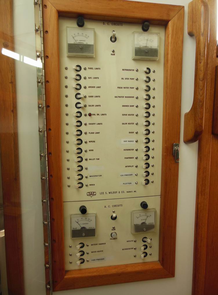

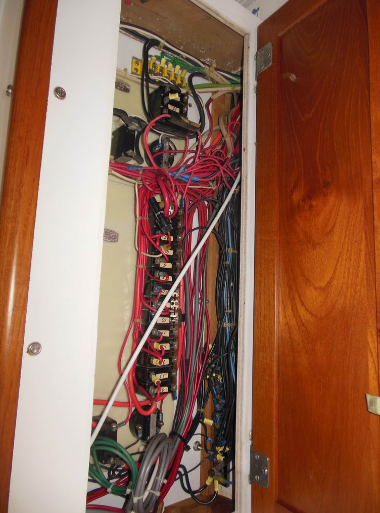

The circuit breaker for the lights in the head/shower fall under "Cabin Lights". Not too many lights on that circuit (4 lights(?).
jimp
I've got about 3" to play with coming from the overhead.
jimp

Re: 12-volt Lamp has Power, doesn't Illuminate
Since the branch circuit for the lamp has a circuit breaker, and you have identified the breaker, then proceed as follows:
--switch the breaker to OFF; you don't have to disconnect any wiring;
--connect one lead of an Ohmmeter to the load side of the breaker; this should be a RED wire that feeds the lamp circuit you are investigating;
--connect the other lead of the Ohmmeter to the lamp socket contacts, one at a time. One of them should have continuity to the circuit breaker. Measure this resistance.
The resistance should be very low, on the order of 0.1 to 0.2-Ohm. If the resistance is much higher, say more than 6-Ohms, there is something awry with the wiring of that circuit.
You can repeat the resistance measurement of the other lamp socket contact to the negative bus. It should have similarly low resistance.
