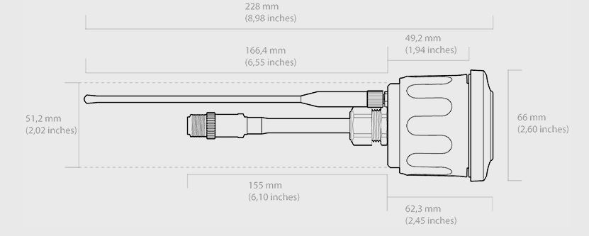

The circular gizmo is the xHUB and it gets wired directly to power - it actually can be used stand-alone or in parallel with your existing kill switch. Or it can be used as a MOB alarm only device. The battery symbol on the xHUB shows the battery strength on the wireless connected xFOB - the device that you wear. The four bars indicate 10 %, 40 %, 70 % and 100 % of battery life. The xFOB is suppose to have total battery life of 300 hours of connected time it uses a CR2032 battery. The xFOB pairs with the xHUB just like a Bluetooth phone - I think up to 20 xFOB's can be paired to a single xHUB, so each crew member can be protected in a MOB situation.
Also note there is an external antenna that is install on the back of the xHUB. It requires about 8.5" of depth from the rear of your console - you need to keep this in mind when picking your mounting location:

Installed my MOB kit yesterday.
I mounted it where the dash was almost as thick as the threaded portion of the main unit. The locking collar threads do not start for about the 3/8-inch. Instructions recommend gluing-in the control if the threads won't work. I ended up using duct tape on a piece of PVC, screwed the collar on over the tape and then used a chop saw. That worked and the control is secure in the dash.

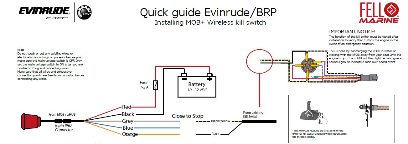

My original lanyard controls are so short I can't get in to splice wires, so for now I left the lanyard out of the equation.
The wire connectors supplied with the kit are a bit smaller then the typical Ancor brand wire. My Ancor ratcheting crimpers would not crimp tight enough to hold the connectors to the pig tails.
The wireless remote and the wireless base paired up right away and turned on and off as expected.

Fell Marine - I would suggest either longer threaded portion on the control head or full threads on the collar. And longer pig tails. I have a lot of wire here but not matching size and colors, and I needed to extend the harness a bit.
What [the Fell Marine MOB Engine Shut Off] did not do:
--shut off when I walked away from the boat, over 200-feet
--shut off when I dropped it in a bucket of water, either on the deck or 20-feet from the boat, this was with the fob in the wrist strap.
If I removed the fob from the wrist strap and dropped it in a bucket, about [half] the time it would shut the engine after what seemed like six to 10 seconds.
Suggestions?

Re your comments on the amount of threaded material on the device and the limit it imposes on mounting to an instrument panel: I looked at some marine instruments I have on hand and measured the maximum panel thickness that could be used in mounting them with the supplied hardware; they could tolerate 1.375-inch thick panels. These instruments could also be mounted to very thin panels with the same hardware. The Fell Marine MOB device seems to have a more limited range of panel thickness that can be accommodated in mounting.
Re the distance between the base and remote key fob before activation of engine shut off: I presume the basis for determining when to shut off the engine is the strength of the signal received from the key fob remote. If that is true, I can see how on dry land you could be 200-feet away and not have the signal strength drop below threshold. The better test may be to get in the water and submerge the key fob a foot below the surface. I suspect the separation distance between base and remote need to trigger the engine shut off will be less.
