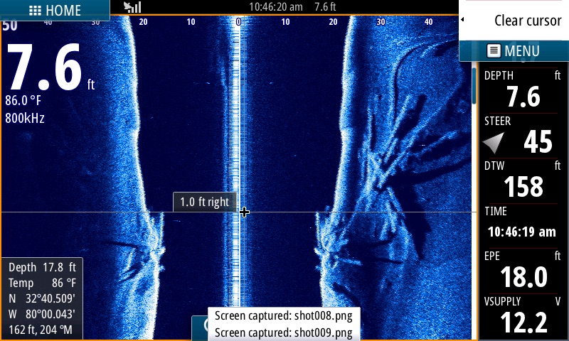

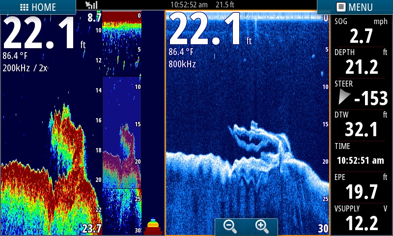

[The below] screenshots are from a SIMRAD GO7 XSE using [the Total Scan transducer]. The structures are concrete pipe. In 17-feet saltwater. Side scan and down scan.
