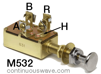

The M532 switch is a versatile but also confusing three-position switch that controls three circuits in two combination (1+2 and 1+3). It can be used in several ways to control navigation lighting. I describe two common arrangements. First the more complicated and unusual arrangement of a dual-bulb fixture that serves as both an anchor light and a masthead light lamp. This arrangement is usually seen on larger boats, but many Boston Whaler boats of 18-feet or longer had this type of lighting. They also used this switch to control the lamps. This switch is detailed in a drawing available on-line in PDF format. The switch has four terminals, marked A, B, H, and R.
Fig. 1. A Cole-Hersee M532 Switch with callouts

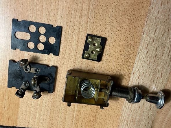

The mechanical arraignment of the switch has four tabs that hold it together. These tabs were easily bent back for disassembly using a chisel, a flat bladed screwdriver, and needle nose pliers. A brass plate is held against brass contacts and is pulled back and forth by the switch handle. There was no model number on the the particular switch I disassembled.
Fig. 2. A disassembled pull switch
Cole Hersee switch disassembled pic 1.jpeg (71.48 KiB) Viewed 29872 times

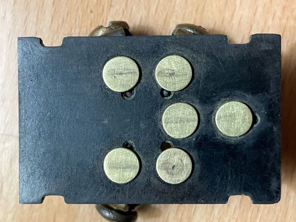

The internal contacts were oxidized. The contacts brightened up nicely after a light sanding with 200-grit sandpaper. The switch worked normally when tested with an ohmmeter after reassembly.
I took the precaution of annealing the brass tabs using a butane lighter before reassembly to minimize the risk of them breaking off when being bent back into place.
Fig. 3. The internal electrical contacts after cleaning.
Cole Hersee switch disassembled pic 4.jpeg (56.53 KiB) Viewed 29872 times

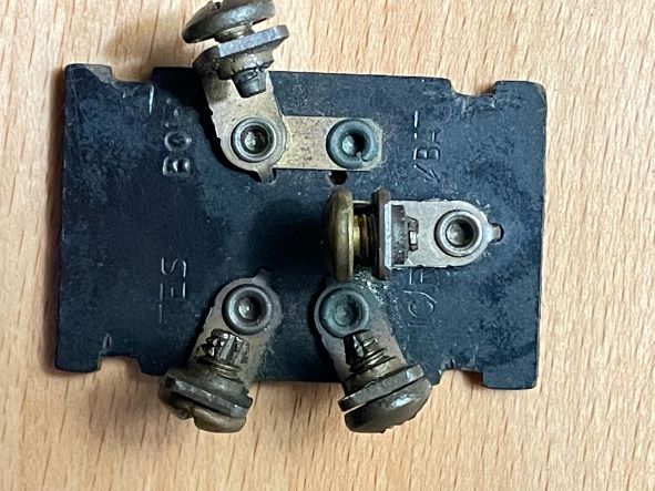

A closer look at my switch shows some differences from the switches described in previous posts.
Fig. 4. Labeling of the pull switch.
Cole Hersee switch disassembled pic 2.jpeg (63.97 KiB) Viewed 29872 times
The terminals are marked (clockwise from top right) "BOW", "BAT", "ANCR", and "LITES", with the BAT terminal oriented towards the switch pull. Note that the BOW terminal gets current at both the first and second stops, while the ANCR terminal will receive current only when the switch is at the second stop, and the LITES terminal (which is not used) gets current only at the first stop. Thus, if the unit is wired as the labeling suggests (combined sidelights lamp to BOW, white all-round lamp to ANCR), there is no way to comply with the lighting required at anchor, i.e., only the white all-round lamp illuminated. At first I thought I might have reassembled the unit incorrectly, but that was not the case. Fortunately, I had taken a photo of the switch and labeled all the wires before removing the unit. When I connected the white all-round lamp circuit to the BOW terminal and the combined sidelight lamp to the ANCR terminal, the system worked perfectly.
1990 Montauk 17’ w 2024 Yamaha F70LA outboard
1995 Aquasport Explorer 245 w twin 1995 Yamaha 150 HP outboards
Re: Cole Hersee Switches
Postby jimh » Wed Dec 14, 2022 9:43 am
When I compare the Cole-Hersee M532 switch seen in Figure 1 with the switch seen in Figures 2, 3, and 4, I notice that the Cole-Hersee switch in Figure 1 has six brass tabs that retain the contact assemble to the brass body, and the switch seen in Figures 2, 3, and 4 has only four tabs.
Another difference: the terminal legends embossed on the terminal insulator plate of the switch seen in Figures 2, 3, and 4 are also very curious. The Cole-Hersee switch does not have such labels.
These differences make me wonder if the switch seen in Figures 2, 3, and 4 is not an actual Cole-Hersee switch, but rather is a knock off or imitation.

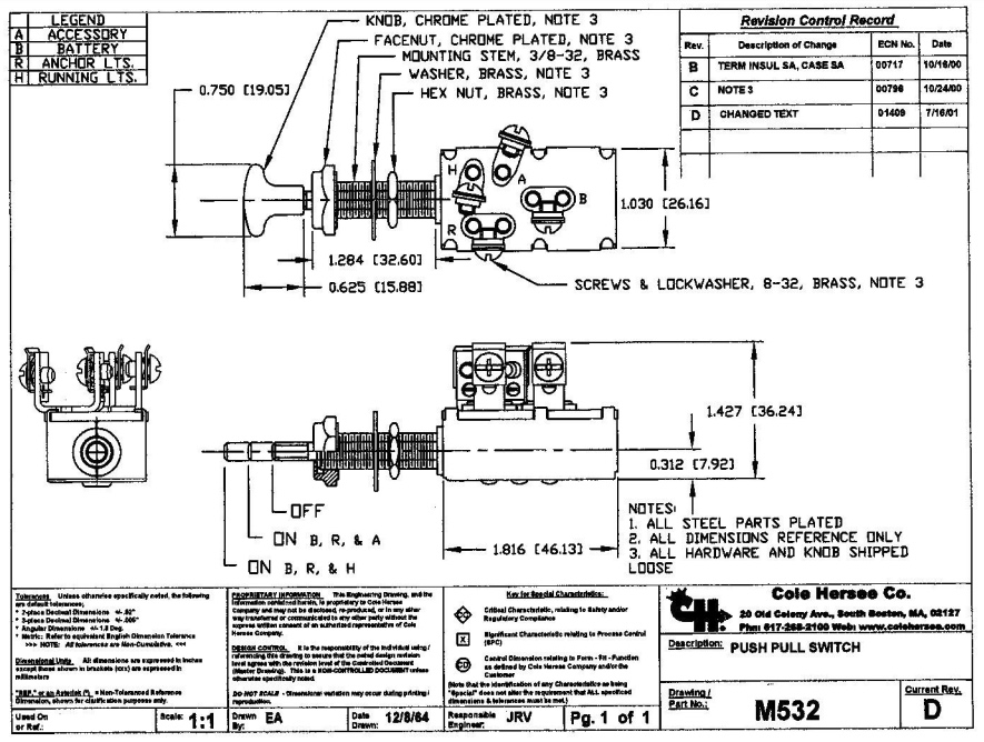

Let's look at the actual drawing from Cole-Hersee that shows the M532 switch:
Fig. 5. Cole Hersee M532 Switch drawing dated 1964.
Looking at the drawing in Figure 5, note the table in the upper left. The table links the four letters on the switch to their use in navigation lamp wiring.
    A = ACCESSORY
    B = BATTERY
    R = ANCHOR LTS
    H = RUNNING LTS
There is no indication that the actual switch has these names embossed on the switch terminal insulator plate; there are only the four letters.

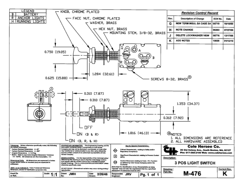

For reference, here is the mechanical drawing for the M-476 switch. Note the date on the drawing: 1946.
Fig. 6. A Cole-Hersee drawing for the M-476 switch.
