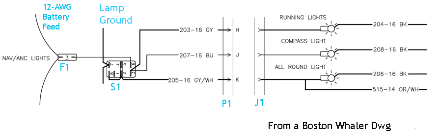

Let's look at the form of electrical diagram used by Boston Whaler. Fig. 1 (below) is excerpt from a typical Boston Whaler drawing, to which I have added some annotation (in blue).
Fig. 1. Excerpt from a typical Boston Whaler electrical diagram.
Electrical wiring diagrams are usually laid out to be followed from left to right. In the above diagram the positive circuit is shown by the curved wire lines that connect to a current protection device, either a circuit breaker or a fuse, which I note as F1 (my added reference designator). The use of a curving line is likely meant to suggest that the actual wiring is a looping or jumpering from one component to the next. This wiring is described elsewhere in the drawing as being on a 12-AWG conductor with RED insulation that originates at the FUSE BLOCK. This conductor brings the boat battery positive to F1. F1 is a 3-Ampere device. From the nature of the symbol I infer it is a fuse. The fused output then connects to terminal 6 on switch S1. A note on the drawing indicates the conductor should be 14-AWG; the inference is this wire will also have red insulation.
Switch S1 is for control of the "NAV/ANC LIGHTS", as inferred from the legend on the drawing.
Also at S1 is the battery negative circuit, which I have identified as "Lamp Ground." This conductor is at the switch to provide for a return circuit for the internal switch illumination. It does not carry any of the current from the loads (other lamps) that are controlled by the switch. Elsewhere in the drawing this conductor is shown to be a 12-AWG black conductor fed from the "FWD GROUND BUS," which is a terminal bus near the helm dash panel where the switch is located. This terminal bus is shown to be connected to the MAIN GROUND BUS, detailed on another page of the drawing.
Coming from switch S1 are three conductors. These are identified with a three-part notation: wire number, wire gauge, wire insulation color. A wire associated with the "RUNNING LIGHTS" is identified as "203-16 GY." This is a 16-AWG conductor with gray insulation and should be marked in some manner with the number "203." This conductor goes to terminal "H" of a multi-pin plug P1. P1 mates with a multi-socket jack, J1. Wire 203 continues from J1 to its load, a lamp circuit noted as "RUNNING LIGHTS." From the lamp a second conductor, 204-16 BK continues to the FWD NEGATIVE BUS. This is a 16-AWG conductor with black insulation marked with the number "204." This completes the circuit for the lamp. In a similar manner, 207-16 BU (blue, the color used for instrument illumination circuits) is routed to the compass illumination. This means the compass illumination circuit will be powered whenever the sidelights are powered.
The wire marked 205-16 GY/WH (gray-white) is routed to the "ALL ROUND LIGHT." Note that the circuit for the ALL ROUND LIGHT, after passing through the connectors, is split, with wire 515-14 OR/WH (orange-white) spliced into the circuit. (In this drawing style, lines representing conductors that cross at right angles are not connections, but this line terminating into another line represents a joining of the circuit. In some other wiring diagrams, Boston Whaler uses a small dot to indicate that conductors are joined together.) The conductor insulation color orange-white is a bit of an oddball color, and in this case it goes to an optional entertainment device; the function is not described.

SWITCH CONTROLLING NAVIGATION LIGHTING
The internal wiring of S1 is not detailed on the drawing seen in Figure 1. To understand the switch action you must get the details of the switch and terminals from the manufacturer of the switch. The Boston Whaler drawing does not specify the switch manufacturer or model. Without this information it will be almost impossible to know exactly how the switch operates, however, in a drawing for another boat Boston Whaler does show the details of the switch action for the navigation lighting circuit. I will assume that switch is similar to the switch S1 shown in Fig. 1. Below Fig. 2 shows the switch action in detail from a segment of a Boston Whaler drawing; again, I have added annotation to show the insulation color, the wire gauge of the conductor, and the name of the circuit involved.

MULTI-PIN CONNECTOR GENDER
As shown in Figure 1 the contact genders at the two connectors, P1 and J1, are arranged so that the source of power for most loads is provided on an male contact. This is generally not a good practice. Sources of power in connectors usually are on recessed female contacts (sockets) so that inadvertent contact with those sources will be unlikely and won't result in power being shorted to ground. However, in this particular example the power in that connector runs in both directions. Another circuit (not shown in the excerpt) carries through that connector the 12-Volt battery positive on a 12-AWG conductor coming from the FUSE BLOCK, from where it is fed power from a 6-AWG conductor that is on the load side of a 25-Ampere circuit breaker. Thus once the connector is unmated, there will be no power at all on the P1 side, since all the power ultimately is coming from the J1 aide. Therefore it is more proper to put the female gender contacts on J1 side.
