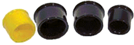

There is no harm to network operation in having one port of a 4-port T-connector not connected to a device. Do not use a terminator to cover this open port. Do not leave an used extension cable connected here, either. To protect the open port from the weather, use one of the colored flexible vinyl caps that came on your Lowrance HDS when it was shipped that covered the connectors on the rear panel, or use some fresh 3M Scotch Super 33+ vinyl electrical tape to cover the sockets on the unused connector on the 4-port T-connector.
Lowrance soft vinyl connector caps
I have never seen a cap as described above in the quoted material from Lowrance, or any place to buy one. Although the quoted material is attributed to Lowrance, I believe it comes from an older version of the their literature, and I have some doubt that they are still providing such a device for retail sale.

Star Marine Depot lists Maretron NMEA-2000 connector caps. Part # M000101 Female and Part# M000102 Male at their online store.

Yes, I suspect MARETRON may have these caps. Perhaps you can give the URL to where you buy them. It would be much handier that way. I think you may have been talking about these:
http://www.starmarinedepot.com/maretron ... ector.html
For $3 for a cap and then $11 for ground for shipping, I'll look around for the free vinyl cap that came with the HDS. I never throw anything away.
You can also get Micro-C Connector Caps from other sources, such as Molex--who is probably the OEM of a lot of these cables---although I have no idea where you'd actually find a Molex distributor with them in stock:

Yes that shipping would be high. Probably best to include them with the initial purchase of a 4 port T. They are also on E-Bay with free shipping.
I would prefer a threaded cap to using tape on a port. as access to half my T's are in a closed overhead electronics box with flush mounted MFD's ,VHF, and spotlight controls and, once buttoned up, I hope to not have to get in there again for quite some time.
