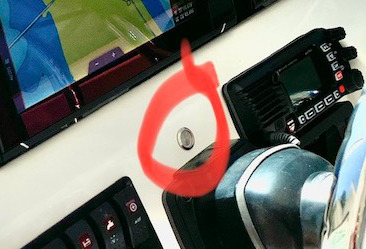

To control power to the NMEA-2000 network I used a BLUE SEA SYSTEMS lighted push button switch.

I contacted Blue Sea Systems. They told me the switch I was using was discontinued [due to internal contact leakage] and was now replaced with a newer model [without any internal contact leakage]. Blue Sea Systems sent me a new switch. The new switch had a slightly larger mounting hole--there was already a big hole in the center of my dashboard.
Fig. 1. A dashboard switch around which a red circle has been drawn to draw attention to the switch.
The new switch had almost identical problems: the switch illumination was not working correctly; it was only a red LED when powered on.
