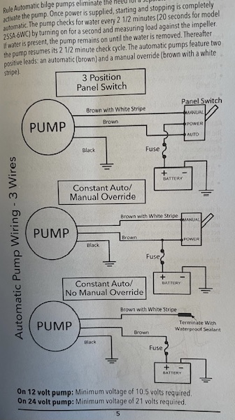

I purchased a bought a RULE pump with automatic water sensing. I want to connect the new pump to the existing three-way switch on my boat.
The RULE pump has three wires with the wire insulation colors Black, Brown, Brown with White.
[Moderator’s note: the circuit is now going to be described in a narrative.]
The wire with Black insulation goes to the indicator lamp on the switch, and not direct to ground, according to the
Instructions.
Q1: is the instruction to connect the black wire to the lamp on the switch panel correct?

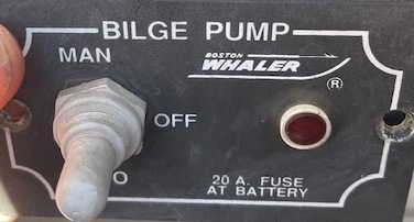

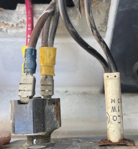

According to the instructions I would ground the black wire, however the black wire for the old pump is connected to the indicator light on the bilge pump switch. Then there is black jumper from the light down to the brown wire.
I have search all sorts of manuals and online resources & have not seen this configuration.
Maybe the old switch will not work with the newer auto bilge.
Paul

From what I can see from the instructions shown in FIgure 1, the pump you have purchased works in the following manner:
  • the BLACK conductor from the pump MUST be connected to the BATTERY NEGATIVE at all times;
  • the BROWN conductor from the pump is to be connected to a source of 12-Volt positive power when you want the pump to operate AUTOMATICALLY, that is, when the pump senses water and initiates and terminates its own operation;
  • the BROWN with WHITE conductor is to be connected to a source of 12-Volt positive power when you want to cause the pump to operate no matter if it has sensed water or not.
The LAMP on the original control panel for the previous pump, which indicated to the operator that the pump was receiving electrical power, cannot be used with the new pump without additional circuitry. If you wish to use the lamp with the new pump so that the lamp will illuminate when the pump is receiving electrical power, you will have to add two steering diodes to the circuit. I can explain this further to you if you feel like you will be sufficiently skilled in electrical wiring to accomplish this modification. Generally, anyone familiar with electrical DC circuits would deduce the need for the two diodes themselves, and would immediately know where and how to install them.

Generally, there has been a useful wiring of a switch related to operation of a pump, and Boston Whaler has used this method. I describe it as follows:
  • a single pole three-position ON-OFF-ON (MOMENTARY) switch is used
  • +12 Volt power is provided to the switch COMMON
  • the switch ON terminal provides power to operate the pump through a separate controlling device, usually a float switch; this is the AUTO position;
  • the switch ON MOMENTARY contact provides power directly to the pump motor while an operator holds the switch in this position; this is the MANUAL position;
  • if the the switch is left in the OFF position, no power flows to the pump motor.
Assuming the existing switch is the same as I have described, you can re-use the switch. From the description above it should be easy to deduce which wire colors from the pump go to which terminals on the switch. If you need more help with this, reply and I will get into even greater detail.

pcloward wrote:According to the instructions I would ground the black wire, however the black wire for the old pump is connected to the indicator light on the bilge pump switch.
I believe you are imputing too much significance to the wire insulation color on the lamp leads being black. The notion that the lamp leads are provided on wire with black insulation should not be imputed to mean there is a correlation between those leads and a lead provided by the pump manufacturer which happens to also be implemented using wire with black insulation.

You can use the existing switch and lamp, but you need to add two diodes. The cost of the diodes will be less than a dollar.
The anode of one diode (D1) will connect to the BROWN conductor from the pump.
The another of the other diode (D2) will connect to the BROWN with WHITE conductor from the pump.
The cathodes of D1 and D2 will be connected in common with one of the BLACK leads from the existing LAMP; the other BLACK lead from the existing lamp will connect to battery negative.
You can use just about any small diode for this purpose. For example a 1N4001 diode that costs about $0.20 will work.
HINT: the marking on the diode that looks like an arrow is the cathode; the marking on the diode that looks like a bar is the anode.
HINT: you can wire the diodes at the switch terminals.
ASIDE: the cost of shipping and handling to order two $0.20 diodes will be much greater than the actual cost. Look for a local electronics parts store, order from Amazon Prime, or ask a friend who has a background in electronics if he has two suitable diodes he can give you for a beer.
