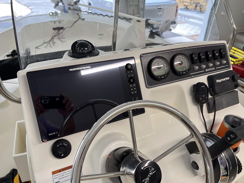

Fig. 1. Helm dashboard after installing a Solix 12. It fits perfectly and is about the biggest screen I could put in there. Note that the Raymarine VHF and antenna are factory-installed. In the background at the bow is the new wiring run to the bow for the trolling motor power and control circuits.

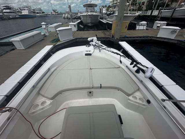

Fig 2: The location for the trolling motor puts it almost dead center when deployed, which is ideal. It also clears the cushion area for when folks are lounging, and does not protrude outside the gunwhales (for docking). You need the factory trolling motor prep package which deletes bow rails and adds bow reinforcement to do this. I also added the Minn Kota support to keep the motor steady in choppy conditions.

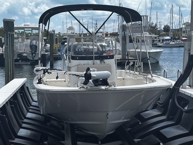

Fig. 3. Note how the trolling motor does not project outboard of the gunwales. It leaves room for anchor lines, and the trolling motor is clear of the OEM combined sidelight lamp--but not by much.

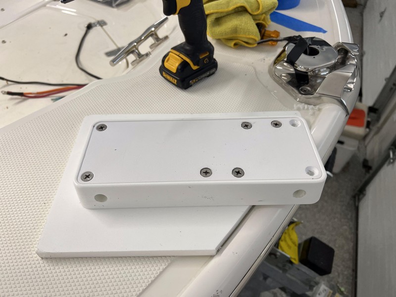

I re-used my Terrova 80 with 54" shaft, but had to replace the shaft with a longer one. I figured about 65" as optimal so I bought a 72" shaft and motor assembly to make sure it would go deep enough. I can always cut some off the shaft if it seems too long, but so far it's manageable. Replacing the shaft was easy enough once I bought the special spring retention tool. BTW, Minn Kota told me I couldn't replace the shaft with the 72" shaft due to different electronics. Rick at AnglersStorageGa.com, also know as Marine Carpeting in Georgia, confirmed the brains were all in the head unit and that it would work. He was correct. I retained the existing wiring in the unit (set up as a coil spring) and it was just barely long enough to handle the longer shaft.
Using a longer shaft meant I needed to upgrade my quick release mount to a heavier duty version due to greater torque on the mount - the RT54 instead of the RT17.
The lip on the boat gunwales meant I needed a spacer, custom cut to match the curve of the bow. I bought WHITE KING STARBOARD 8" X 12" 1/2" on Amazon and cut it with a scroll saw. I had to use a standard (not metric) thread tap to cut threads into the bow, which is reinforced to hold bolts for a trolling motor.
I lined the trolling motor (TM) along the right side of the boat due to visibility - the steering wheel is on the port side and I can see buoys coming at me better this way. But I did put the TM as close to the centerline of the boat as possible. It may interfere a tad with my bow light - we will see.
Another concern with TM location is clearing the bimini when it's in the down position for storage in my garage. Even with the 72" shaft, my motor does not interfere with the bimini lying flat.

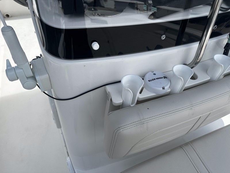

The trolling motor has a heading position sensor. I mounted mine on my rod holder at the front of the center console, and ran the wire in through the same opening as the VHF antenna.
Humminbird Solix 12
After careful examination, this was the largest Humminbird I could install in-dash. I decided on in-dash for slickness and anti-theft.
Installation was easy yet terrifying at the thought of making a mistake on my new Whaler and having an unsightly hole in the console. Therefore instead of measuring twice, cutting once, I opted for measuring 7 or 8 times. I also drilled pilot holes about an inch inside of each corner so I could confirm measurements and clearances INSIDE the console. Also ordered a special carbide/ceramic cutting blade to cut the fiberglass. Obviously I taped the entire dash area with masking tape before marking and cutting. Also had to remove the steering wheel for clearance. Believe it or not, the Solix slipped in perfectly on the first try. Looks great! Be careful figuring out where "level" is on that curved dash/console while sitting in your boat on a trailer which is also probably not perfectly level.

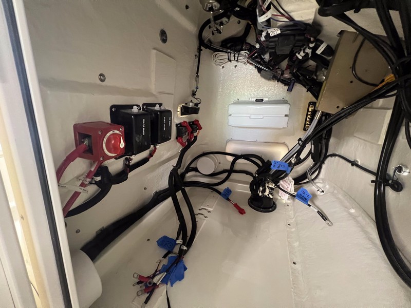

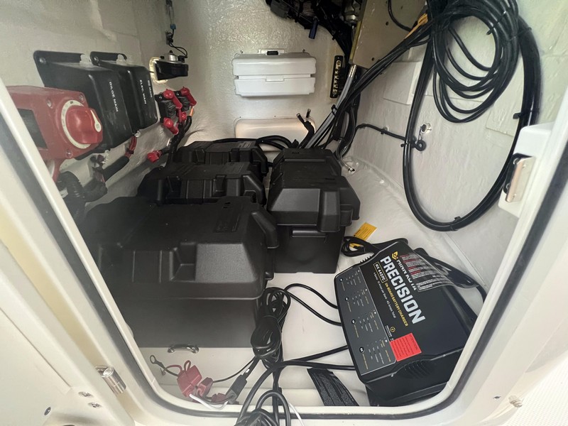

Fig. 4. Inside the center console there are four batteries, a battery charger, a new On-Off switch (not shown), and a 60-Ampere circuit breaker (not shown) for the trolling motor. The placement of the batteries is shown, but no wiring has been run to them yet..

Fig. 5. All wiring runs to the black boot that enters into the cockpit deck, seen at the center rear. To add wiring to the black boot many zip ties have to be cut off, and the boot extended upward. The white tags attach to small diameter ropes ( to the right of the boot) that are used to pull in new wiring to bow and stern through the plastic conduit.

FIg. 6. A Minn Kota heading sensor is installed on the rod holders forward of the center console. The cable runs to the same opening as used by VHF antenna on the starboard side of the console.

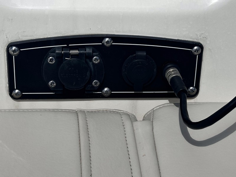

Fig. 7. The OEM electrical plate at the bow, below the anchor cleat is shown. The trolling motor plugs into the receptacle on the left. I don't recall if the power connector was OEM or I had to replace the original with a connector specific to the Minn-Kota motor. The smaller connector on right is also for the trolling motor.

Fig. 8. The heavy-duty version of Minn Kota's quick release plate is mounted atop of a piece of KING StaBoard so that it will clear the white rub-rail.

In Figure 3 and Figure 6 there appears to be a VHF Marine Band radio antenna mounted to the Starboard side of the center console. I know that on open boats like the MONTAUK series there is a dilemma concerning where to place the VHF Marine Band radio antenna, as typically there will be a sun shade or Bimini top over the center console which will tend to obstruct a tall antenna mounting from being used.
The problem with the antennas as located is it is just too low and too close to people.
Q1: was that antenna and radio installed at the factory by Boston Whaler?

Yes, that is the factory VHF antenna. It clears the bimini, whether the bimini is up or down.

Thanks for the further information about the VHF Marine Band radio and its antenna having been installed by Boston Whaler.
From what I see, the radio is mounted on the starboard edge of the console. The antenna is mounted about a foot away. The radio is clearly directly in the main radiation lobe of the antenna and perhaps a foot away. Apparently the radio actually works in that location, but generally there should be more separation between the radio and its transmitting antenna. Also a higher mounting position for the antenna base would be preferred.
In the overall scheme of life, to have the Bimini top providing protection for the helmsman from exposure to ultra-violet radiation from the Sun is more important than to remove the Bimini top in favor of a higher antenna mounting point.
