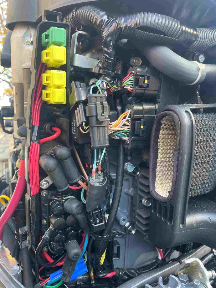

I just bought and rigged a used 2005 Yamaha F90 with a new Yamaha 704 controller and an OEM Yamaha 10-pole wiring harness. The power trim is not working correctly.
The F90 engine will down trim from the trim DOWN switch on the cowling and from the trim DOWN switch at helm. When the trim UP switch is depressed it just "clicks."
NARRATIVE OF SOME TESTS PERFORMED
I have disconnected the BLUE and GREEN 10-AWG conductors that run to the trim motor from the trim relay. Using a good battery I confirmed that the trim motor will operate in both directions.
The trim relay functions correctly and operates the trim motor in both directions WHEN the two-pole connector with LIGHT BLUE and LIGHT GREEN conductors is disconnected and 12-Volts is jumpered to each pin.
However, when testing the two-pole connector with LIGHT BLUE and LIGHT GREEN with a Voltmeter, I get the following:
--when operating either the helm trim switch or the cowling trim switch in the DOWN position, I get 12--Volts on LIGHT GREEN.
--when operating either the helm trim switch or the cowling trim switch in the UP position, I get 12--Volts on both LIGHT GREEN and LIGHT BLUE.
I suspect the cause if this unusual outcome is a bad switch.
I disconnected the 10-pole boat harness from the engine at the side of the engine and retested. There was no change, that is, there was still 12-Volts on both LIGHT BLUE and LIGHT GREEN conductors when the cowling switch was operated in the UP position.
Then I disconnected the cowling trim switch and re-connected the wiring harness to the remote controls, Repeating the tests produced the same outcome: there is still 12-Volts on the both the LIGHT BLUE and LIGHT GREEN at the connector before when operating the helm control trim switch in the UP position.
I also tested each trim switch while engaging up and down with an Ohmmeter to see if I could find an obvious short between LIGHT BLUE and LIGHT BREEN conductors, but I could not detect a short circuit.
I de-rigged the boat harness and tested [for continuity] across each pin--especially the trim wires--and could not find any obvious sign of a short or connection across any of the wires.
From other write-ups this all leads me to believe there is a wire defect between the 10-pole connector on the side of the motor and the two-pole LIGHT BLUE and LIGHT GREEN connector for the trim relay.
Before I go cutting up an otherwise good Yamaha wiring harness I have to ask:
Q1: am I missing anything?
Q2: Is there anywhere else these trim wires come together?
Q3: Could one or both trim switch be bad but not show on an ohm check?
Any help appreciated.

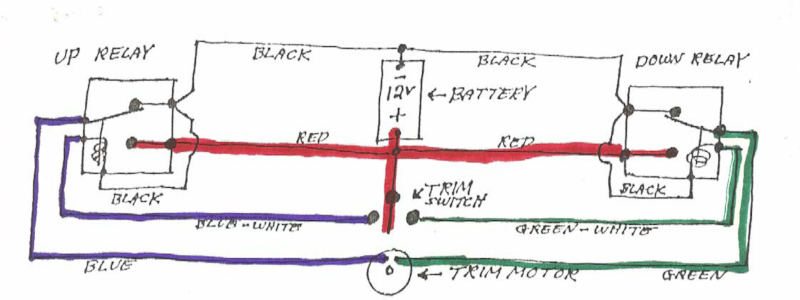

First, let me show a very simple drawing of the usual and very common power trim circuit. It is quite a crafty implementation of the control circuit and uses a minimum of wiring and just two single pole relays.
As shown in Figure 1 above, the engine trim motor is connected to the COMMON pole of each relay. When both relays are NOT energized, the result is both the BLUE and the GREEN circuit to the motor will remain connected to battery negative by the NORMALLY CLOSED contacts of the relay, and there is no voltage applied to the trim motor. As a result the trim motor does not operate.
When the relay associated with the GREEN conductor--which is called the DOWN RELAY--is energized, the GREEN conductor is then connected to the NORMALLY OPEN contact of the relay, which is the 12-Volt battery positive, resulting in the trim motor getting 12-Volts applied, and causing it to run in the DOWN direction.
When the relay associated with the BLUE conductor--which is called the UP RELAY--is energized, the BLUE conductor is then connected to the NORMALLY OPEN contact of the relay, which is the 12-Volt battery positive, resulting in the trim motor getting 12-Volts applied, and causing it to run the UP direction.

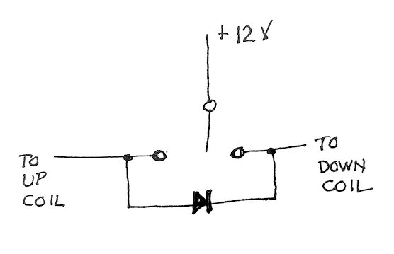

Figure 2 is a sketch of how the diode would be connected between the LIGHT GREEN and LIGHT BLUE wires at the trim switch. The orientation of the diode is important, as it only conducts in the direction of the arrow, so as drawn below, it only operates both relays when the UP switch circuit is energized. Also, the diode only needs to be at one switch as the circuits for the two switches are in parallel, so the diode is in the circuit for both switches.
Take a look at the wiring and look for a diode connected somewhere. This has to be the most reasonable explanation.
The beautiful property of electricity is that it always follows the same rules for flowing--it flows in any way possible if there is a path, and not just in the path your were expecting it would flow.
This may actually be possible because I believe that there may be a diode included in the rigging (or on the engine itself) to permit the operation with TWIN engines so that it is possible to trim each engine individually, one at a time, or to trim both engines in unison. Because you bought this engine as a used engine, perhaps the engine was at some time used in a twin engine rigging and there might be some strange diodes incorporated in the wiring.
UPDATE--OOPS, I drew the diode in the wrong direction, so I just replaced Figure 2 with Figure 2a which shows the correct orientation of the diode. Most diodes are marked on their exterior with the arrow (anode) and bar (cathode) symbol to permit identification of the anode and cathode. Direct current flows in the direction of the arrow, that is, from the anode to the cathode.

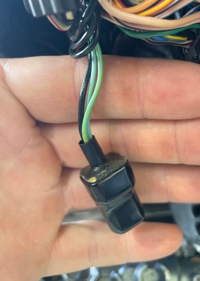

There are two diodes on the 2005 Yamaha F90 tilt/trim wiring. They are located in a small black plastic cup which can be found taped to the vertical section of the main harness trunk that runs just inboard of the fuse cups under the cowling. I believe these diodes are transient voltage suppressor diodes "TVS" that are designed to shunt voltage spikes (which can occur when the tilt/trim relay opens and closes) to ground which protects the ecu from voltage spikes. The OEM Yamaha solution is very compact and the two diodes rest on a small circuit board which are connected to ground on the back of the board. After removing the silicone you could see where one of the wires to ground was burnt and interestingly the diode for the trim out (blue) tilt/trim registered no resistance with a multi meter while the trim in (green) side diode had measurable resistance. This matched my symptoms of having normal trim in function but no trim out at either switch and 12v+ at each end of the tilt/trim relay output when trim out (blue) circuit was engaged. Essentially the diodes are connected together, then connected to a common ground. The path to ground was burnt after the two diodes merge, and the trim out (blue) diode had broken down and offered no resistance which allows it to pass 12v+ straight to trim in (green) diode when power was applied to the trim out circuit.

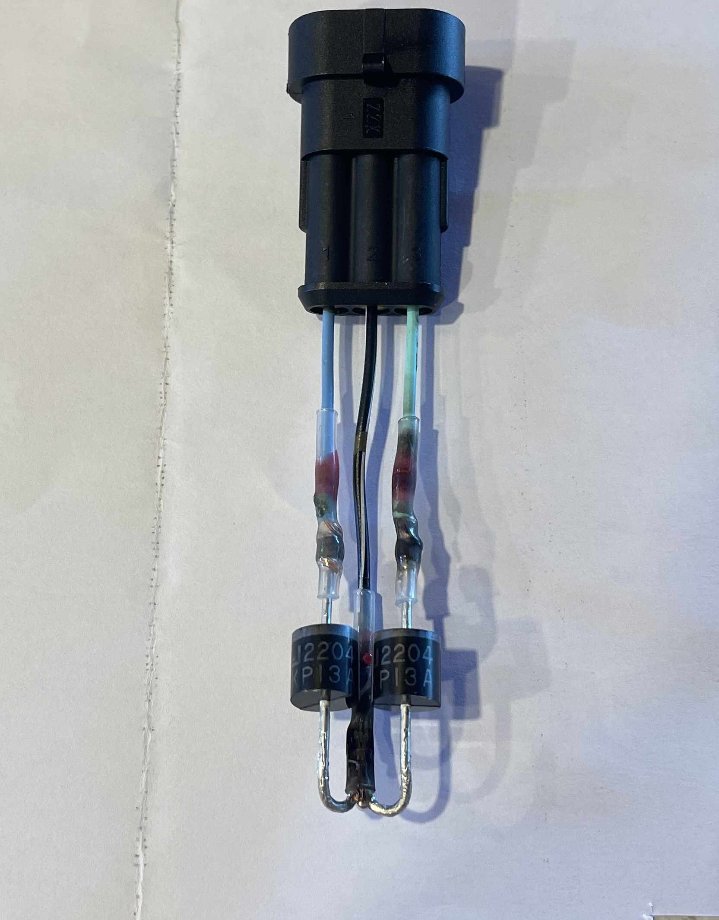

**Disclaimer proceed at your own risk and do your own research. I am a DIY hack with no formal knowledge or experience. I can not recommend doing this work on your boat and am posting this as an interest piece only. I performed this work on my own boat as the other option was to buy a new harness which I did not want to do. I would recommend taking your boat to a qualified professional which is undoubtedly smarter (and faster) than doing all the research and work yourself...**
My current solution was to wire two TVS diodes into a small harness which connects to the main harness where I cut the OEM diode back off. It is three wires blue, green and black. It is difficult to find TVS diodes with a narrow working and clamping range so I settled on the ones below which have a working load around 13v, max breakdown of 15v and full clamping load around 21v. The full clamp is higher than I would like but the next smaller diode (5KP12A) risks partial clamp when running full rpm and full charge while adjusting tilt/trim.
The tilt/trim does work with the OEM unit simply cut off but I didn't want to run the boat for too long without voltage protection for the ecu. I purchased several TVS diodes from Digi-key.com, I ended up using two from a company "Little fuse" the model was;
5KP13A
5KP13ACT-ND
TVS DIODE 13VWM 21.5VC P600
I have attached a couple pictures below. It ended up bulky but has worked for me for the last couple months of the season. I did purchase some different size diodes to try if these fail. I will follow up with this post if I end up modifying this setup or if it goes pear shaped...
