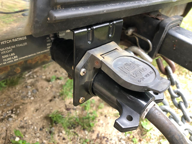

For the past 16-years the new trailer wiring and the revised GMC truck wiring have worked flawlessly, but in Spring 2024 I realized that the bracket that holds the 7-pole receptacle on the bumper of the truck was badly rusted, and the connector was being held in place by only a small sliver of rusty steel.
Because the wiring and the connector in the truck were working just fine, I decided not to tear into them and replace them, so I decided to just replace the rusted and weakened bracket. A new bracket was only $5, and it looked like a simple job.
The first step was getting the bracket off the bumper. I (re-)discovered that I had wisely used all stainless-steel machine screws to mount the bracket, I had drilled and tapped the bumper, and even added stainless-steel elastic-stop nuts as a back-up and to prevent vibration from loosening the machine screws. The only complication was the back side of the chromed bumper had accumulated a layer of rust, and that made getting an 7/32-inch open-end wrench on the elastic stop nuts a bit difficult.

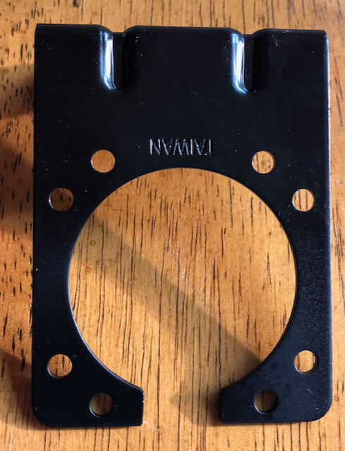

The next complication was the connector mounting bracket fits behind the connector flange, and the connector and wiring bundle are more or less captive in the bracket. The solution was going to be simple: just cut the existing bracket and bend it out of the way; a minute with a Dremel tool and a cut-off disc attachment and the rusted steel was cut open and bent out of the way.
To my very happy surprise, the holes in the new connector mounting bracket aligned perfectly with the holes I drilled in the bumper and the hole layout on the old new bracket also fit perfectly with the old connector. Who knew there was such standardization in 7-pole connectors and their mounting brackets?
The final step was to take the Dremel tool cut-off disc to the new mounting bracket, and remove enough of the bottom part of the bracket that it could slip over the wire bundle. Of course, that exposed some bare steel, so I had to paint that part of the bracket with some Rust-Oleum flat black primer and paint. This added a day's delay in the refurbishment. The reason for doing this was to avoid having to disassemble the existing connector, remove all the wires and their connections to the contacts, then run the wiring though the hole in the bracket, remake all the connections (which would mean carefully following the wire-insulation-color to pin-assignment mapping necessary to get it wired right, then reassembling the connector. The actual connector was working fine, and I did not want to create a new problem by having to tear it apart, redo all the wire-to-contact connections, and put the connector back together. I figured that if was working fine, why invite problems by taking it apart.
The next morning I mounted the newly-cut and newly-painted bracket onto the bumper, slid the wire bundle through the gap, and fastened the connector to the bracket. There I again re-used the stainless-steel machine screws and stainless steel elastic stop nuts from 2008, which were all essentially completely free of rust. I do not think the cutting away of part of the bracket where it surrounds the connector has compromised its strength or durability. In manufacturing the bracket, it was probably simpler and better to leave material all around the large circular cut-out during fabrication of the large diameter hole.
The total cost of the refurbishment was $5 for the new bracket. The bracket was made by CURT and was their part 58510.
In retrospect, I was surprised the old bracket became so rusted. Its appearance showed it was probably made with plain steel that was dipped in a rubberizing compound. Eventually some water got though the rubber coating and started the steel rusting, and 16-years later the entire bracket was badly thinned rusted steel with a strange rubber jacket surround that was mostly separated from the steel and only loosely held in place.
