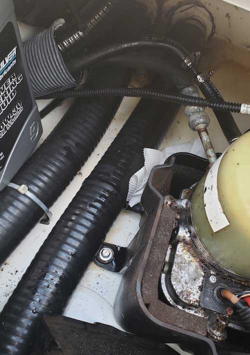

The VERADO power steering on my 210 OUTRAGE was acting funny. I checked the power steering reservoir, and it was almost empty. I returned to the dock. I found a pinhole leak in the metal pipe on the fitting for the power steering pressure line.
Fig. 1. The pinhole leak is at the rusted area of the tube. Leaked fluid is everywhere.
I'm not sure if the fitting can be fixed or replaced, but I am considering that this hose may need to be replaced. According to the Boston Whaler diagram, this is an 18' [18-foot] hose. At the back of the boat, the hose enters a rigging tube along with the return line.
Q1: has any forum reader had to change this hose?
Q2: what level of [difficulty] will this project be?
I expect the two hoses are tied together in the rigging tube, I will probably have to pull them both out; replace the leaking hose; then pull the paired hose back into the rigging tube.
I sure hope someone might have some experience with this problem. The remedy like a real PITA. Any suggestions are appreciated.

The process of removing the power steering hoses was moderately difficult, but do-able for a good backyard mechanic that has access to a hot-tub to soak in after a day of squeezing into awkward positions and tight spaces.
To gain access to the console side of the hoses, I removed the radio (and mounting board) from the port side of the console, the starboard side battery and the forward mounted tackle box. I then removed the four screws that hold the helm in place. Next, there is a boot on the deck of the console which needs to be unscrewed, so you can rip out all the spray foam that seals the steering hoses where the pass through the deck. This is actually a pain in the butt.
Next I removed the two hoses from the helm and let it hang outside the console, while I worked on the pump side of things.
As I mentioned earlier in the thread, this boat was rigged with a steering damper which is attached between the helm and the pump at the pump side. It is virtually impossible to separate the damper from the hose leading forward, so plan to replace both--ouch, another $90. I removed the two pump side hoses and while my assistant held them over a jar, I blew through the hoses from the front to empty them of PS fluid, attempting to control the mess. Next, you will need to locate and cut about a dozen zip ties in the bilge area to release the power steering hoses from other bundles of wires that are held together in a bunch of places.
Pulling the new hoses was a matter of using Gorilla tape to tape the new hoses to the old hoses and pulling the one at a time. This is a two person job, requiring one person the guide and feed the hose from the console, as I pulled (moderately) from the stern. They actually come through farily easy, and lubricating them with a little WD40 helped.
After connecting all the new hoses up to the helm and the pump, I filled the boost pump reservoir. Then I had my assistant start the VERADO, so the pump would activate. As the fluid pumped into the empty hose, I kept adding fluid to the reservoir, keeping it topped off. This process appears to have bled off all the air in the system as far as I can tell. After running, I topped off for a few minutes, I turned the helm port and starboard a few times. Very smooth, no noise and no air bubbles appeared in the tank.
I believe this job is complete now, except for having to clean up a real mess of hydraulic fluid in the bilge.
