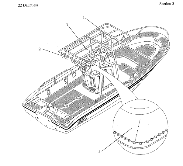

Page 41 of the owner's manual shows the T-top but does not give dimensions. I guess I would try Boston Whaler customer service again--I am positive they had detailed engineering drawings when the boat was built and based on the responses that I have received, it appears that they archive everything.

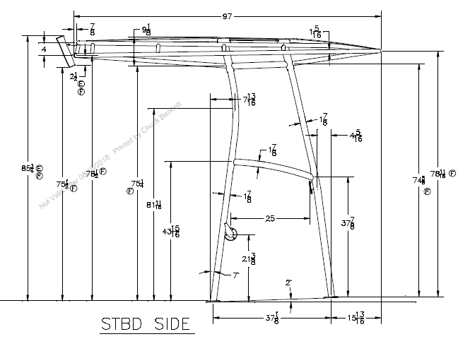

This might help as well and is also from Boston Whaler literature.
Re: 220 Dauntless Factory T Top dimensions
That is fantastic, how did you find the t top dimensions? I could not find it in the document library.
The legs on the Atlantic top are 33" on center, so maybe with careful placement, I can grab both mounting plates.

I am going through the same process as you (albeit very slowly)--updating a 220 Dauntless. I emailed Whaler and they sent me the drawings and owner's manual. Turnaround time was less than a day in both cases.

The drawings were for a 2004 model year Dauntless 22.

Thanks, Padrefigure, I was able to locate and tap those [reinforced deck] areas even though my T-top mounting legs were a little closer together.
