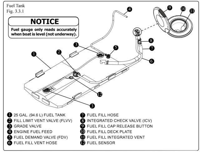

Also take a look at the vent. It could be clogged or slightly blocked. If you can access the inside of the fitting, remove the hose from the vent fitting and run a snake through.
This diagram is from your owner's manual, as you can see if you have a relatively full tank and your bow is up, your vent (amidships) can be blocked.

Phil T wrote:This diagram is from your owner's manual...
PHIL--thank you for finding the fuel tank pictorial drawing from Boston Whaler for the 170 MONTAUK and posting it in your reply. The diagram is very useful and quite surprising.
If I am properly inferring the orientation of the fuel tank in the boat hull, it appears that the fuel filler inlet is located at the aft end of the fuel tank. Is that the actual orientation?

Postby Phil T » Sat Sep 14, 2019 9:46 am
The tank diagram orientation is upper right is the stern, lower left is the bow.
The vent hose is the smaller one that connects to the middle of the tank.
Note item 11, the vent flap in the fitting.

PHIL--thanks for confirming the orientation of the fuel tank in the 170 MONTAUK puts the filler inlet at the aft end of the tank.
The static trim for a boat with an outboard engine on a transom is usually to be down-by-the-stern, due to the weight of the outboard engine being so far aft of the hull center.
If fuel is being added to a fuel tank on a boat that has a static trim down by the stern and the fuel tank filler inlet is at the aft end of the tank, the level of fuel in the aft end of the tank will be higher than the forward end. As the fuel level increases toward a full tank, there will be no flow of fuel into the tank at some point, and additional fuel will begin to back up in the filler tube.
Another influence on static boat trim during fueling might be someone standing in the stern of the boat holding the dispensing pump handle and hose (or a portable tank), and their weight (and the weight of the portable fuel tank they are holding) further adds to the boat's trim being down by the stern.
The best way to overcome this problem is to alter the static trim of the boat during fueling so that the boat sits on a perfectly level trim or sits slightly down-by-the bow.
The fuel tank system is quite complex, as it includes an upper level hose running from the aft end to the bow end of the tank. This is denoted in the drawing as callout number 3 and labeled "GRADE VALVE."
My inference for the function of the two devices called a GRADE VALVE is they permit fuel to flow via the external hose from one end of the fuel tank to the other end when the boat is on the trailer and the trailer is ascending or descending a highway grade or a boat launch ramp grade.
The grade valves and the hose connecting them permit fuel to move from one end of the tank to the other when the tank is partially full and the boat is inclined at some rather steep angle as might occur while on the trailer--or even underway if in really big seas.
The grade valves should also help during fueling by providing a path for fuel to flow into the forward part of the tank when the boat is trimmed down by the stern.
The vent location in the center of the tank will work best when the trim on the boat is precisely level, as any tilt to bow or stern will tend to cause fuel in the tank to cover the vent.

Phil T wrote:The integrated vent is due in part to EPA regs as well as economics.
The integral vent in the filler cap also has another influence: the elimination of a rather large diameter hole in the Unibond hull to accommodate the fuel vent fitting results in a improvement in the structure and rigidity of the hull.
Owners of older classic-era boats may be surprised to see how much of the Unibond hull is cut away on the inboard side of the external fuel vent fitting. This was done because the vent fitting was not long enough to pass through the entire thickness of the Unibond hull, and a relief is cut on the inboard side so the fitting can be fixed in place to just a small thickness of the original hull.
As I recall there was a problem with certain boats--the OUTRAGE 25 hull if I remember correctly--with the hull having insufficient stiffness and strength at the location of the filler and vent hoses. Boston Whaler was providing repairs to those hulls which had developed hull cracks in those areas.
On that basis the elimination of the open-air vent on the hull sides can be considered a modification that improves the hull strength and integrity. This is another contradiction of the assertion that Boston Whaler eliminated those vents to be "cheap."
