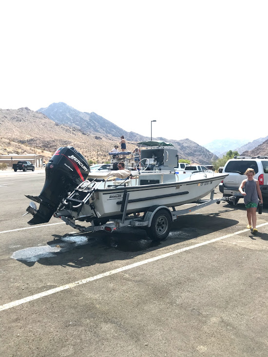

Postby pcrussell50 » Fri Aug 14, 2020 12:20 am
As summer draws to a close, another 15 hours or so on the carburetor 2000 Mercury 90 FourStroke. It continues to behave as if it were fuel injected. Starts quickly and easily without a choke. Runs smoothly and smoke free or so little it's hard to notice, sips fuel in comparison to my two stroke-cycle engines. Just turn the key and go. Amazing. Other than being HUGE and HEAVY for my Alert 17 (Special Service classic Montauk), it's a delight.
Look how big this motor is:
gray whale at willow 2020.jpg (127.99 KiB) Viewed 55761 times
Now, I do drain the carburetors after the main boating season at the end of the summer, and keep the battery on a trickle charger. But that's about it. Yes, this is a Yamaha powerhead.
