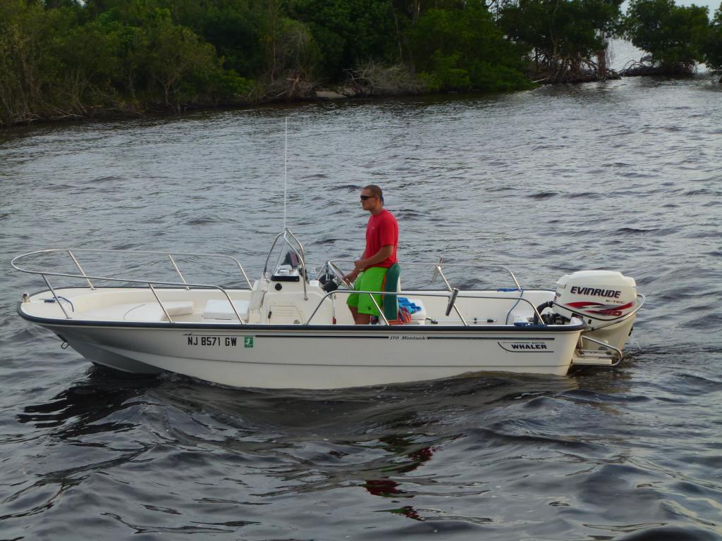

170 Montauk with E-Tec 115HO:

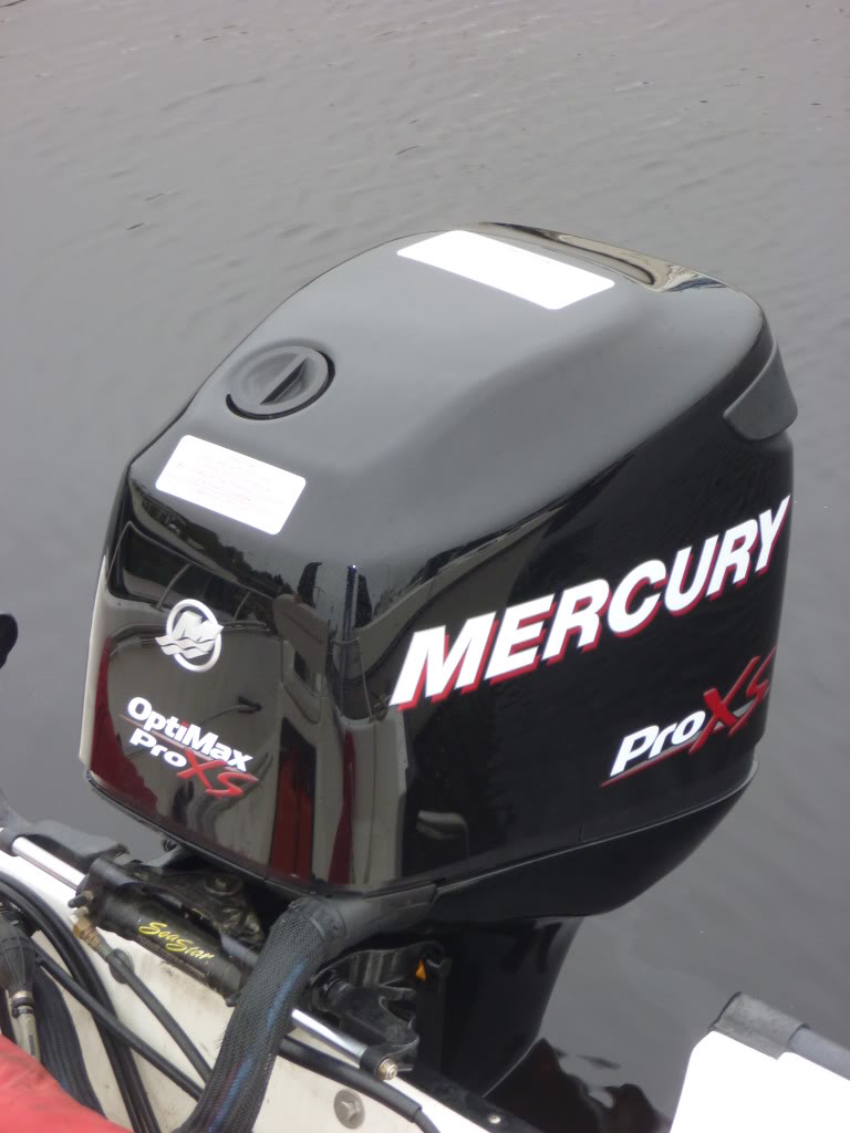

Mercury OptiMax ProXS 115
170 Montauk with Mercury OptiMax ProXS 115

RIDGE--Wow. The Evinrude E-TEC 115 H.O. on the 170 MONTAUK looks great! It looks much less bulky than the stock motor on my friend's boat, and I also like the color match. Do you have any performance data?

There is a lot of info in the old forum about my re-powers. The E-TEC 115 H.O. re-power was done in 2009.
One of my main uses is pulling one or two skiers from deep water starts. (You can see the turbo swing in the [second] picture [above].) When skiing I run a PowerTech 17-pitch or 19-pitch four-blade propeller--depends one or two skiers. Those propellers pull like a freight train.
I did a lot of propeller testing when I first did the re-power with a three-blade 21-pitch propeller. I hit 51.8-MPH via the GPS. I think a 115-HP motor is a very good choice for this boat. Boat US insurance has no concern; a115-HP-rated motor was the most I could insure. By the way, the E-TEC 115 H.O. is dyno tested to be 127-HP.
