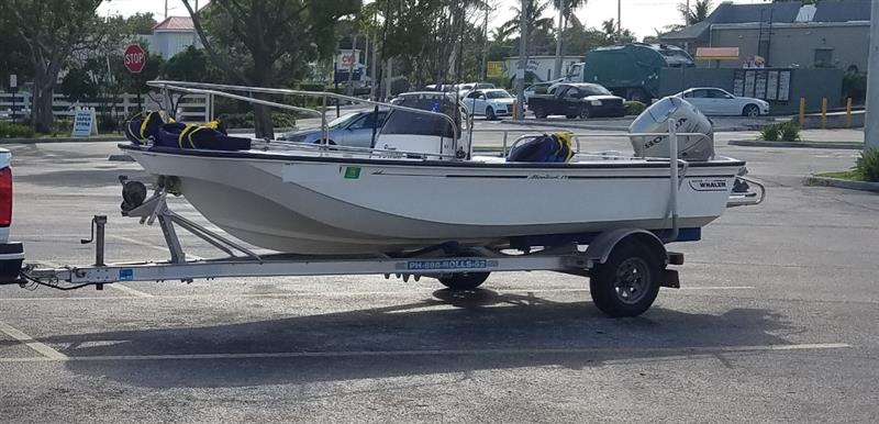

I have a 1996 Montauk 17 on a bunk trailer; it's the only way to go. If you can buy new, get the trailer custom sized for your boat; the cost is not much more. I got my trailer from Rolls Axle in Florida, Model W1730 custom sized to be 80-inches wide at the outside of the fenders, and it fits my Montauk perfectly. With bunks and guide ons, as long as the front of the boat gets between the guides, it doesn't matter what angle the boat will end up dead center.
To make the bunks slippery, rub a brick of parafin wax (from the grocery store) on the bunks and they get very slick. As for fit; the bunks have some adjustment for angle, and, if you need to move them around then at least on an aluminum trailer, you can just poke new holes with a cordless drill, which is what I did. Gto the local ramp, launch the boat, adjust the bunks, then see how it fits. Repeat until you're happy.
The Rolls Axle brand trailer is built like a tank with big aluminum beams, aluminum axle, and stainless steel hubs. After 14 years of saltwater use, there is barely any corrosion on anything, including the hubs. The only drawback is they use rubber blocks for suspension springs, which basically do not move with a boat this light, so it's like not having suspension. I paid $2019 for it in 2005, custom sized to 80-inches wide, and with a removable tongue for security (more difficult to steal your boat if the tongue isn't there). Capacity is 2600-lbs, GVWR is 3000-lbs—way more than a vintage Montauk weighs—and the empty weight is listed as 430-lbs.
