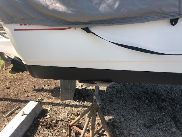

roundle1979
Posts: 95
Joined: Thu Jun 13, 2019 11:10 am
Re: Preparing Nantucket 190 for Saltwater
Postby roundle1979 » Mon Jul 29, 2019 2:17 am
Quick update on paint:
I've had a local pro perform the following:
—Mask off water line
—Clean scum (amazing how quickly it appears)
—Sand gel coat
—Apply two coats epoxy barrier coat
—Apply one coat ablative (blue)
—Apply two coats ablative (black)
The local pro does most of the boats in the area. He said that I should get three seasons out of the job (with some touch-ups).
Paid $65 per foot.
I am waiting on the arrival of the through-hull fittings.
2004 Nantucket 190 w/ Mercury Optimax 135

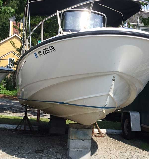

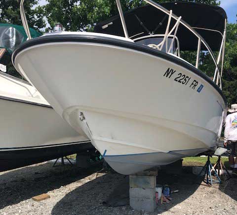

Postby roundle1979 » Fri Aug 16, 2019 1:48 pm
A week in the water produced the scum line.
Here's the 2 coats of epoxy.
Followed by a hard coat (blue) and 2 coats of ablative black.
3 Ablative.jpg (89.61 KiB) Viewed 28136 times
roundle1979
Posts: 95

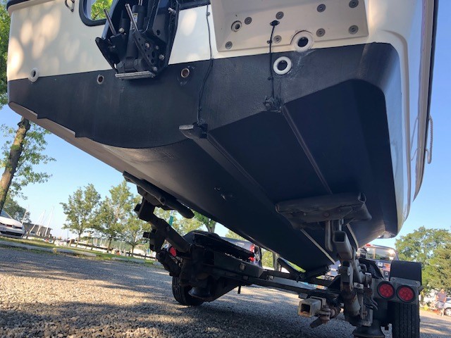

Postby roundle1979 » Fri Aug 16, 2019 1:50 pm
All new through hulls:
4 New through hulls.jpg (92.84 KiB) Viewed 28136 times

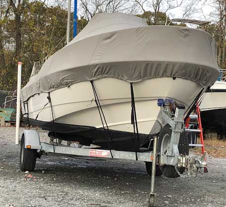

Lifting off the blocks:
5 Almost ready.jpg (116.23 KiB) Viewed 28136 times
Back at the dock:

Postby roundle1979 » Mon Nov 04, 2019 5:47 pm
My 2004 Boston Whaler Nantucket/Outrage 190 came out of the water today (November 4, 2019) for the first time since July. It's been cleaned and encapsulated in a few layers of Collinite No. 925 Marine Wax.
190 NANTUCKET in winter storage trim.
Overall, am impressed with how the bottom paint kept the growth at bay. Since the boat's been in the water I've not done anything to clean the bottom, aside from running the boat at 35-MPH at least once every other week.
The only evidence of growth or barnacles is on a small part of the engine, where it attaches to the transom and remains under water. In hindsight, perhaps I should I have had the underwater outboard mounting bolts prepared for saltwater as per the above.
