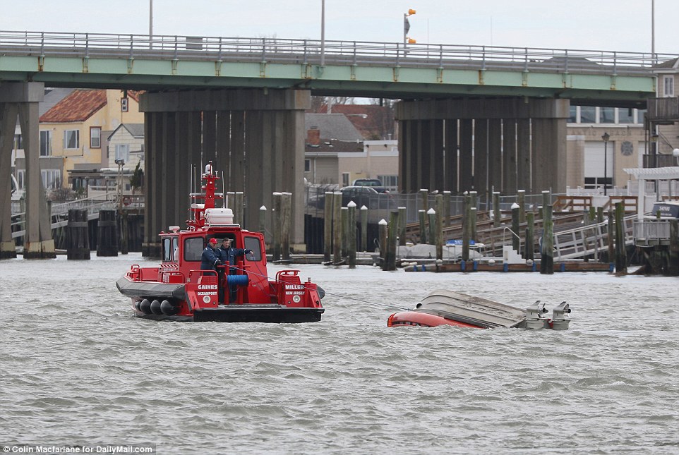

A USCG response boat overturned in the Atlantic Ocean during a rescue attempt on February 25, 2016. The Coast Guard boat was attempting to assist in the rescue of the crew of the fishing vessel CAROLINA QUEEN III, which had become stranded on the beach near the Rockaway peninsula in the New York City burough of Queens. The five Coast Guard crew were able to escape the capsized boat and swim ashore. News reports described the wave height during this time as ten-feet or more.
Capsized USCG 25-foot boat

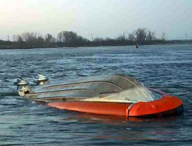

It is somwhat difficult to tell from the image of the capsized boat which model RB-S boat was involved. The (below) image appears to me to show a boat that is more like the older c.2002 Defender class RB-S boats, not the newer RB-S-II class boats.
Capsized USCG 25-foot boat stern view

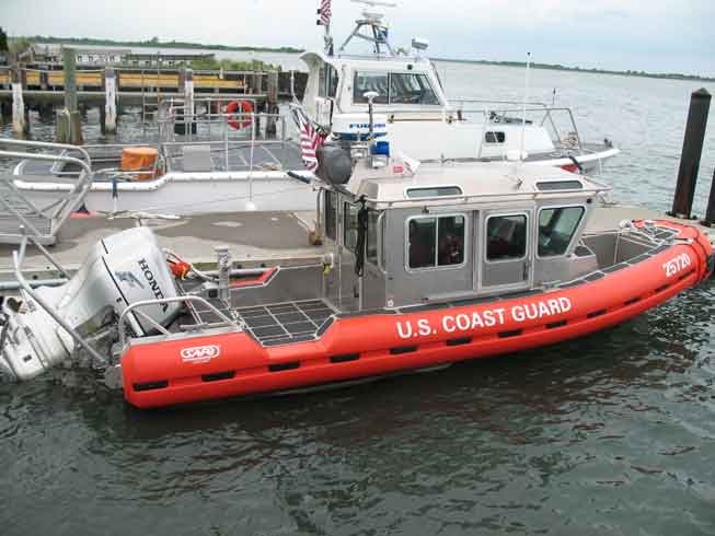

UPDATE: The USCG boat that capsized was from USCG Station Jones Beach and was USCG 25720. All the boat crew are in good condition. The boat is definitely a RB-S Defender class boat. Here is a picture of the boat from the Station Jones Beach webpage:
USCG Boat 25729 Station Jones Beach
A larger image is available.
Note that the newer RB-S-II boats look like their numbering scheme will be 29nnnn, so it will be easy to distinguish the two models from the hull designation number.

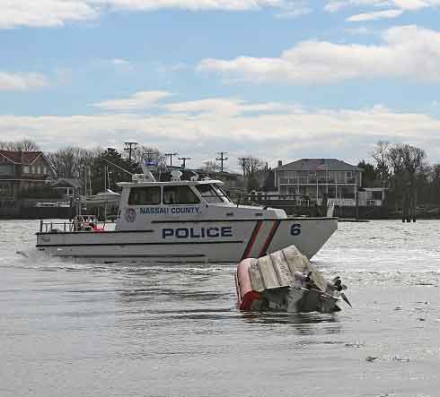

That pic of the submerged hull and the Nassau County PD boat sure looks like Debs Inlet, just West of the Atlantic Beach Bridge. That is my stomping grounds and I have seen that CG boat out on patrol before. Friendly guys, always wave back. I'm glad they are all safe.

Interesting tidbit. The Nassau County LEO's muscled their way in and took over the salvage of the Safeboat from the crew that was hired under a BOA contract with the US government. They did so under the guise of training and took the boat to their facility.
That particular boat was scheduled to be decommissioned in 3-4 weeks.
jimh wrote:Note that the newer RB-S-II boats look like their numbering scheme will be 29nnnn, so it will be easy to distinguish the two models from the hull designation number.
25xxx - 29xxx etc. The first 2 numbers are the boat size
In this picture the 25' boat is sitting alongside a 41UTB (41' utility boat)
