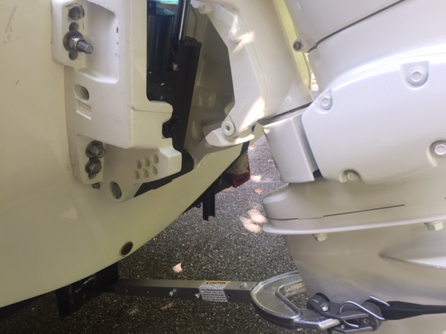

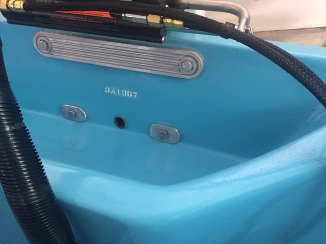

I feel two holes up is the correct height. There is an improvement in performance. Time, more rigorous testing and a new prop should yield more definitive results. I haven't experienced any problems with ventilation during tight turns. With the engine mounted two holes up I was able to through bolt the bottom bolts. In place of washers I made two 1/4" thick backing plates. I plan on removing the lag bolts and filling the holes in the fall. Both the through bolts and the lag bolts are currently installed in the elongated bottom mounting slot of the engine.
Splash Well.jpeg (82.96 KiB) Viewed 18400 times
E-TEC Mounting Bracket.jpeg (87.11 KiB) Viewed 18400 times
Does anyone think I should leave the lag bolts in?
Re: 1970 Sakonnet E-TEC 90
Postby Phil T » Mon Aug 31, 2020 11:58 am
Remove the lag bolts during the off season.
Postby biggiefl » Mon Aug 31, 2020 12:44 pm
It can't hurt but it is 2 more places for possible water intrusion.
PS...ditch the transom saver, not a good idea on Whalers, especially smaller ones.
Postby biggiefl » Mon Aug 31, 2020 2:19 pm
You are taking all the shock from the road to the trailer and reverting it to your lower unit which transmits it to your transom. They work fine for engines without PTnT and need ground clearance or say an aluminum hulled boat. I personally see no need for them on a quality made boat with PTnT. If you can run aground at 40mph and not hurt a Whaler transom, these are useless.
Skip Berry

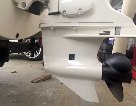

The Evinrude E-TEC does have a Trailering Bracket. I'm not an engineer, but it seems to me it does a great job of supporting the engine when trailered in the up position, but does little to protect the transom from the forces exerted by the moment arm of the raised engine. Bumps on the road when the engine is in the vertical position present a sheer force on the transom. With the engine raised the force of those bumps can be more of a twisting moment that might be more damaging to the transom.
While we are at it, what do you think is an adequate clearance for an engine to be trailered in the vertical position?
Postby biggiefl » Tue Sep 01, 2020 10:18 am
That tiny spring probably does not do much.
Trailers do not have a lot of suspension travel--very minimal. I doubt the engine skeg is more than 10-inches above the ground on my boat trailer.

Postby Skip Berry » Thu Sep 03, 2020 10:39 am
The spring [in a transom saver that has been mentioned above] is actually quite strong. [The spring] is difficult to compress by sliding the two sections of the [transom saver] support together. In use [the spring] is partially compressed by lowering the engine with the power tilt.
