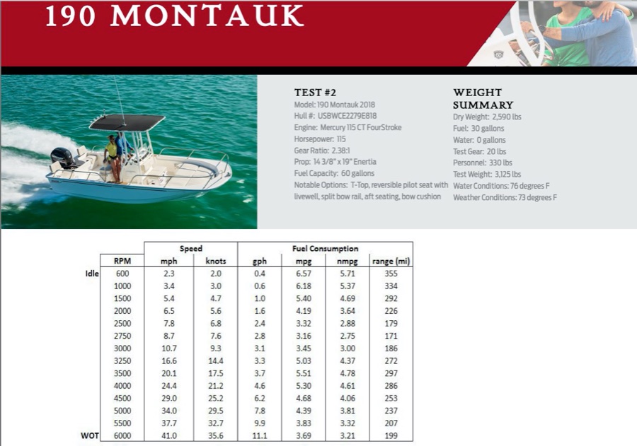

For the sake of an example, let us assume that the 190 MONTAUK boat with engine, fuel, required safety gear, and general accessories might weight about 2,795-lbs. This is a reasonable assumption. It is based on the reported weights from a Boston Whaler boat performance test of the 190 MONTAUK with a 115-HP engine.

Boston Whaler reports the boat with two people at total weight 3,125-lbs can hit 41-MPH. The power to weight ratio for that is 115/3125=0.0368. From this we can calculate a hull factor constant: c = 214.
With this information we can predict how performance will change as more people are added. Let's go for the worst case, there are eight adults on the boat. We have to add seven more people at 180-lbs each, or 1,260-lbs, and add that to the baseline boat weight, 2,975-bs. The boat with eight people should weigh about 4,235-lbs. Now the HP-to-weight ratio becomes smaller:

We can look at this another way. What increase in horsepower would be needed to maintain the boat at 41-MPH with the load of eight passengers? This can also be calculated easily. We just need to maintain the same power-to-weight ratio as before. The 41-MPH boat speed with two aboard occurred with the power-to-weight ratio of 0.0368-HP/lbs. To maintain that ratio at 4,235-lbs of boat and passengers, we need 4235 × 0.0368 = 156-HP.

Whalerdog wrote:A [190 MONTAUK with a 115-HP engine is a] 37-MPH boat with two people...
A Boston Whaler performance report says such a boat makes 41-MPH.
(edit - added performance report)

Also to be noted in the performance report from Boston Whaler on the 190 MONTAUK with 115-HP engine is the inclusion of a T-Top. There is considerable air drag from a T-Top. The effect of air drag increases with an exponential rate with boat speed, which means the presence of a T-Top has the most effect on boat speed at the highest boat speeds.
A T-Top also adds weight to the boat. All added weight reduces speed at all speeds.
On that basis one can quite reasonably assume that were the test boat a 190 MONTAUK without a T-Top, the top boat speed would have been higher than 41-MPH. Let us assume the top speed would increase to 43-MPH.
