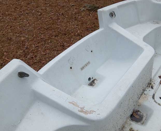

Yes, it definitely has a factory notched transom.
Fig. 1 Notched transom of 13-footer

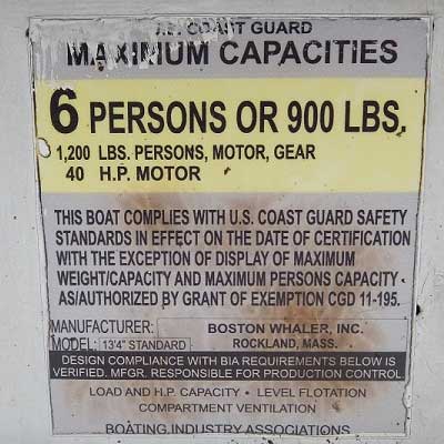

Definitely 40 HP.
Fig. 2. Capacity plate of 13-footer
I remember reading in the Reference section something like "The Standard model was not always listed in the catalog, but could be special ordered." So perhaps my boat was special ordered and this would explain the 15" transom in 1973.

MartinDupre wrote:...it definitely has a factory notched transom
Based on Figure 1 (above) my inference is someone cut down the transom from the original configuration. The notch at the transom line appears to be an almost square cut or right angle. This is quite distinct from catalogue photographs of the original 13-foot hull with notched transom which show a rounded notch at that point. See Figure 3 below:
Fig. 3. A view of the 13-foot hull with notched transom from a Boston Whaler catalogue page. Note the rounded transition to the notch in the transom.
Perhaps the original buyer wanted a 15-inch transom height, and asked the boat be modified. The modification could have been done by the dealer or by the original owner. It is hard to know for certain.
I don't recall seeing any other 13-footers with a sink-style engine splash well and a notched transom. In the Boston Whaler catalogue for 1973 a 13-foot STANDARD model is shown. It does NOT have a notched transom.
A further element in support of the boating being modified after original joining of the hull and deck molds is the re-painting of the deck to blue from its original Desert Tan gel coat.
Another clear clue is the color of the stencil number as seen in Figure 1 and enlarged below:
Fig. 4. Enlargement of stencil number.
This clearly shows the boat was originally molded with a Desert Tan interior. I cannot imagine that Boston Whaler would have molded the boat in Desert Tan and then painted the interior blue at the factory. That seems extremely unlikely.
That blue paint top coat could be concealing scars from the rework of the transom height beneath.
When the blue paint is removed, you should be able to see the joint line between the hull and liner laminates. This joint line should be a green line joint, a unique feature of smaller classic Boston Whaler hulls. If the green line joint is there, the transom cut-down to 15-inch may have been made at the factory. If there is no green line joint, then the cut-down was most likely not made at the factory.
The boat under discussion does seem to be an anomaly.

Well, I do see your point about the rounded corners. The notch just looked like it was factory because I saw no evidence of modification. Perhaps I will know more after I remove the blue paint. The paint is peeling, so I don't think it was a professional job.

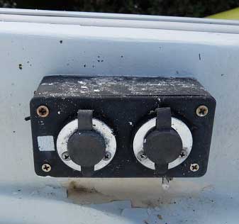

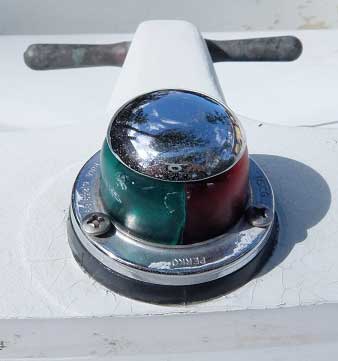

Another observation: the 13-footer has a Perko [combined sidelight lamp at the bow, shown in Figure 6] which is obviously wired internally, and a Perko electrical box near the transom [shown in Figure 7].
Fig. 6. A combined sidelights navigation lamp at the bow.
Fig. 7. An electrical box found near the transom of a 1973 13-footer
Would [either the lamp or the box] be common on a Standard?
Did the Standard come with embedded wiring so you could add [navigation lighting] later?

The box seen in Figure 7 is not something Boston Whaler installed.
The combined sidelight lamp seen in Figure 6 is similar to OEM equipment, but the mounting hardware does not look OEM.
The 1973 catalogue notes the STANDARD 13 included "wiring for lights."

I also sent a picture of the notched transom, and he stated it appeared to be a factory transom.
In the end, I am more or less back to where I started, with a mystery of how it says Standard model and 40 HP on the capacity plate, and has a 15" transom when by date it should be 20".
In any case, I am going to restore it as a Standard (already ordered the wood), and consider myself lucky that I am not limited to 20 HP in motor choices.
