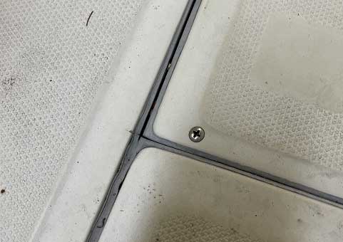

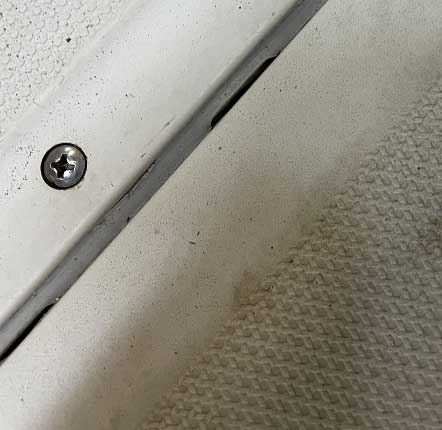

What caulk should be used to reseal [joints between panels on] the deck on a 1990 19 OUTRAGE?
Fig. 1. Gray caulk on 1990 OUTRAGE 19. Whether this gray caulk is the OEM original caulk is not known.
Fig. 2. Gray caulk on 1990 OUTRAGE 19
I plan to remove the old caulk and put down a new seal. From what I can tell, if [the old caulk] were silicone, I should stick with silicone.

While your deck appears white, it is actually Desert Tan color.
You should detail the deck to remove the mold, oxidation, and residue prior to installing the sealant.
OSI Quad color #450 is a color match to the gel coat.
Take a look at this prior discussion:
http://continuouswave.com/forum/viewtopic.php?f=6&t=5551
OSI Quad color #450 is not carried in many stores. I ordered OSI Quad color #450 on-line for delivery to my local Home Depot.

I do not recall seeing a Boston Whaler boat in which the caulk used between deck panels was in a contrasting color to the deck panels. On that basis, I suspect that the caulk on the c.1990 OUTRAGE boat seen above in Figures 1 and 2 is not the original caulk.
The gel coat color is probably Desert Tan, although the deck has some dirt on it as seen in Figures 1 and 2, and judging color hue is always difficult from photographic images due to the effect on color perception by the illuminating light.
If the gray caulk now on the boat were silicone, I would expect that it would allow the old beads to be peeled away from the gel coat surfaces in long and elastic strings. The human thumb nail is often a scraping tool of the perfect hardness to remove silicone caulk from gel coat without causing marks in the gel coat surface.
Whether only a silicone caulk MUST be used to replace a prior silicone remains to be establish.
As a general rule when replacing old caulk that has become inflexible and cracked, removal of all the old caulk in preferred before new caulk is applied, and particularly when the new caulk may be of a different formulation than the old caulk. A thorough cleaning, washing, and drying of the joint surfaces before applying new caulk ought to prevent any problems if there were an incompatibility between the new caulk and existing caulk that is to be replaced.

The notion that color #450 is the best match to Desert Tan seems presumptive. There are several other hues that are very close matches. It may be that color #450 is most easily ordered.

However, that said, I am very confident that color #450 is going to be a much better match than the gray sealant shown in the illustrations above.
