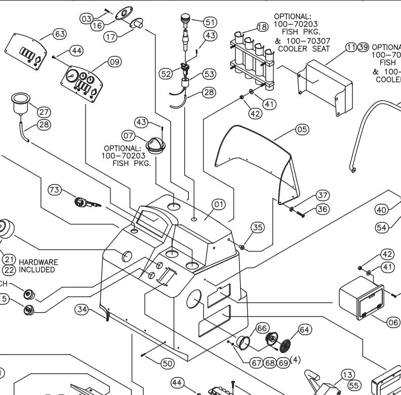

I did a little research on Whaler's Resources page of their website.
For 2005, Montauk 170 there are two instrument panels shown:
Fig. 1.
Screen Shot 2021-04-11 at 1.35.23 PM.jpg (104 KiB) Viewed 11450 times
There are parts # 09 and #63, described as:
Fig. 2.

Re: 170 Montauk instrument panel replacement
Postby bmat5 » Sun Apr 11, 2021 1:52 pm
Thanks Phil, this is the same illustration that I found. I assume my panel was a "one off" some how. It's OEM for certain, with that fifth gang for a stereo switch. I will photo later.

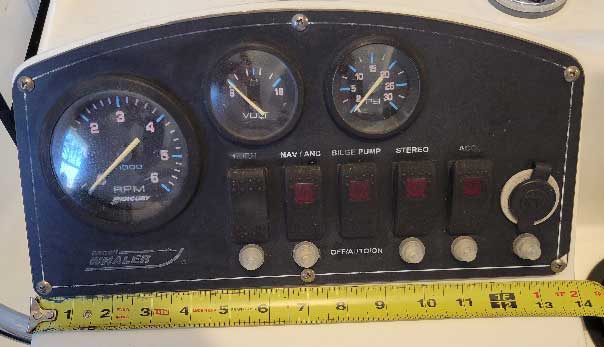

Postby bmat5 » Sun Apr 11, 2021 2:48 pm
Fig. 3. The OEM panel now on the boat under discussion.
Postby Phil T » Sun Apr 11, 2021 2:54 pm
While not exactly what you are thinking, consider this.
You can use the existing panel and cover it with 3M Vinyl. Replace the switch "covers" with labels.
Several owners have "refreshed" their panel without spending the $$.
New Wire Marine sells switches and covers at reasonable prices.
https://newwiremarine.com/marine-grade-switches/

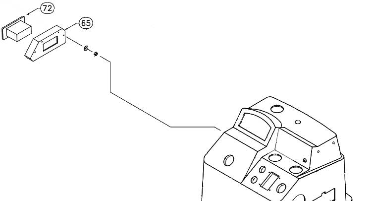

As a side note to your [i.e., BMAT5's] comment about a factory stereo audio amplifier option not being available: indeed there was an option for a factory installed stereo audio amplifier.
A specialized KING StarBoard mounting bracket (Callout 65) was installed behind the console door to hold the stereo audio amplifier (Callout 72). See the diagram below.
Excerpt from Boston Whaler drawing; the location of a bracket and audio amplifier for a 170 MONTAUK are shown. Callout 65 is the bracket and Callout 72 is the amplifier.
On my 170 Montauk boat there is a stereo audio amplifier installed as shown above on the console.
