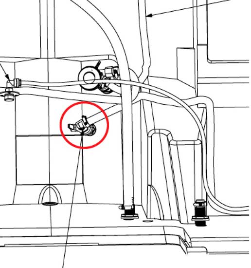

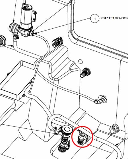

Unless advised otherwise, I plan on installing the through-hull water for a water pick-up in the factory location shown on an old drawing I came across for a 210 Montauk, shown in Figures 1 and 2 below.
Fig. 1. Excerpt from Boston Whaler drawing with circled location for a through-hull fitting for raw water pickup.
Fig. 2. Excerpt from Boston Whaler drawing with circled location for a through-hull fitting for raw water pickup.

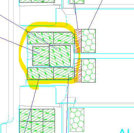

Peter inquired with Boston Whaler regarding the location of a putty box. He received the following reply and attachements which he sent to me. I have extracted the image files and the text, which I reproduce below:
BostonWhalerCustomerServiceRepresentative wrote:...while we no longer use putty boxes...the area you are looking at should be solid. [Figure 3 below shows] a layer of putty that is applied to the boat before we close the molds...
Fig. 3. View of the underside of the liner molded part showing where putty is applied.

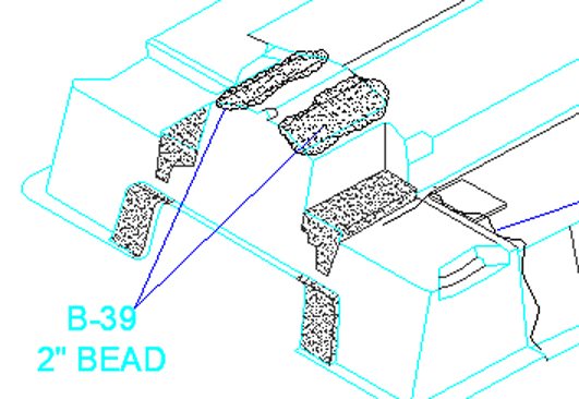

BostonWhalerCustomerServiceRepresentative wrote:...and [Figure 4 below] shows the location of the [PENSKE] board. [PENSKE] board is not wood or phenolic, but a rigid fiber reinforced compressed foam. You should be good to install a thru hull in this location. Just note that if this is not done at a Boston whaler dealer, you will void your 10-year-hull warranty.
Fig. 4. View of the inside of the hull molded part showing where reinforcement material is applied.
Also worth remarking: as I noted above, modification to the hull bottom such as making a large diameter hole through the hull is something at will void the 10-year-hull warranty as was explicitly noted in the reply from Boston Whaler, unless the installation is done by an authorized Boston Whaler dealer. This is something to consider if planning modifications like the one being discussed here.
