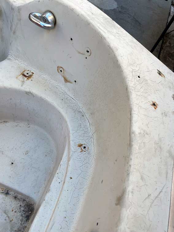

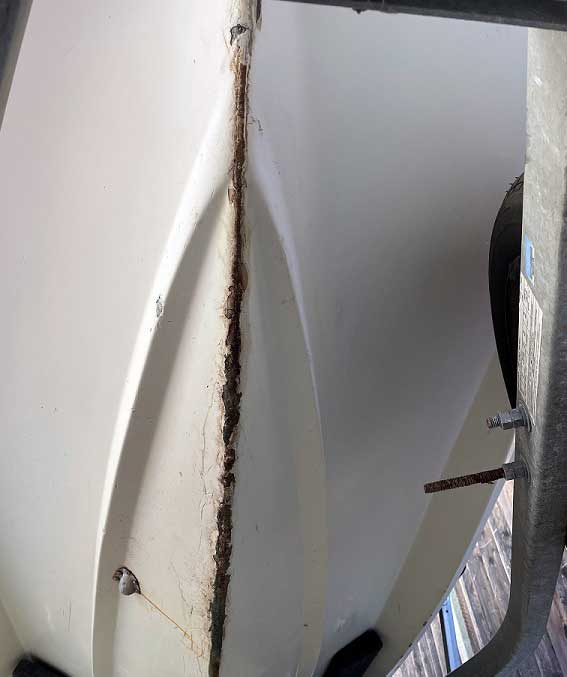

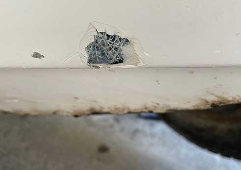

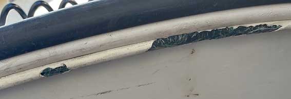

My 1978 SPORT 15 boat has many problems. The gel coat and laminate layers are damaged in several places. Sections of the gel coat deck have spider cracks and crazing.

Fig. 1. Damage on keel.
Fig. 2. Large area with chipped-off gel coat exposing laminate.
Fig. 3. Typical spider cracking, crazing, and numerous drilled holes in deck.
Fig. 4. Impact damage below rub rail.

When large surfaces of the deck have crazing and spider cracking as seen in Figure 3, the repair of the cracks on an individual basis will be impossible.
The gel coat layer is thin. You cannot sand away the cracks and crazing without sanding away most of the gel coat layer.
The damage to the hull keel area and smaller areas with impact damage on the hull as seen in Figures 1, 2, and 4 can be repaired and top coated with gel coat resin that matches the original.
To learn more about how to repair a Boston Whaler Unibond hull, read these three articles for comprehension:
The Epoxy Cure
Minor Repairs With Epoxy
https://continuouswave.com/whaler/reference/whalerRepair.html
Boston Whaler Factory Instructions
Hull Patch Kits
https://continuouswave.com/whaler/reference/repairInstructions.html
You probably can restore the outside and bottom of the hull with those methods.
Because of the extensive cracking and crazing of the gel coat in the cockpit areas, repair using gel coat on individual cracks will not be practical. The entire deck area will probably need to be sanded to a firm base, faired, and then top coating. This process is shown in an excellent motion picture presentation. Watch the method at
Boston Whaler Crazing Repair
https://www.youtube.com/watch?v=pUOlWPvgLfQ
In the demonstration, the deck is refinished in blue, but any color can be used.
Unless you have expert knowledge and experience in spraying gel coat resin onto large areas of a boat hull outside of a the layup mold, I would be cautious about using gel coat as the top coat for resurfacing the deck. Also, you will lose the non-skid pattern.

Damage in photos 1,2 and 4 can be repaired with Locktite Marine Epoxy or Marine Tex patch repair kit.
The fine small cracks in photo 3 are typical spider cracks that are superficial and do not need attention. If you detail the boat after repairs with heavy cut compound, the cracks will not be as prominent.

Just looking at the deck surfaces in Figure 3, the spider cracks do not look very deep. The spider cracks occur with shrinkage of the gel coat due to failure to maintain the gel coat properly. Gel coat needs to be protected against continual UV exposure, against weathering, and against becoming too dry. For advice on gel coat care, see

Understand the small hairline cracks shown in photo 3 are purely cosmetic. If you want them to not be seen, you have will need to grind off all the gelcoat.
If the interior is anything like the photos you sent and you don't want any cracks you are looking at 40 to 60 hours of grinding, filling, and fairing to prepare the interior for paint or gelcoat. A professional shop would charge about $5,000 to $7,000 to strip and paint the interior of the hull.
