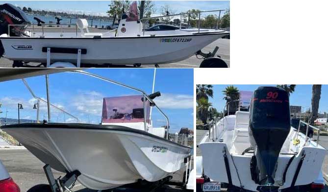

The [single five-digit number] in the splashwell [is] 36242 [as there are not multiple five-digit numbers as previously described].
Fig. 1. A boat to be identified from these pictures.
[Moderator's note: cropped three images to show just the boat that is to be identified; created a new image with the three views.]

Postby jimh » Fri May 13, 2022 11:53 am
freddie wrote:How old is my Boston Whaler boat?
The boat is 55-years old.
The boat shown in Figure 1 has a Boston Whaler 16-foot hull that pre-dates 1972. From the stencil number 36242 in the splashwell and from reading the REFERENCE article about this hull at
https://continuouswave.com/whaler/reference/16-17/
you can deduce the approximate year of manufacture to be 1967 by comparing the five-digit number to the range of stencil numbers according to year of production that are listed in a table in the article.
The original interior seems to be completely missing, so this boat has lost any identity as a particular Boston Whaler model. This boat is classified as a c.1967 pre-Smirk 16-foot hull that has been converted into a custom center console by some unknown fabricator. About all that remains of the original boat are the hull and the bow railing. The side railings are NOT original to the boat. The boat is no longer in its original configuration.
