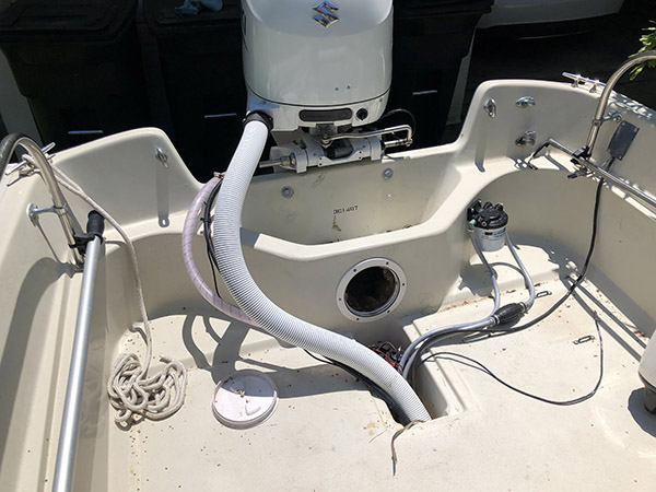

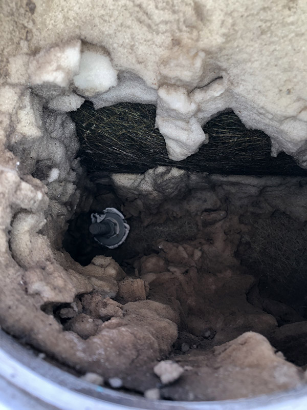

ddqarch
Posts: 19
Joined: Thu Oct 14, 2021 7:49 pm
Re: 1985 Montauk 17: Splash Well has Access Plate
Postby ddqarch » Wed Jun 01, 2022 8:25 am
All the comments you have provided have been very helpful, and I have had two phone conversations with Phil T that really clarified my path forward. I plan to undo some of the damage done to the boat before I got it. In Winter 2022-2023 I will:
  • raise the motor to two-holes down [--must mean two holes up]
  • remove the existing lower thru-bolts and put new ones above the splash well
  • plug and repair the holes from the existing lower bolts
  • fill the void with "4-lbs density" expanding foam, and
  • repair the hole put in for the access cover.
Fig. 1. The location of the circular deck access plate is shown.
Fig. 2. Close up of the engine mounting bolts that can be access via the circular access plate.
Postby jimh » Wed Jun 01, 2022 11:29 am
As seen in Figure 2 above, you should reverse the direction of the lower engine mounting bolts so the nuts are on the engine side of the transom. Putting the bolts on the engine side of the transom will make it much easier to remove the engine from the transom, as might be done when changing engine mounting height or changing to a new engine.
Postby jimh » Wed Jun 01, 2022 11:31 am
Figure 1 reveals the deck access plate to be in a much different position than expected. I would have never thought of putting the access plate there. It does have the advantage of not cutting a hole in the bottom of the engine splash well; that prevents water sitting in the engine splash well leaking into the void.
The person who fabricated that hole certainly removed a lot more foam than necessary to get to the mounting bolts.
As for repairing that large circular hole, you may want to consider just leaving the circular access plate in place. To repair the hole with laminate and gel coat resin will need very skillful work.
Postby jimh » Wed Jun 01, 2022 11:46 am
Have you measured the location of the existing holes in the transom to see if they conform to the BIA hole layout?
ddqarch
Posts: 19
Postby ddqarch » Wed Jun 08, 2022 8:45 am
Jim and Phil: the top bolt [holes] are [located] according to the BIA layout, about 1-7/8-inch down from top of transom
Postby Phil T » Wed Jun 08, 2022 11:30 am
That is the BIA standard measurement. Good.
