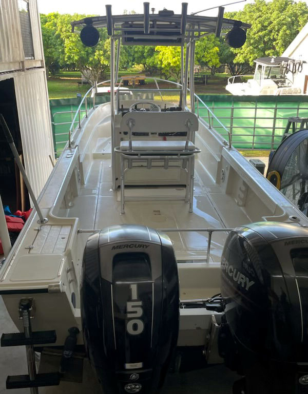

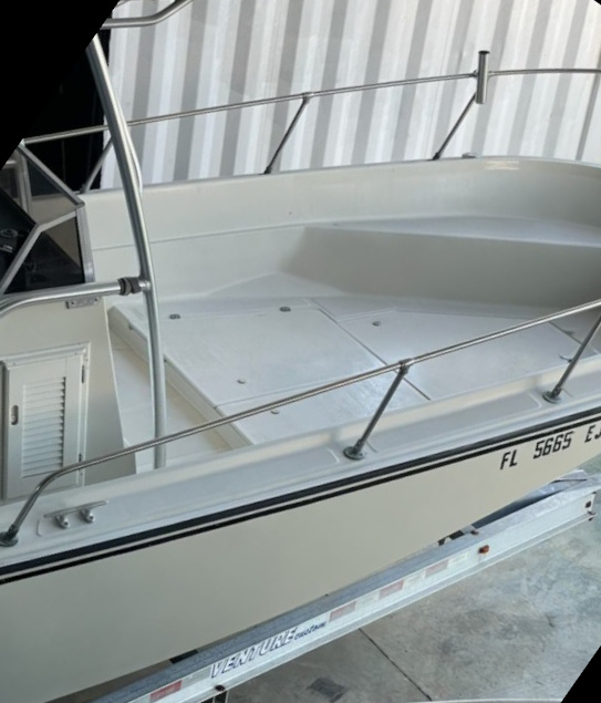

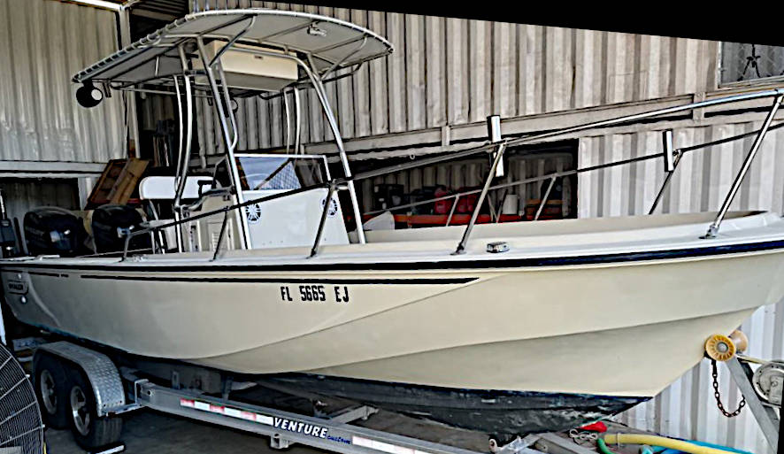

Fig. 1. View of the foredeck of the OUTRAGE 25 converted from a CUDDY model.
Fig. 2. View of the OUTRAGE 25 converted from CUDDY model.
Fig. 3. View of the OUTRAGE 25 converted from a CUDDY model.

Q1: is the door [seen in Figure 1 above] made from KING StarBoard?
Also, I would like to see how the boat looked right after the cuddy was removed.

Overall from the limited views that I can see of the boat, I give this modification to an OUTRAGE 25 from an OUTRAGE 25 CUDDY high marks. However, I can't see any details of how vestiges of the removed cuddy cabin (such as screw fastener holes or adhesive putty) were handled.
On the foredeck of an original OUTRAGE 25 there would have been several hatch openings. These covers were removed in the CUDDY model, and apparently new hatch covers have been created in this conversion. To know more details about the construction of the new foredeck hatch covers would be very useful information, particularly for anyone thinking about performing the same changes to an OUTRAGE 25 CUDDY.
The console appears to be the SUPER CONSOLE option. Please confirm or contradict.
Q2: was the T-Top already on the OUTRAGE 25 CUDDY?
Q3: was the leaning post already on the OUTRAGE 25 CUDDY?
Q4: in your plan to add a "bracket" for the engines on the notched transom, do you plan to then eliminate the notched transom and create a full-transom stern?
