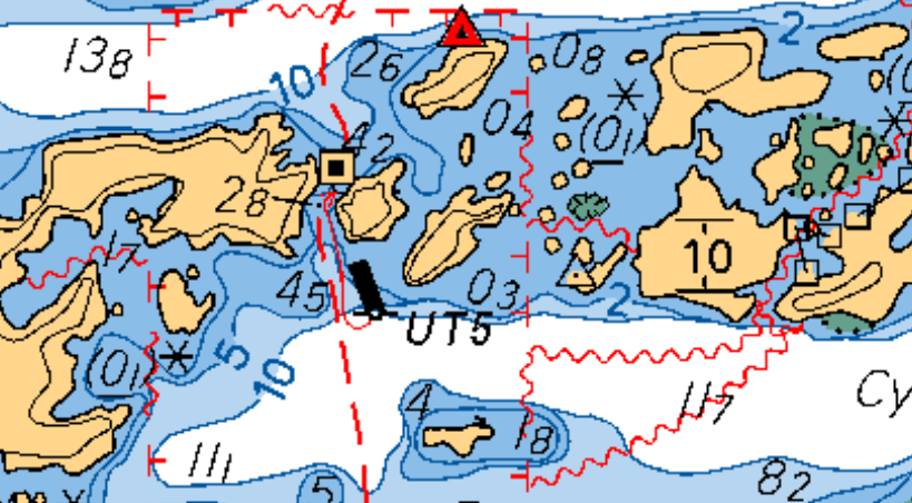

Here is a screen-grab of the Canadian Hydrographic Service electronic chart 2207 that shows aid to navigation UT5 in the Bay of Islands:
The edition of the chart corrected through c.2010. You have to pay close attention: there is a red line with an arrow head that indicates the location of the buoy. It is not at the location shown on the chart, but it is at the tip of the arrow head of the red line. That puts it right where John's video shows it to be.
The daymark and a floating aid are marking the same side of the lateral channel. There must be a shoal between the daymark and the floating aid. The proper channel was to Port (in your video), leaving the green UT5 to Starboard. As always, it pays to go slowly.
jimh posted 08-26-2014 12:18 PM ET (US)     Profile for jimh  Send Email to jimh
The cause of the problem in the NAVIONICS chart is their use of the location of UT5 as depicted on the CHS chart, but Navionics failed to take note of the red line and arrow head that moves the location of UT5 into that narrow passage.
It would be a good idea to send an error report to Navionics to notify them of their error.
Also, I checked my Navionics chart on my HDS-8 plotter: it has UT5 in the wrong place, too. It also fails to show the center island in the passage.

The Garmin shows UT5 in the correct position but the day mark is to far north and the rock it is sitting on is not on the chart.
My paper chart looks the same as Jims shown above. The day mark symbol obscures the passage and the rock in the narrow channel and blocks your view of the small craft rout.
Notice that the dashed red line (the preferred small craft rout) is on the wrong side of UT5 on all the charts.

I don't understand the Garmin chart depiction of the UT5 floating aid. It appears as a YELLOW SPAR with a RED horizontal band. In reality, UT5 is a green CAN.

My chart plotter tells me the Small Craft rout is to the right of the day mark but does not show the rock. The day mark tells me the path is to the left. The buoy tells me to ignore the day-mark and go to the left of the buoy. But my eye says the channel is very thin to the left of the buoy, but the river guy in me is suspicious that the channel is actually to the right of the buoy because the shore above drops off sharply on the Left and is gradual on the right.
While my paper chart does not show the buoy at this location(I see now that Jim has pointed out the red line and arrow that it does). And the Day mark symbol blocks out the entire channel making the paper chart useless.

It really bothers me that the preferred rout is shown on every chart, paper or electronic on the wrong side of UT5.
I would have been much better off if I did not have that dotted red line telling me I was going the wrong way. It is hard to just ignore that line.

jimh posted 08-29-2014 12:32 AM ET (US)     Profile for jimh  Send Email to jimh
In John's video, he should have steered left and taken UT5 GREEN on his starboard side.
The larger and much more visible Daymark is very helpful. It let's you see the where the channel is heading from much farther away. When you are on the Small Craft Route, once you pass a mark you begin to look for the next one. The marks are spaced at intervals so you can generally see the next mark ahead as soon as you pass the current mark. The tall Daymark leads you toward the proper passage. The floating UT5 marks the hidden rock hazard. The Small Craft Route was designed before the era of GPS with WAAS enhancement and every boat did not have a chart plotter showing the boat's exact position, the relative bearing of all the little islands, and showing the proper course line.
