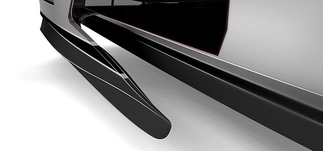

The hull design has more similarities than just the smirk chine line at the bow. The hull uses sponsons outside of a center v-hull. The sponsons are completely separated from the main hull, which is quite different than the Boston Whaler hull sponsons. Detail of sponson design here: The hull design with sponsons is said to be "Three times more stable than a monohull." The element we are calling a "smirk" is designated as a "wave deflector" and is said to deflect large waves and green water from coming on deck. |
