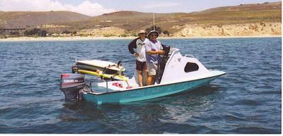

| Nantucket Sleighride |
Adding a pilot house to a Boston Whaler 17' Montauk offers shelter from wind and spray. This allows you to end a day of fishing on a good note by remaining warm and dry. Here are 2 custom built pilot houses on Montauks. |

| perichbrothers |
Wow Bill - Nantucket Sleighride! You've done some incredible work there. Definitely has the function before form styling, but I can imagine a drier trip home from Santa Cruz! Spied all the shots and all the house-whalers look like workhorses. Can't believe you got away with building those in your yard though! Thanks for showing these off! TP |
