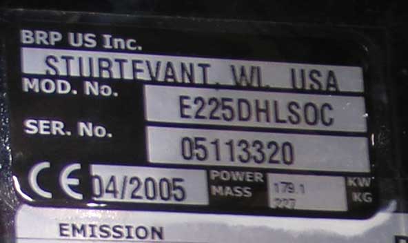

jimh posted 11-29-2006 09:43 AM ET (US)     Profile for jimh  Send Email to jimh
Evinrude lists the engine power of their 225 H.O. right on the emission sticker. This measurement is from the Family Emissions Limit (FEL) testing for EPA compliance. The power is listed in kilowatts:
225 H.O. = 179.1 kW
This converts to horsepower
179.1 kW x 1.341 = 240.2 HP
and that is the whole truth about the E-TEC 225 H.O. horsepower. We don't need to cite some statement in cyberspace by some guy name AssCrackerAss to back it up--even if the fellow is a recognized authority on some other internet discussion forums.
Comparative results in magazine testing show how fast a boat goes, not how much horsepower the engines have. How fast a boat goes depends on many factors, and the horsepower of the engine is only one of those. It is almost endemic that in these boat tests the engines use different propellers, so this makes any differences in boat speed extremely difficult to link to differences in engine horsepower.

And again, sorry to continue off-track with this information about another E-TEC, the 225 H.O. version from 2005, but here is an image of the manufacturer's sticker which clearly shows the power rating in kW:
Photo: Manufacturer's label on 2005 E-TEC 225 H.O.
One of the reasons these discussions keep getting off-track is because they are frequently derailed by introduction of new topics not related to the original discussion. What often results from these derailments is a train wreck.
But in any event, there is some reasonable evidence of the claims made for the E-TEC engines and Honda engines. It is clear from these that the E-TEC, Yamaha, and Honda motors labeled as "150-HP" are able to produce in excess of 160-HP according to data directly from manufacturers.

With that extra 0.13 KW, that must have been the very rare 225 HO+ for 2005. ;)
