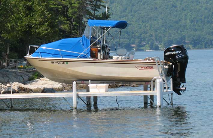

jimh posted 05-12-2008 11:47 PM ET (US)     Profile for jimh  Send Email to jimh
Here is a first look at a classic Boston Whaler OUTRAGE 18 with an L4 VERADO motor:
Photo: Boston Whaler OUTRAGE 18 with L4 VERADO motor
Photo: Boston Whaler OUTRAGE 18 with L4 VERADO motor; stern quarter view
jimh posted 05-13-2008 12:10 AM ET (US)     Profile for jimh  Send Email to jimh
Tom--Your fine classic OUTRAGE 18 looks great with the new Verado L4 motor. Please give us the performance results when you get in the water and run some trials. I think many will be interested to hear your results.
Congratulations on being the first to re-power a classic Boston Whaler with a Verado!

One other observation: from the photo above it is hard to tell, but is your aft-facing stern light visible from boats approaching from your aft port? Or will you need to elevate the lamp a little to clear the powerhead?

I don't find the 150hp to appear very much larger than any other modern outboard. Please provide more pictures. I agree, I would love to see the inside rigging shots as well as the motor in the down position both in and out of the water.

glen e posted 05-15-2008 11:20 PM ET (US)     Profile for glen e  Send Email to glen e
not sure but in your last pic above the prop is a circular anode - on single engines that anode usually has a tab which helps correct for torque steer - ask your dealer about it..it looks like you have the one for dual engine setups...

jimh posted 06-29-2008 10:00 AM ET (US)     Profile for jimh  Send Email to jimh
More pictures of the installation of a Verado L4 on a classic Boston Whaler OUTRAGE 18.
Photo: Boston Whaler OUTRAGE 18 with Mercury Verado L4
Getting closer to the water
Photo: Gear case of Verado L4
Anti-ventilation plate height relative to hull bottom
blkmtrfan posted 06-30-2008 11:02 AM ET (US)     Profile for blkmtrfan  Send Email to blkmtrfan
Love the shot on the lift, the boat looks fantastic, wish it was at my house :)
