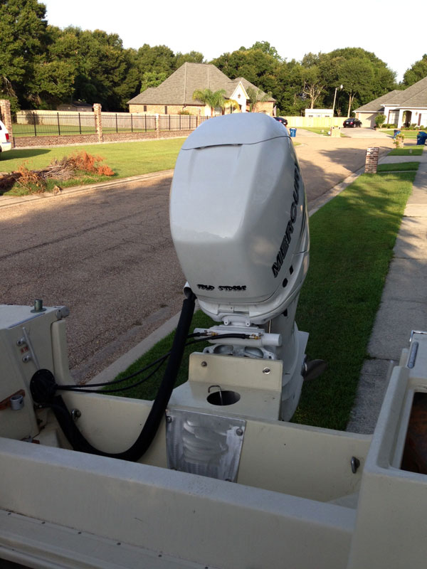

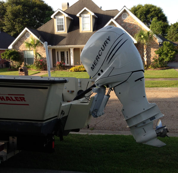

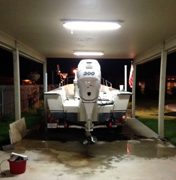

It has been just about a decade since Brunswick introduced their Mercury Marine VERADO outboard engine, and I have been waiting to see one used as a repower on a classic Boston Whaler boat. Thanks to the ingenuity of Miles T. from Lafayette, Louisianna, we have our first look at a Boston Whaler classic OUTRAGE 25 re-powered with a 300-HP VERADO. Miles, who is a professional engineer and a ship consultant, designed the set back bracket. The bracket is a 12-inch set back and (I think) adds three inches of height relative to the transom. Using a 15.25 x 19 RAMPAGE propeller, initial testing produced a boat speed of 49-MPH. Miles said the hull had a bit of wobble at that speed. Miles has seen some transom flexing, perhaps not unexpected with the long set back bracket and the significant weight of the VERADO. Once the engine mounting height is dialed in, he plans to add reinforcement to the transom. He is looking for ideas on adding strength to the transom, and what it could be tied into on the hull. The transom notch will also be closed off to keep water from shipping aboard and perhaps also add strength The white VERADO, which I think looks just great on the OUTRAGE, was a low-hour engine off a go-fast demonstrator boat with quad engines. In a bit of a mix-up, Miles ended up with a counter-rotating engine. The used engine, only 360-hours, was quite attractively priced, too. Enjoy the pictures:

I was a bit surprised how natural the side view looks and how it sits in the water. It does not appear to be as heavy as I thought it might look. Saying that the rear view, well it doesn't look as natural anymore. That engine is huge. The white looks nice, a bit weird to see a white mercury actually given the decades of jet black. Martyn |

With that much power from a single engine on a relatively narrow beam boat, I wonder...does it list at WOT due to the twisting action of the prop? One of the benefits of Twin engines in a max hp configuration is the ability to negate that effect with counter-rotating propellers. Just curious. I think this is actually the second Classic Whaler I've seen with a Verado repower. The first is Tom Birdsey's 18' Outrage up on Lake Champlain. That engine is huge, but it doesn't appear to make the boat "squat" too much at rest. Dave |

Tom's OUTRAGE 18 has the four-cylinder VERADO. Miles's boat has the rather taller six-cylinder. I agree with Martyn; the view in the first image gives a favorable perspective to the boat and engine. That classic 25-foot hull looks very low and long in that shot. |

Jim it is interesting to see the engine raised up on the bracket. Seems to be as high as you could possibly get it as well. Does this mean if the engine was mounted on the original transom it would not work properly or at all? It it appears maybe at least 3inches if not 4 to 5? I'm more curious to find out why it's on a mount. If the owner is an engineer I'm sure there was perfectly good reason for it. Martyn |

That motor is a 30" shaft length model and the Outrage 25 takes a single 25" shaft length motor, hence the extreme high mounting. Gotta say, the Verado looks a lot less goofy and massive in white. |

Could always fab a wider bracket between transom and motor. It would relieve the force if its really a problem, mount with eight bolts. My Wahoo! 2600 had similar issue, when the new owner went from twin 200 mariners to a single F350 V8. A year + later no stress cracks. (He's my neighbor) |
