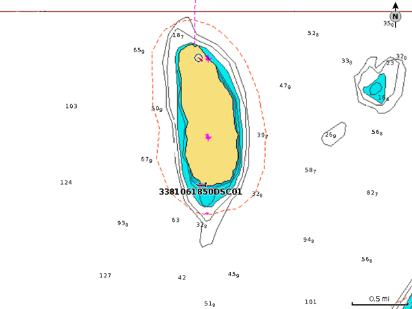

A feature of digital selective calling (DSC) VHF Marine Band radios is the ability for one radio to request a position report from another radio. This is called position polling. When a DSC radio receives a request for its position from another radio, the polled radio can be configured to answer either automatically or to require manual approval before responding.
When we were in the Apostle Islands National Lakeshore area last week, we were planning to rendezvous with our friends aboard HOLLY MARIE. We knew the maritime mobile service identity (MMSI) of the HOLLY MARIE. We did not know the boat's location, so we sent a DSC request for a position poll to the HOLLY MARIE. As it happened, the HOLLY MARIE was in radio range, laying about 12-miles to the Northeast, and her DSC radio received our DSC call.
The DSC radio on the HOLLY MARIE responded with the position of the boat. On the HOLLY MARIE their DSC radio is connected to their GPS receiver, and the GPS receiver provides position data to the radio. Our DSC radio is connected to our chart plotter via a NMEA-0183 serial data connection, and our radio received the position data from the HOLLY MARIE, and also sent the position information to our chart plotter. The chart plotter drew the location of the HOLLY MARIE on our navigation chart as a new WAYPOINT. The screen presentation of the HOLLY MARIE position from the DSC position poll request looked like this:
Screen capture of chart plotter display showing remote vessel position received via digital selective calling radio.
The chart plotter marked the position as a waypoint and gave the waypoint the name "3381061850DSC01." The first part of that string is the maritime mobile service identity of the station sending the position. The suffix "DSC01" most likely refers to the source as being from a digital selective calling radio. I don't know if the "01" is a serial number that will be incremented on the next position request. We'll have to investigate further.
The Waypoint on the chart plotter also included the following detail "Undesignated distress." This is an unfortunate notation, as there was no distress involved in this position request. This notation may have been created because a field in the DSC message was left blank or sent as a "0", and the chart plotter interpreted this as a default message, "undesignated distress."
In order to obtain this sort of information from your DSC radio, you need to connect the radio to both the GPS receiver and the chart plotter. The GPS receiver sends the position data to the radio, and the radio will transmit this data when requested to other stations. The radio must also be connected to the chart plotter, so that when the radio receives position information from other stations, it will output the data to the chart plotter for display.
If the radio, the GPS recevier, and the chart plotter are all NMEA-2000 devices, the interconnection will occur automatically when all three are on the same network backbone. If the devices are NMEA-0183 devices, you have to discretely wire a connection from the GPS receiver to the radio, then from the radio to the chart plotter.

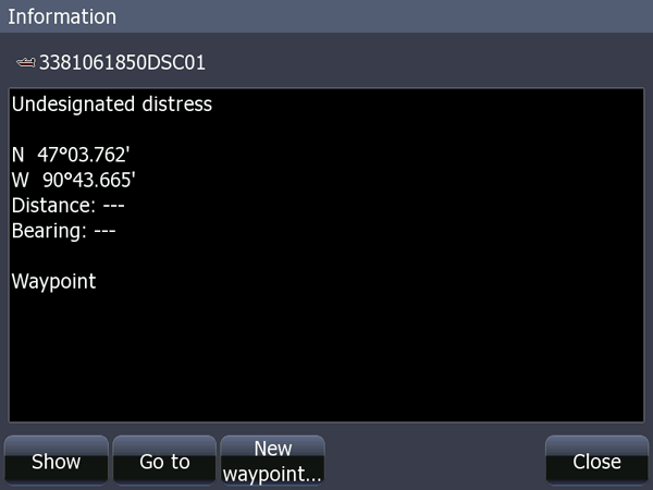

Below is a screen capture of the details of the waypoint that was created on my Lowrance HDS-8 when my Standard-Horizon radio sent the remote position information that it received from the HOLLY MARIE:
Screen capture of chart plotter information on waypoint showing the notation
Exactly how this waypoint got the notation "undesignated distress" is not precisely known. (Also, the distance and bearing to the waypoint are not indicated because at the time when I grabbed this screen image the chart plotter did not know its own position, that is, its GPS had not yet obtained a position fix solution.)

Here is a follow-up on the subject of the Lowrance HDS displaying the remote position poll request as a DSC call with the category of "undesignated distress."
I sent an email to Lowrance asking about the description of the waypoint as "undesignated distress." My email was really just about a cut-and-paste of the initial article in this discussion, including the screen capture. Here is the reply I received, which I reproduce verbatim:
quote:
By looking at the information and screen shot's yuou have provided, this would indicate that your Buddy Tracking MMSI DSC Calls between your HDS and another vessel, is actually working properly. Since you and the other vessel were transmitting Vessel Location (buddy tracking) calls which allows you to just locate other vessel's position, then this is UNDESIGNATED DISTRESS call is proper for the type of call you were receiving.
jimh posted 09-02-2012 11:45 PM ET (US)     Profile for jimh  Send Email to jimh
Notwithstanding the reply from Lowrance that the description of "undesignated distress" is normal, I don't think this is the right way to handle a routine position poll response. There is no distress nature to the call. It is just a request for position.
Here is some commentary about the "undesignated distress" category. It seems it is the default description in a distress call.
