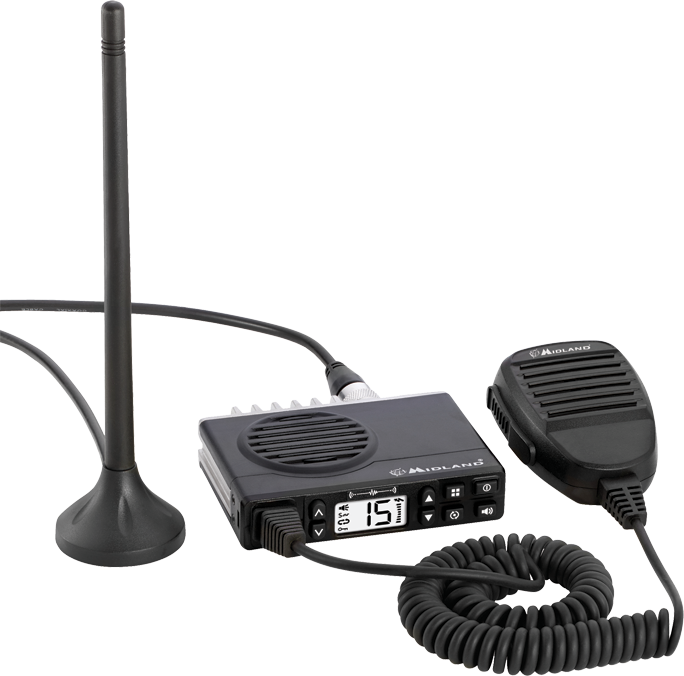

According to a press release, the electronics manufacturer MIDLAND is going to introduce a new GMRS radio this month, July 2015, that will be quite interesting for GRMS licensees. The new radio is called the MIDLAND MXT100 MICROMOBILE GMRS 2-WAY RADIO. See The MXT100 will sell for $150. It is an incredibly small radio, having dimension of 0.9-inch high, 4-inch wide, and 3.5-inch deep. The radio has a standard SO-239 antenna connector on the rear panel for connecting an external antenna and is powered by 12-Volts DC. An external antenna is included.
The included antenna has about a 12-foot coaxial transmission line attached and is a magnetic mount. It will be good for a vehicle steel roof but not for a fiberglass or aluminum boat. Because the radio is a 5-Watt radio, it does not operate on the channels that are reserved for FRS-only (which are limited to 1-Watt transmitters). It transmits and receives on Channels 01 through 07, then skips the FRS-only Channels, and continues with Channel 15 through Channel 22. This provides a total of 15 GMRS channels. This should be plenty of frequency agility and permit finding a working channel with low traffic. The radio can communicate with FRS radios on Channel 1 through Channel 7. With an ultra-small radio like the MXT100 available at a modest $150, and the GMRS license fees eliminated, it seems like the General Mobile Radio Service offers the perfect solution to the very common desire for boaters who want a shore station at their homes or cottages to communicate with their family out in a boat. With decent antennas on the shore station and boat, communications to a range of ten miles ought to be very reliable. |

MIDLAND has brought their new GMRS radio to market. See Press Release Catalog Listing Initial sales of the radio appear to have been so strong that they have exceed supply and the product is already on backorder status. |
