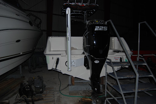

I just thought I'd update you on the progress. Ended having to have a bracket mount installed. http://picasaweb.google.com/lh/photo/ QYns7RIAOe6pRRLOzwcdFtH5iCbmYDa2my98ztG0n8A?feat=directlink |

Rob, Nice looking boat, the PP is a nice addition to the transom. I think it is a great idea and sounds like an ideal set-up for the type of boating you do. Congrats on a great looking boat, I really like the 220 Outrage. Wish I could provide some info on the chain/locker cover question, just not something I have seen in person. Enjoy the new ride! Robert |

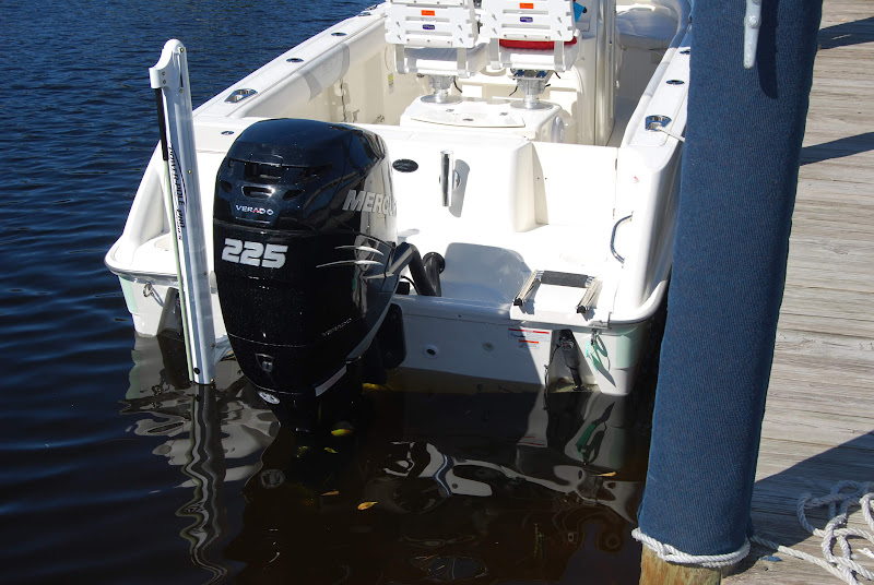

Thanks Steve; Went out on a shakedown with the dealers captain yesterday. Very nice ride. Power Pole will be great! It does end up sitting in the water a bit while at rest and at slow speed but while on plane it is clear of the water. If I had to do it over again I would probably get the 3" vertical offset bracket, it would raise it enough to get it clear of the water. Power Pole says that it would not be a problem but why invite one. http://lh4.ggpht.com/_uq9UR85WeM8/TQNoKMbQdsI/AAAAAAAAFAU/LpII7bbYoDY/ s144/DSC_0930.JPG The anchor locker, not so good. I was told but the salesman that the chain would fit though the opening, he even said he checked it. When I got there they were just finishing up installing the chain latch (which does come in the Captain's Bag so no need to order it separate, but that is another story). When they when to put the chain into the locker it would not shut. Well that will need to be resolved. |

Rob, That's a nice looking bracket. Is it available from the Power Pole folks? You mention a 3" vertical offset bracket which would probably be better for my 190 Montauk. I will check out the availability of brackets from Power Pole. Does your bracket through bolt to the motor well and the bilge? Thanks. Butch |
| SJUAE |
Rob Certaintly a different option :) My 9.9 kicker drags a little in the up/horizontal position until I'm on the plane then there's lots of clearance no doubt your pole is the same How about some shots of the rest of your outfit and the chain locker Is that the sales tag on the stern tow eye :) just love new boats, want one now. Regards |
