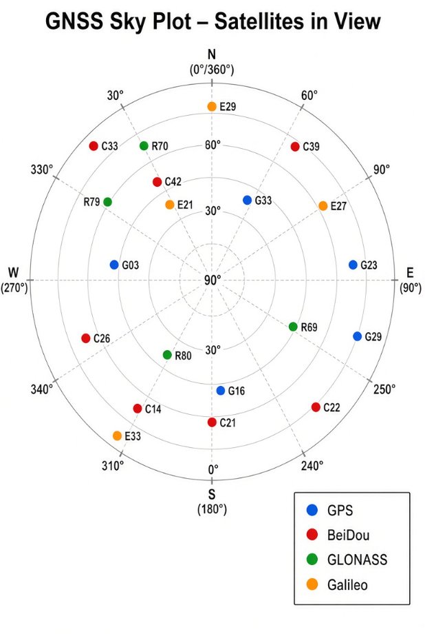

For even a better indicator of how many satellites where available in the four constellations, I asked Grok to produce a sky view polar plot. It took a rather long 40-seconds to produce the graphic:
Fig. 1. Polar plot of satellites in view using the modern YIC GNSS L1/L5 USB receiver. This instance is with the receiver indoors and sitting on a south-facing window sill.
There were a possible 37 satellites in view. There were good signals (elevation > 0-degrees and non-zero SNR reported) from 34 satellites. The sky polar plot only shows 20, which perhaps is just a limitation of the AI graphic generator. There are some errors; for example, there is no GPS PRN "33" listed, but the plot shows a GPS satellite "G33". I think GROK had a few glitches generating the polar plot of satellites in view.
The data shown are just from a random moment in time at a random location in southern Michigan with an indoor antenna location. For me, the results are just amazing, compared with what a GPS-only c.2010 receiver would be able to produce. Both the L1 and L5 civil signals on GPS were received, and both the E1 and E5 signals on GALILEO were received. All four GNSS constellations were received. All that for $43.
