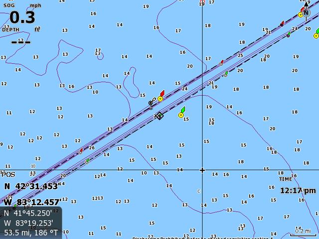

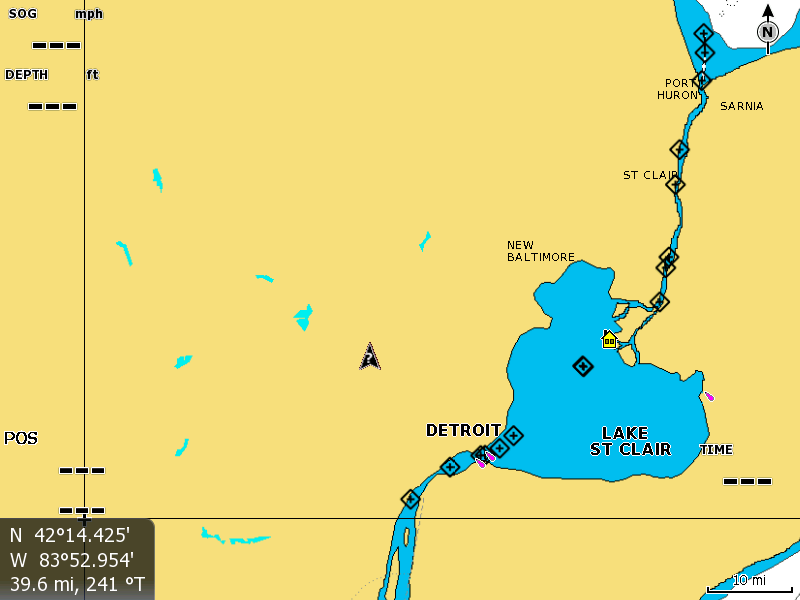

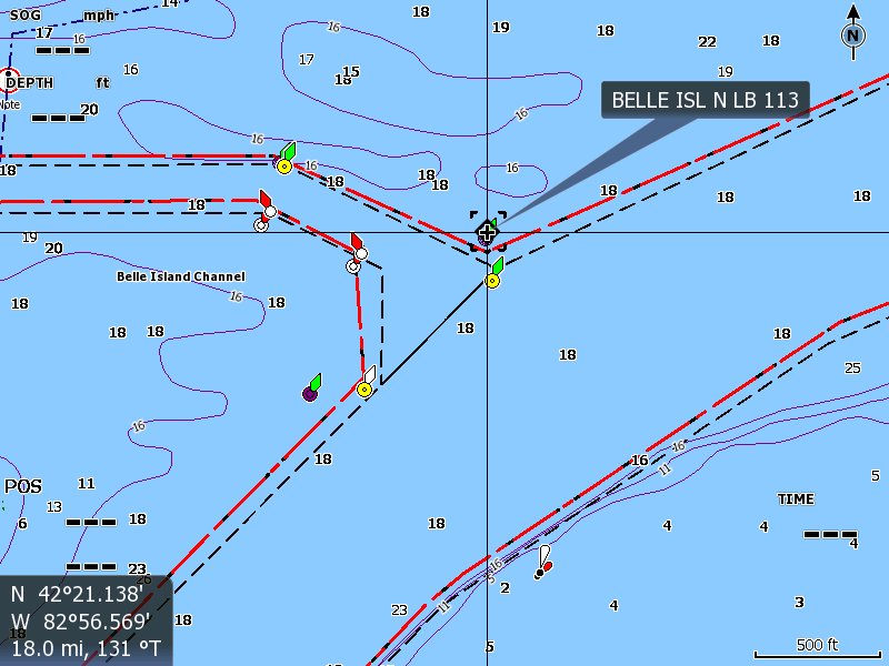

shot 11.png (42.9 KiB) Viewed 96394 times
HDS-8 presentation of AIS AtoN targets.
In the above screen capture, 15 AIS AtoN aids to navigation are shown. Not shown are about five more AIS AtoN marks in the lower Detroit River and Lake Erie. The targets in Lake Huron are over 50-miles from my receiver, but the actual signals for them are originating from the much closer tower at RFF WAYNE.
Having crossed the hurdle of receiving the AIS AtoN signals and seeing them on the chart plotter, the iconic representation of the aid to navigation was the next area of interest. As shown above, the aids are represented by a black rhombus with an internal black crosshair mark. Guidance for how AIS AtoN targets ought to be shown on electronic chart plotters is given by IEC Recommendation 68822. The basic AIS AtoN symbol is a diamond or rhombus shape with a black crosshair in the center, drawn with thin solid black lines. The applicable text from the recommendation says:

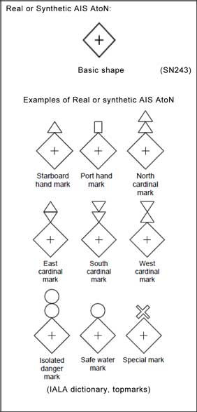

Real or synthetic AIS aids to navigation
(AtoN) shall be presented as a diamond with
crossed lines centred at the reported position
of the AtoN. The crossed lines shall be not
more than 2 mm in length and the sides of
the diamond shall be not more than 6 mm in
length.
The diamond and crossed lines shall be
drawn using a thin solid line style.
The symbol representations for a real or synthetic AIS AtoN should look like this:
Recommended symbols for Real or Synthetic AIS AtoN
Before we can assess the Lowrance HDS-8 display and its compliance with recommendations, we must first identify the type of AIS AtoN that is being received.

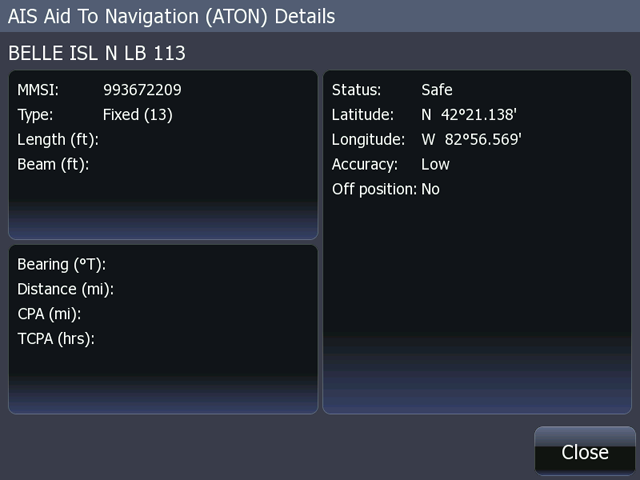

shot 18.png (66.17 KiB) Viewed 96393 times

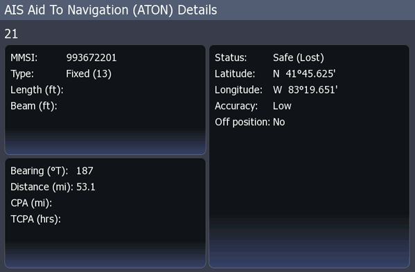

AIS Aid To Navigation (ATON) Details screen
The details screen gives the MMSI of the AIS AtoN and its position, and several other parameters sent in the AIS transmission; see below for the complete list of data that is shown. Note that a range and bearing are not shown; at the moment I took this screen capture my chart plotter had not acquired its own position, so it could not compute a range and bearing to this target.

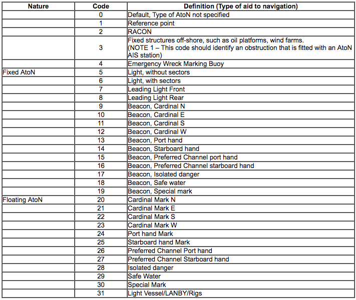

The categories for nature and type of aid are given in ITU-R M.1371-5 Section 3.19 in Table 74, and are reproduced below:
0 = Default, Type of AtoN not specified
1 = Reference point
2 = RACON
3 = Fixed structures off-shore, such as oil platforms, wind farms. (Should identify an obstruction that is fitted with an AtoN AIS station)
4 = Spare, Reserved for future use
FIXED AtoN
5 = Light, without sectors
6 = Light, with sectors
7= Leading Light Front
8 = Leading Light Rear
9= Beacon, Cardinal N
10 = Beacon, Cardinal E
11 = Beacon, Cardinal S
12 = Beacon, Cardinal W
13 = Beacon, Port hand
14 = Beacon, Starboard hand
15 = Beacon, Preferred Channel port hand
16 = Beacon, Preferred Channel starboard hand
17 = Beacon, Isolated danger
18 = Beacon, Safe water
19 = Beacon, Special mark
FLOATING AtoN
20 = Cardinal Mark N
21 = Cardinal Mark E
22 = Cardinal Mark S
23 = Cardinal Mark W
24 = Port hand Mark
25 = Starboard hand Mark
26 = Preferred Channel Port hand
27 = Preferred Channel Starboard hand
28 = Isolated danger
29 = Safe Water
30 = Special Mark
31 = Light Vessel/LANBY/Rigs
The data field "status" does not seem to be specifically defined in any reference material I can find. It is shown as "Safe" in most instances I have encountered, but I don't know what the other options might be.

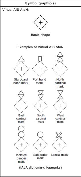

Chris's remark was really very instructive for me. It made me realize the symbols used on a chart plotter to represent a virtual AIS AtoN ought to provide a clear distinction from the other two categories, real and synthetic, because for those two types of AIS AtoN there will be a physical buoy or structure at the location of the AIS signal.
The recommendations from IEC 62288 suggest a distinctive marking; the black diamond is to be drawn with dashed lines, not solid lines. Here is the applicable text from the recommendation:
Virtual AIS aids to navigation (AtoN) shall be
presented as a diamond with crossed lines
centred at the reported position of the AtoN...
The diamond shall be drawn using a thin
dashed line style. The crossed lines shall be
The symbol representation should appear as shown below:
AIS AtoN Symbols for Virtual Aids
In my testing so far, I do not believe I have encountered a virtual AIS AtoN signal, so I don't know how it will be rendered on my Lowrance HDS first-generation chart plotter display.

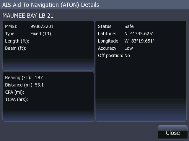

As already mentioned, when an AIS symbol overlays a chart object, you can get to the two separate information or detail pages, one for the AIS target and another for the chart object, by using the contextual menu for that presentation. (ASIDE: the term "contextual menu" refers to the concept that the contents of the menu will change depending on the context or situation in which the menu is called upon for display. In this case, when an AIS object is part of the chart area under the cursor, the menu adds an option for AIS detail. On the HDS-8 the contextual menu is invoked by hitting the MENU button.)
Selecting the AIS DETAIL option from the contextual menu gives this page of data:
AIS Detail Page for virtual AIS AtoN
There does not appear to be any indication in the AIS DETAIL page that this AIS AtoN is of the category virtual. The information presented is the same as was given for synthetic AIS AtoNs.

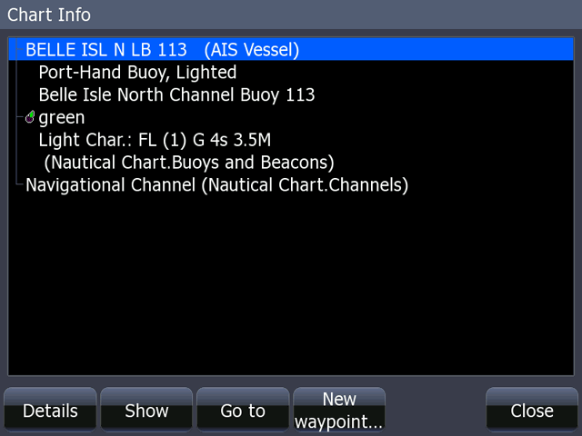

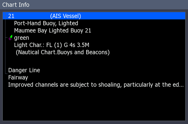

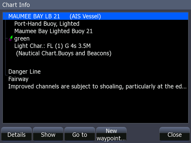

Selecting the INFO option from the contextual menu gives this page of data:
Chart Info Page for the charted object
So far as I can tell from this example, the first-generation Lowrance HDS chart plotter is not drawing the electronic chart symbol or presenting information details for a virtual AIS AtoN in any different manner from a real or synthetic AIS AtoN. While this is a slight disappointment, I still am impressed overall with the ability of the first-generation HDS to show these electronic navigation marks.

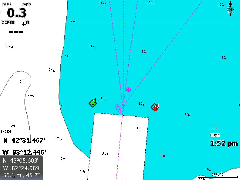

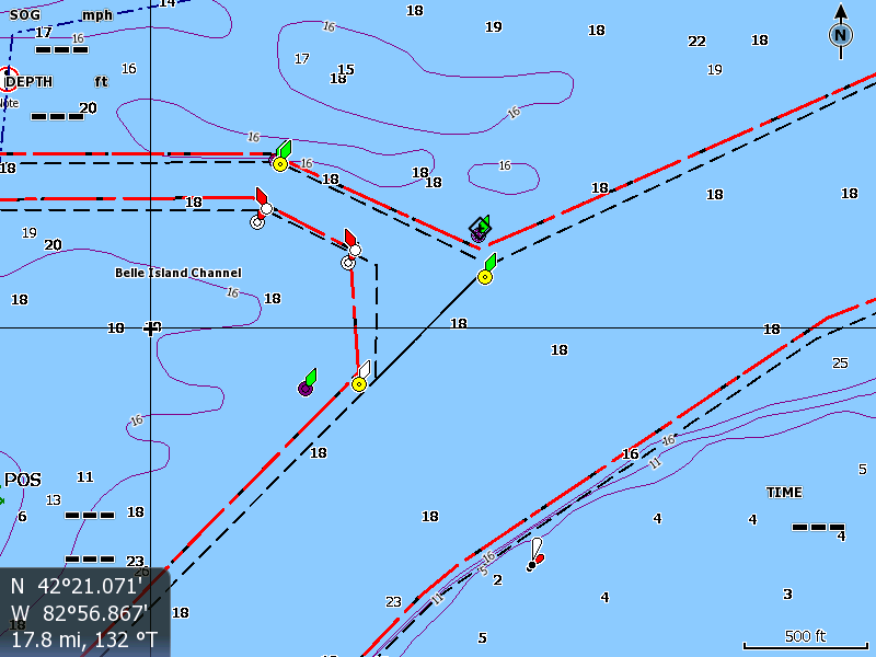

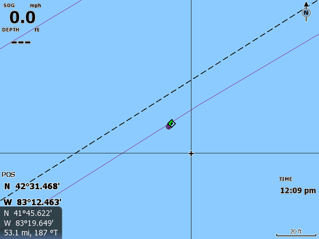

To complete my testing of how the Lowrance HDS first generation chart plotter renders AIS AtoN signals into chart presentation, I checked the presentation when using a different electronic chart. The results were interesting. Compare the prior screen captures with this one:
shot 38.png (40.6 KiB) Viewed 96237 times
Lake Huron Cut Buoys 11 and 12, Navionics Chart with AIS AtoN symbols showing
The above screen capture shows two synthetic AIS AtoNs in Lake Huron as presented with a Navionics chart. The most remarkable difference involves the way the AIS AtoN diamond symbol is drawn for the electronic aid with respect to the chart's own symbol for the physical aid. In this presentation, the AIS AtoN symbol is drawn underneath or behind the chart symbol for the physical aid. This presentation is the opposite of that seen earlier. In those earlier screen captures, the chart in use was the Lowrance built-in chart. (My HDS-8 has the upgraded option for included USA charts called "INSIGHT USA" charts.) The electronic marker (black diamond) was drawn over the chart marker on those Lowrance charts. On this Navionics chart, the electronic marker (black diamond) is drawn behind the chart marker. This presentation does not obscure the original chart icon for the marker.
I assume the difference in presentation must be related to the structure of the electronic data in the charts in particular layers or tiers, and in the Navionics charts the AIS overlay layer must be underneath the chart buoy icon layer.

UPDATE: now about three years after I initially wrote this article, I happened to again investigate the AIS AtoN signals being send during the Winter navigation season on the Great Lakes, or in particular, on Lake Erie. I found AIS AtoN icons that were new and different from the ones used in 2015. Since there has been no update to the firmware in my chart plotter--still the rather old HDS-8 first generation--I must assume that the icons were already available in the chart plotter. The cause for the chart plotter to display different icons than before must be due to the AIS AtoN sending a different identification type. Here is a segment of a screen capture showing an AIS AtoN icon:
Fig. 1. Screen capture from HDS-8 of an AIS AtoN icon. The view is North-up, so the position of the AIS AtoN is on the West side of the channel.
Fig. 2. Icon enlarged for better interpretation; the symbol appears to be two opposing arrowheads.
Fig. 3. Recommended symbols for AIS AtoN targets.
Comparing the icon shown by the HDS-8 with the symbols in the recommended list of icons, the interpretation of the icon meaning appears to be most similar to the icon table listing for "West cardinal mark," as that is the symbol that has opposing arrowheads. In the USA, buoys or aids to navigation mark the sides of a channel in a lateral system. In contrast, cardinal marks indicate the direction of safety as a cardinal or compass direction, that is, North, East, South, or West, relative to the mark. If the AIS AtoN icon is interpreted as a West cardinal mark, it would be suggesting that the deeper water was to the West of the mark. This is actually true. The chart presentation, in this particular instance as seen in the screen capture, is inaccurate.

On the HDS-8 the screen also for viewing the "AIS Info" or supplemental information about the target.
Fig. 3. AIS Info data from HDS-8. Note the value for TYPE.
The AIS Info page indicates that the AIS AtoN is a type "Fixed (13)." To interpret this meaning we must consult another listing of AIS Message data, so we turn to the USCG NavCen website. There we can find a very informative webpage with a description of a large number of messages associated with AIS AtoN targets.
In the list we find that Field-4 of AIS Message type 21, AIS AIDS TO NAVIGATION (ATON) REPORT, contains a numerical value for the type of aid. This numerical value is then interpreted by consulting a list from the International Association of Lighthouse Authorities (IALA), shown below. We then search the list to see what description is provided for a type value of 13.
Fig. 4. List of types of AIS AtoN from IALA.
Consulting the above list for the meaning of a numerical value of 13 in the AIS Message 21 Field-4 value, we see the interpretation is "Beacon, Port Hand." This is a really confusing result. The aid is described as a fixed aid, as distinct from a floating aid, and the indication is "Port Hand."
Inasmuch as I am not familiar with navigation aids of "Port Hand" type, I had to search for more information. The interpretation of "Port Hand" means a mark that will appear on the port side of a vessel that is traveling in the channel in the direction of the buoyage. (This is explained more thoroughly in another post, below.) Since there are two IALA regions, the interpretation for Region B (the Americas) is to be used, so a Port Hand mark is a GREEN mark.
I then loaded the chartplotter with a better chart for this area. and then I could also get data about the aid to navigation from the chart data using the HDS-9 (CHART) INFO option in the MENU option list.
Fig. 5. Chart Info screen from HDS-9
As the above information screen shows, the AIS AtoN is to be interpreted as a green or port-hand mark. This makes the use of the icon for a cardinal mark rather conflicting with the actual meaning.

To better find AIS AtoN icons, I zoom-out on the chart display screen so that most chart details drop out. This leaves just the AIS icons overlaid, and they become very easy to see. Figure 1 below shows this:
Fig. 1. HDS chart screen showing AIS AtoN icons.
The AIS AtoN target that we will examine is the one just to the upper-left of the crosshairs. Note that this icon is showing the standard default target icon, a rhombus with a cross inside. Next we zoom in on the chart to get a better look.
Fig. 2. The AIS AtoN with chart zoomed in to show details.
By zooming in we see that the AIS AtoN target is marking the side of a fairway or channel. It is close to a physical mark, but its electronic position is slightly different than the physical mark. This is handy for this presentation, because the AIS AtoN icon does not land atop the chart icon for the actual aid to navigation, and we can see the icon very clearly.

This example contradicts my earlier example in which the AIS AtoN icon seemed to appear as a set of opposing arrowheads. I believe I have found the reason for that unusual presentation: there is some interaction of the graphics display in which the icon element and the dashed line element representing the channel edge land in a particularly unfavorable way, resulting in the icon for the AIS target and the chart dashed line combining to change the appearance. I will demonstrate below with two more illustrations.
First we see a normal AIS AtoN icon, close to a dashed line element, as occurred above in our chart display in Fig. 2.
Fig. 5. An AIS AtoN icon with normal crosshair and a channel edge dashed line element.
What if, by chance, the AIS AtoN icon happened to be exactly on the dashed line of the channel boundary, as might often be the case? The two elements could combine graphically, and produce a display that looked like this:
Fig. 6. Display resulting from AIS AtoN icon overlaying chart dashed line.
The resulting display resembles the sort of strange icon observed in my earlier update, in which the icon appears to contain opposing arrowheads. I now believe that this random alignment of the chart elements may have produced the unusual icon presentation for the AIS AtoN as a cardinal mark, when it was much more plausible that the AIS AtoN was a lateral mark.
