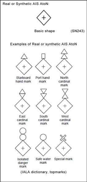

Having crossed the hurdle of receiving the AIS AtoN signals and seeing them on the chart plotter, the iconic representation of the aid to navigation was the next area of interest. As shown above, the aids are represented by a black rhombus with an internal black crosshair mark. Guidance for how AIS AtoN targets ought to be shown on electronic chart plotters is given by IEC Recommendation 68822. The basic AIS AtoN symbol is a diamond or rhombus shape with a black crosshair in the center, drawn with thin solid black lines. The applicable text from the recommendation says:
Real or synthetic AIS aids to navigation
(AtoN) shall be presented as a diamond with
crossed lines centred at the reported position
of the AtoN. The crossed lines shall be not
more than 2 mm in length and the sides of
the diamond shall be not more than 6 mm in
length.
The diamond and crossed lines shall be
drawn using a thin solid line style.
The symbol representations for a real or synthetic AIS AtoN should look like this:
Recommended symbols for Real or Synthetic AIS AtoN
Before we can assess the Lowrance HDS-8 display and its compliance with recommendations, we must first identify the type of AIS AtoN that is being received.

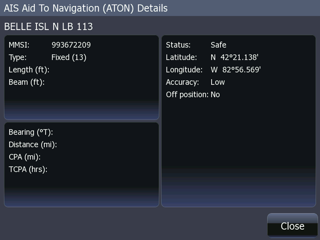

shot 18.png (66.17 KiB) Viewed 95261 times
AIS Aid To Navigation (ATON) Details screen
The details screen gives the MMSI of the AIS AtoN and its position, and several other parameters sent in the AIS transmission; see below for the complete list of data that is shown. Note that a range and bearing are not shown; at the moment I took this screen capture my chart plotter had not acquired its own position, so it could not compute a range and bearing to this target.

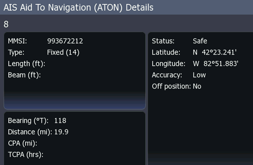

Ahah! I found the trick to get to the information page for a navigation buoy that has an AIS AtoN symbol overlaid. To get to either the AIS AtoN Detail page or the regular chart physical buoy information page on the HDS-8 first generation, you have to:
--put the cursor over the icon for the aid to navigation
--push the MENU key
--a contextual menu pops up; in the menu are two choices: AIS DETAILS or INFO.
Use the cursor keys to highlight AIS DETAILS:
If you then push ENTER, you will get the AIS DETAILS screen:

The AIS INFORMATION page for an AIS AtoN on a Lowrance HDS first-generation chart plotter shows the following eight data values being sent in the AIS Message 21 broadcast:
--MMSI of the AIS AtoN
--nature and type of aid (from 32 categories, see below)
--name of the aid to navigation
--position accuracy
--position latitude
--position longitude
--off-position indicator
--status

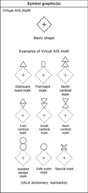

The recommendations from IEC 62288 suggest a distinctive marking; the black diamond is to be drawn with dashed lines, not solid lines. Here is the applicable text from the recommendation:
Virtual AIS aids to navigation (AtoN) shall be
presented as a diamond with crossed lines
centred at the reported position of the AtoN...
The diamond shall be drawn using a thin
dashed line style. The crossed lines shall be
The symbol representation should appear as shown below:
AIS AtoN Symbols for Virtual Aids
In my testing so far, I do not believe I have encountered a virtual AIS AtoN signal, so I don't know how it will be rendered on my Lowrance HDS first-generation chart plotter display.

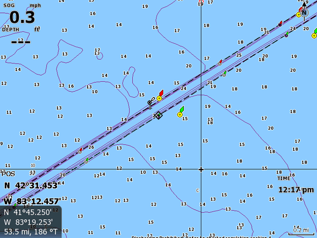

Just when you thought this thread could not get any better: I found an VIRTUAL AIS AtoN signal in my area! As it happens, I can also receive AIS signals for many, many AIS AtoN electronic navigation marks in Lake Erie recently added by the USCG to their testing. Some of them are virtual AIS AtoNs, that is, there is no longer a physical aid to navigation at the location, but just the electronic marker being send via radio. A listing in the Local Notice to Mariners (LNM) gave me the location of an in-range virtual AIS AtoN:
Maumee Bay Lighted Buoy “21” (LLNR 6155) Virtual AIS ATON
I was delighted to find that I could receive the AIS signal for this aid. This provides the opportunity to further test the chart plotter's representation. Because this is a virtual aid-to-navigation, its symbol should distinguish it from a real or synthetic aid-to-navigation. The screen captures below show how the first-generation Lowrance HDS-8 chart plotter rendered the data.
HDS-8 chart view of Maumee Bay Lighted Buoy 21 with AIS overlay

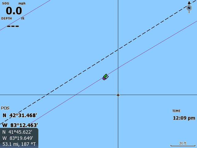

The AIS AtoN symbol appears to be the same basic symbol used for real or synthetic AIS AtoN electronic marks. According to recommendations, this symbol should be drawn with dashed lines for the diamond or rhombus.
As above, but with a larger scale chart presentation
There is no sign of any dashed lines in the drawing of the rhombus symbol. Moving the chart cursor over the symbol brings up an identification banner:

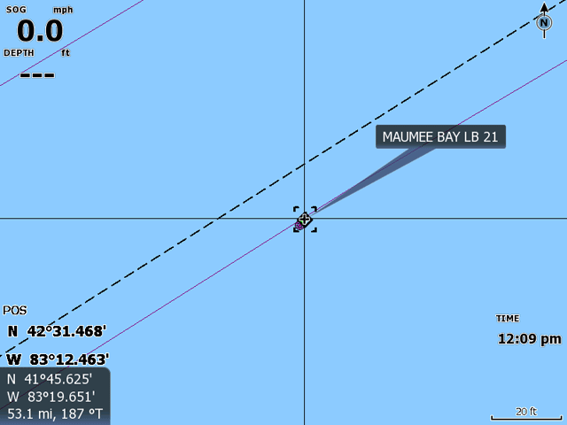

HDS-8 shows the identity of the navigation mark when the cursor is positioned on it
So far there is no sign that this aid-to-navigation is a virtual AIS AtoN.
The electronic chart continues to show a floating aid to navigation at that position. This is to be expected because when the chart was created, there was a floating aid at that position. The chart would have no way to modify its position based on a Notice to Mariners that the floating aid was being removed for the winter season by the Coast Guard, so the chart still shows a physical aid in that location.

Fig. 3. Recommended symbols for AIS AtoN targets.
Comparing the icon shown by the HDS-8 with the symbols in the recommended list of icons, the interpretation of the icon meaning appears to be most similar to the icon table listing for "West cardinal mark," as that is the symbol that has opposing arrowheads. In the USA, buoys or aids to navigation mark the sides of a channel in a lateral system. In contrast, cardinal marks indicate the direction of safety as a cardinal or compass direction, that is, North, East, South, or West, relative to the mark. If the AIS AtoN icon is interpreted as a West cardinal mark, it would be suggesting that the deeper water was to the West of the mark. This is actually true. The chart presentation, in this particular instance as seen in the screen capture, is inaccurate.

On the HDS-8 the screen also for viewing the "AIS Info" or supplemental information about the target.
Fig. 3. AIS Info data from HDS-8. Note the value for TYPE.
The AIS Info page indicates that the AIS AtoN is a type "Fixed (13)." To interpret this meaning we must consult another listing of AIS Message data, so we turn to the USCG NavCen website. There we can find a very informative webpage with a description of a large number of messages associated with AIS AtoN targets.
In the list we find that Field-4 of AIS Message type 21, AIS AIDS TO NAVIGATION (ATON) REPORT, contains a numerical value for the type of aid. This numerical value is then interpreted by consulting a list from the International Association of Lighthouse Authorities (IALA), shown below. We then search the list to see what description is provided for a type value of 13.
Fig. 4. List of types of AIS AtoN from IALA.
Consulting the above list for the meaning of a numerical value of 13 in the AIS Message 21 Field-4 value, we see the interpretation is "Beacon, Port Hand." This is a really confusing result. The aid is described as a fixed aid, as distinct from a floating aid, and the indication is "Port Hand."
Inasmuch as I am not familiar with navigation aids of "Port Hand" type, I had to search for more information. The interpretation of "Port Hand" means a mark that will appear on the port side of a vessel that is traveling in the channel in the direction of the buoyage. (This is explained more thoroughly in another post, below.) Since there are two IALA regions, the interpretation for Region B (the Americas) is to be used, so a Port Hand mark is a GREEN mark.

To better find AIS AtoN icons, I zoom-out on the chart display screen so that most chart details drop out. This leaves just the AIS icons overlaid, and they become very easy to see. Figure 1 below shows this:
Fig. 1. HDS chart screen showing AIS AtoN icons.
The AIS AtoN target that we will examine is the one just to the upper-left of the crosshairs. Note that this icon is showing the standard default target icon, a rhombus with a cross inside. Next we zoom in on the chart to get a better look.
Fig. 2. The AIS AtoN with chart zoomed in to show details.
By zooming in we see that the AIS AtoN target is marking the side of a fairway or channel. It is close to a physical mark, but its electronic position is slightly different than the physical mark. This is handy for this presentation, because the AIS AtoN icon does not land atop the chart icon for the actual aid to navigation, and we can see the icon very clearly.
As mentioned earlier, the HDS chart plotter can reveal more information about an AIS target by positioning the cursor over the AIS icon, hitting the MENU button, and selecting the choice AIS INFO. When that is done, the AIS INFO screen appears, giving more data about the target. This is shown below.
Fig. 3. AIS INFO screen for the AIS AtoN under discussion.
The AIS INFO screen gives the MMSI of the AtoN and its "type." In this example, the type is "Fixed (14)." Again consulting the IALA list of designations and meanings, we get the interpretation: "Beacon, Starboard Hand."
While I again find that description a bit confusing, and I would prefer a simple notation of red or green, there is a reason for this apparent obscurity: in the IALA there are two sets of plans or schemes for lateral buoyage, and the colors red and green mean exactly the opposite in those two schemes. But the term "Starboard Hand" means the same. An aid to navigation described as "Starboard Hand" marks the edge of the channel on the Starboard side of a vessel that is travelling in the direction of the buoyage system. Of course, this adds another obscure term, "the direction of the buoyage." The simplest definition may be that the direction of the buoyage corresponds to the direction in which the numbering of the aids is increasing. In most instances, the direction of the buoyage thus corresponds to going upstream in a river system or to entering a port from the sea.
Now that we understand--and I hope I made it clear--what exactly a "Starboard Hand" mark will be, we have to figure out which IALA system is in use. For North America, all buoyage has been conformed to use IALA REGION B. So now we can finally figure out what electronic color the AIS AtoN represents: a Starboard Hand mark will be a RED mark in the USA.
As for the description "Fixed", I can only infer that because there is not an actual floating navigation buoy at that position, this is a virtual AIS AtoN, and its position is thus fixed, that is, the position is not going to change due to some drift by a buoy with wind and current. (For the definition of a virtual AIS AtoN, see the follow-on article below.)

This example contradicts my earlier example in which the AIS AtoN icon seemed to appear as a set of opposing arrowheads. I believe I have found the reason for that unusual presentation: there is some interaction of the graphics display in which the icon element and the dashed line element representing the channel edge land in a particularly unfavorable way, resulting in the icon for the AIS target and the chart dashed line combining to change the appearance. I will demonstrate below with two more illustrations.
First we see a normal AIS AtoN icon, close to a dashed line element, as occurred above in our chart display in Fig. 2.
Fig. 5. An AIS AtoN icon with normal crosshair and a channel edge dashed line element.
What if, by chance, the AIS AtoN icon happened to be exactly on the dashed line of the channel boundary, as might often be the case? The two elements could combine graphically, and produce a display that looked like this:
Fig. 6. Display resulting from AIS AtoN icon overlaying chart dashed line.
The resulting display resembles the sort of strange icon observed in my earlier update, in which the icon appears to contain opposing arrowheads. I now believe that this random alignment of the chart elements may have produced the unusual icon presentation for the AIS AtoN as a cardinal mark, when it was much more plausible that the AIS AtoN was a lateral mark.
