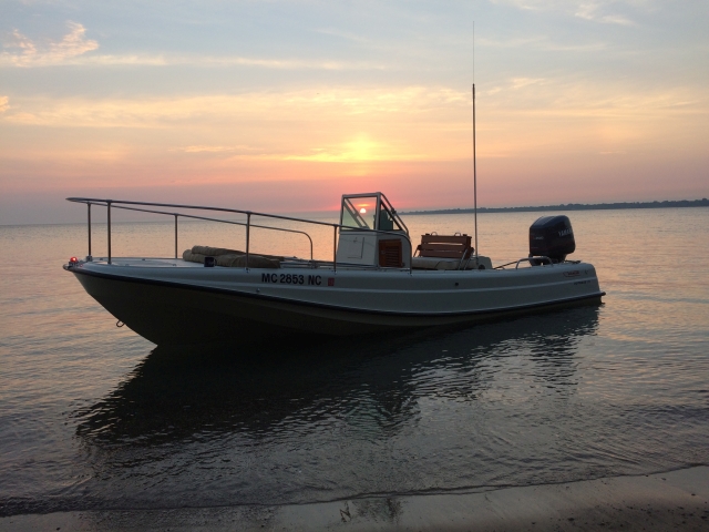

A 3-foot metal whip with base coil mounted on a tall extension mast makes a great antenna for a small boat. Photo credit Don McIntyre
IMG_2876 640x480.jpg (206.72 KiB) Viewed 37783 times

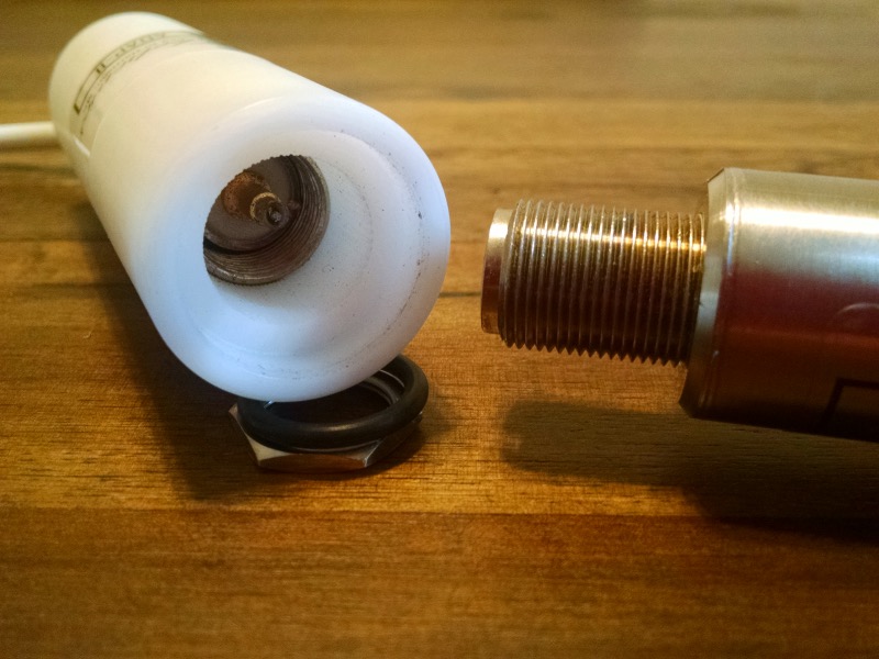

I received most of what I need today. The ADAP-II is different than what you show. The biggest concern with it is that the antenna will only thread into it about two turns because the receiving threads are way down in. The ADAP-II will need to be shortened so it can fully thread in. [There is actually no problem; see further explanation below--jimh]

I looked at the fitting of the GAM SS-2 antenna into the GAM ADAP-2 mount again. The internal diameter of the ADAP-II is 1.000 inches and the outside diameter of the SS-2 is 1.003 inches. I was just not twisting the antenna hard enough when trying to thread it fully into the mount. After going back and forth a few times, the SS-2 is seated down in the ADAP. This is all probably intentional to give a good fit, and I was just trying to be too careful.

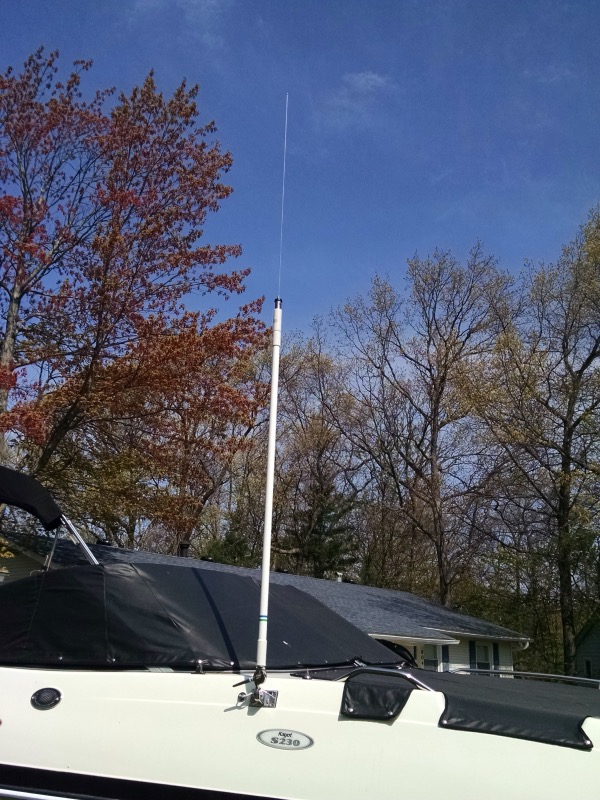

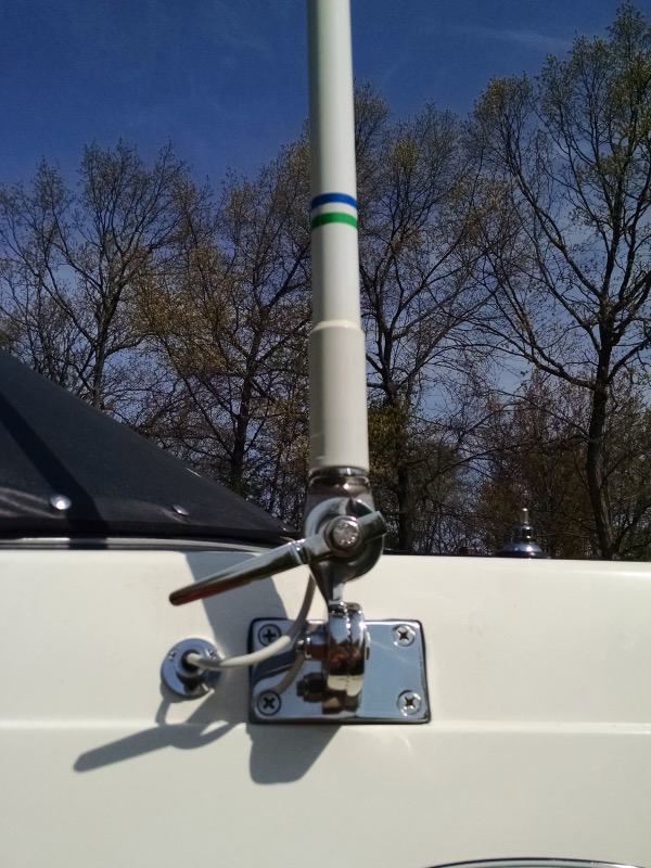

Ok, all done. I finished last night about 11:00 p.m., and, not surprisingly, nothing came across the radio. I went to bed wondering if I did something wrong despite knowing that there would be little radio traffic at that time, especially this time of year. This morning I turned the radio on and started cleaning the boat and heard the Elk Rapids harbor master hail a boat. I was in my front yard about 15 miles away, so that's one good indication.

You installation looks good. Thanks for sharing the nice images of your work.
